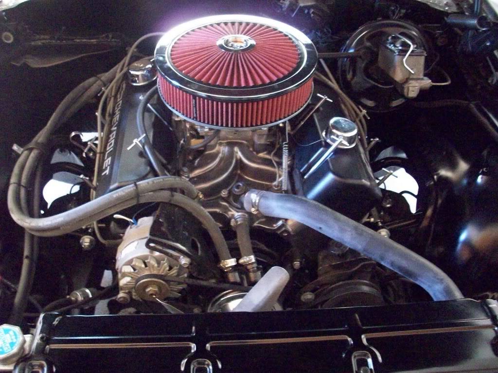

      The car isn't completely pro-touring but it is on its way, I figured it is still worth posting an update.
      It's been a long summer, the car has been away at the shop getting a complete suspension, transmission, and brake overhaul. I finally got the car home yesterday so I cleaned it all up and made it pretty for the big forum reveal.
      What's been done:
      TH 700 Transmission
      UMI Performance Tubular Upper and Lower front control arms (black)
      UMI Performance Upper and Lower Rear control arms (black)
      QA1 Coilovers
      Bilstein Shocks
      Front disc brake conversion with Baer Calipers
      New drums in back
      Newly built rear end with 4:11s
      New painted gas tank
      Shiftworks auto shift kit so I can manually upshift
      Boss 338 (black) wheels (18x8 in front & 18x9.5 in back)
      Nitto NT05 (245/45/18 in front & 275/40/18 in back)
      +a few other random upgrades

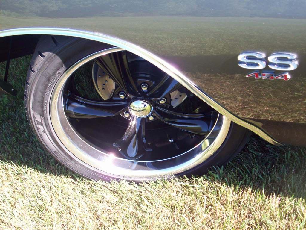

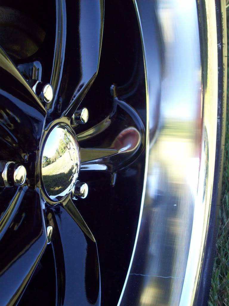

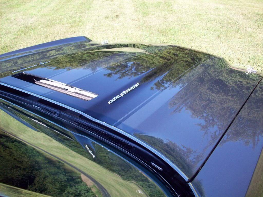

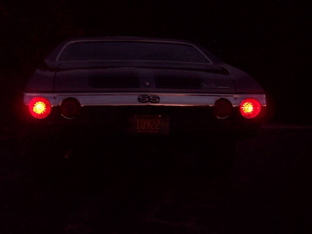

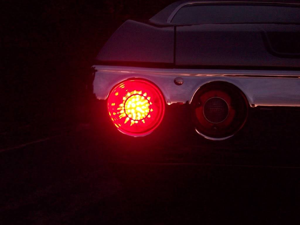

      Here are some more pics, some night photos to show off the led tail lights.

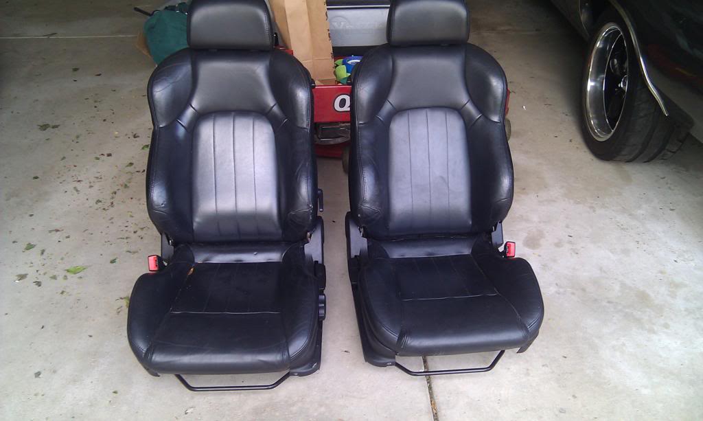

      Last summer I found some new seats for the Chevelle that are out of an 05 Tiburon. I whipped up some brackets and got em installed. Eventually they will be recovered with leather.

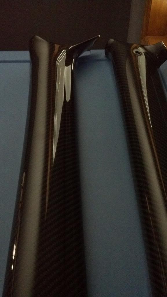

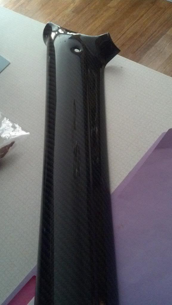

      I bought a set of ANVIL's A-Pillars and they look incredible, I have yet to install them but I'm enjoying them as eye candy on my project table in the mean time.

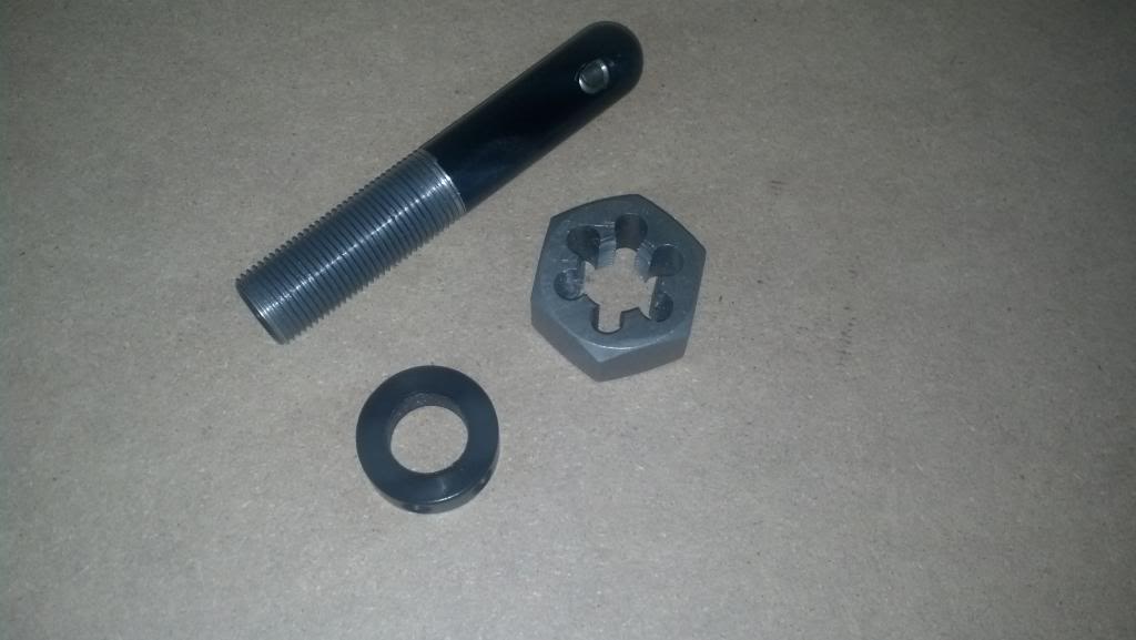

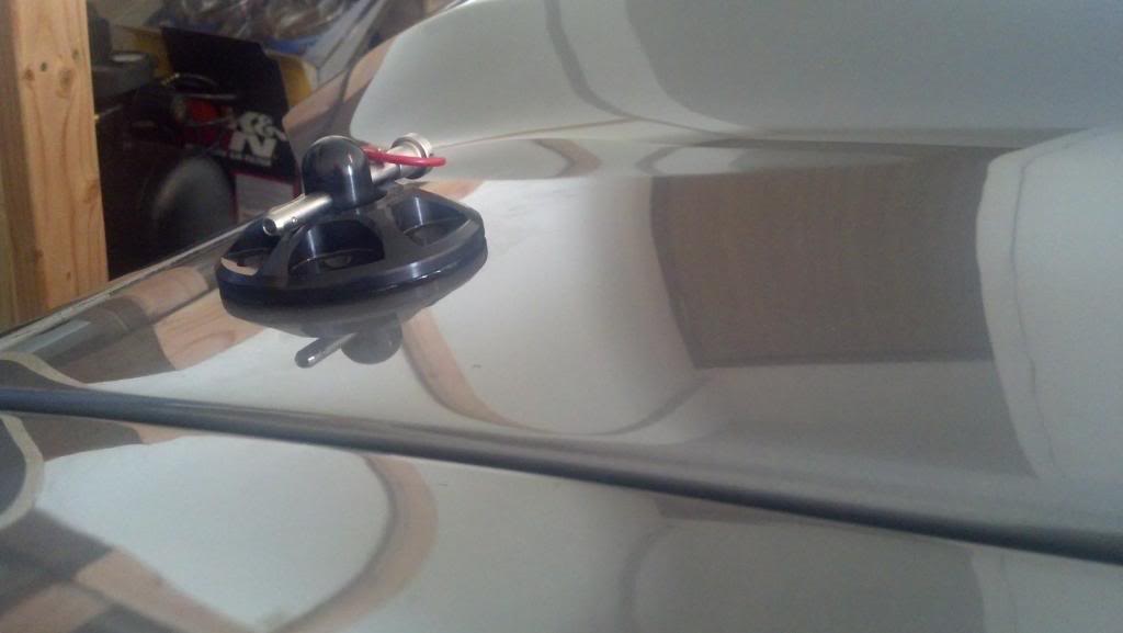

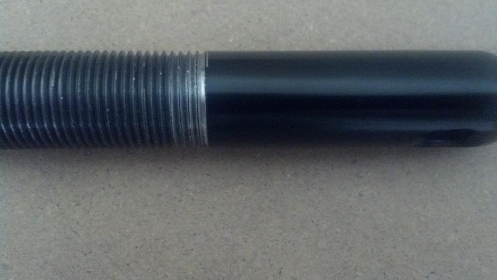

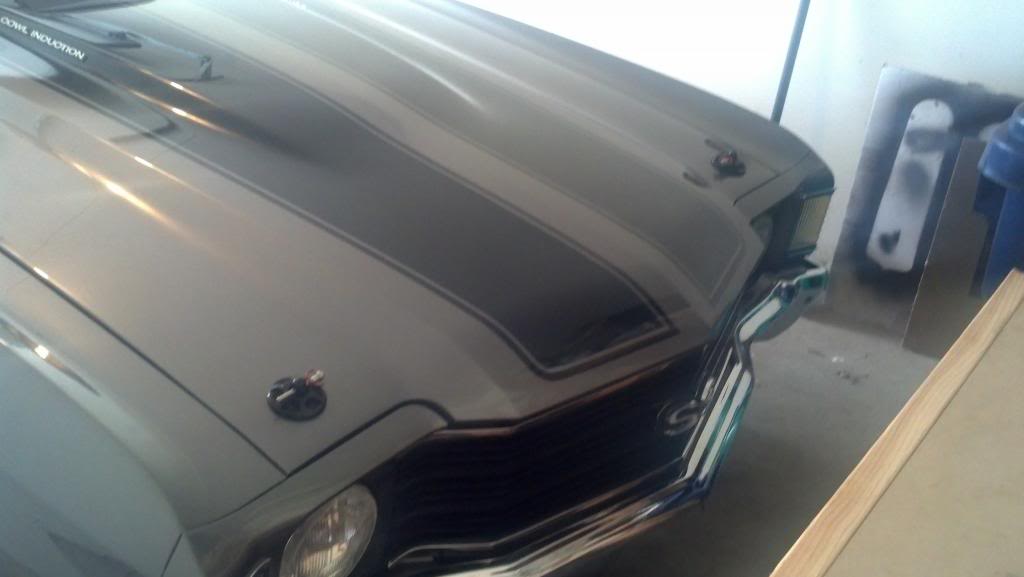

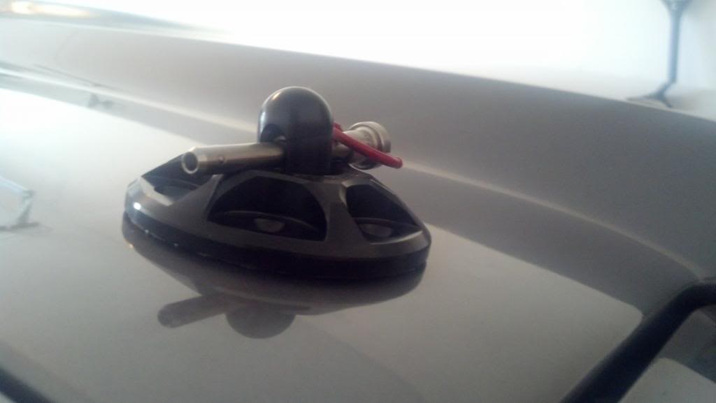

      Also got a set of Ringbros hood pins another excellent product. Unfortunately this one gave me a bit of a fit during the install, the pin was too tall and the thread wasn't deep enough on the pin to securely latch the hood. After a few re-threading dies I eventually got the correct one then bam fit like a glove.

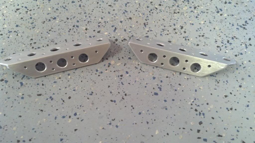

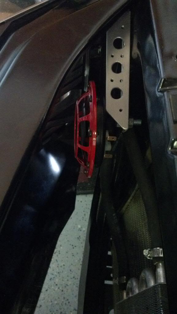

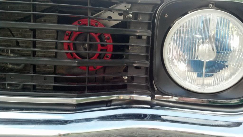

      I'm not sure what the reaction to this next update will be but I think it works on the car. I believe I may have the first Chevelle with Supertones. I made some brackets and thought it would be cool to mount them to look like second headlights like the 70 Chevelle.
      It was difficult to take pictures of them installed, they don't really do it justice but I think it looks good.

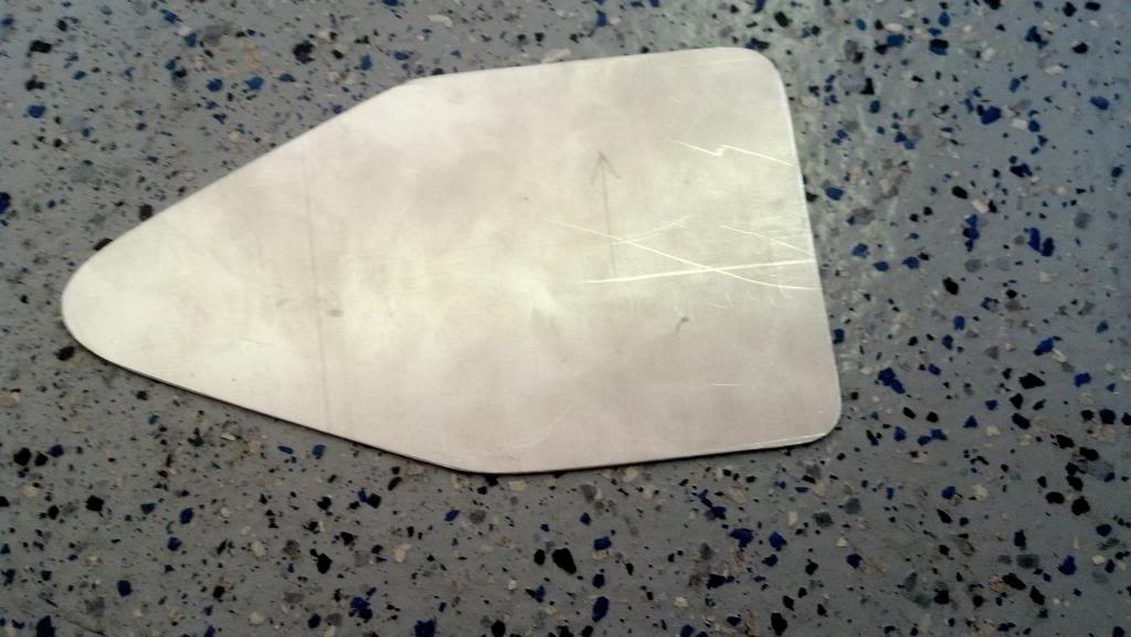

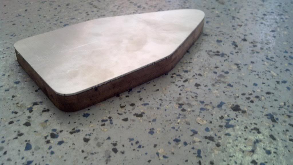

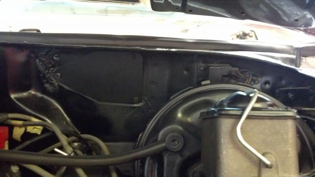

      Continuing....I ditched the windshield wiper motor because I don't even have wipers so I made a little closeout panel to cover the hole. I made an MDF template than just used a copy bit on my router to transfer it to aluminum. It's nothing real special but I'm slowly becoming more adventurous and trying new things.

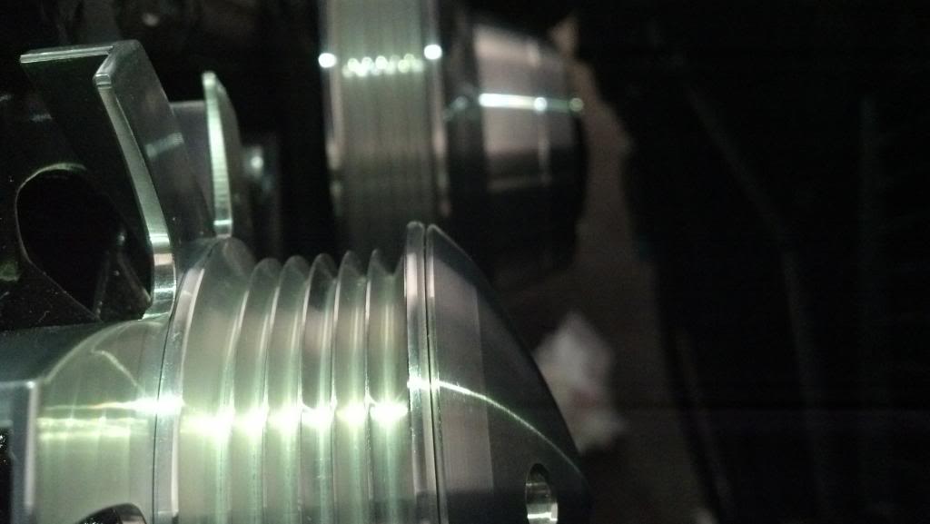

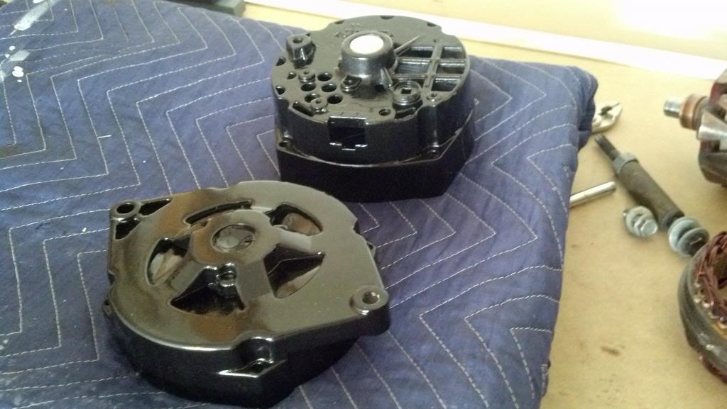

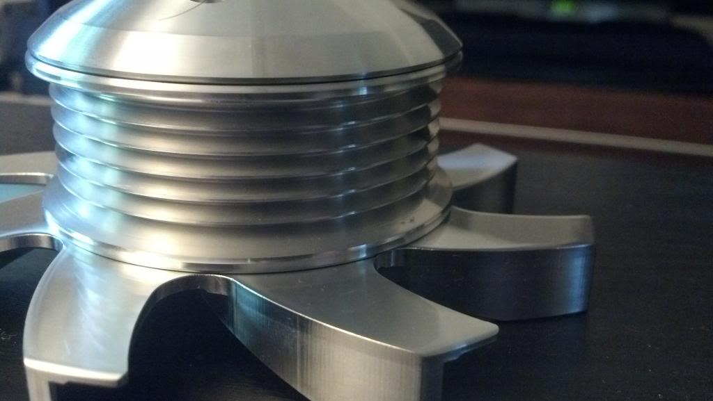

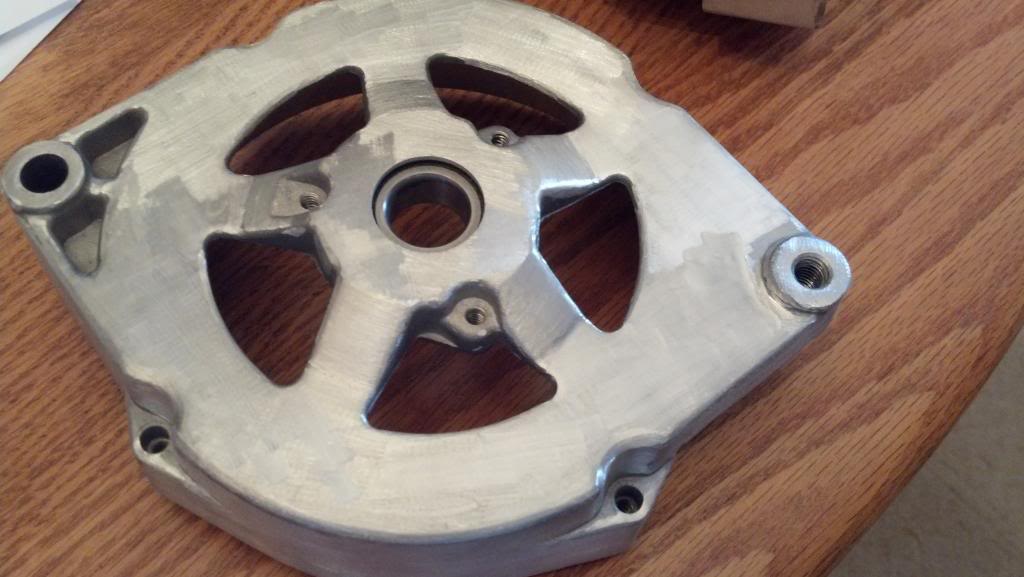

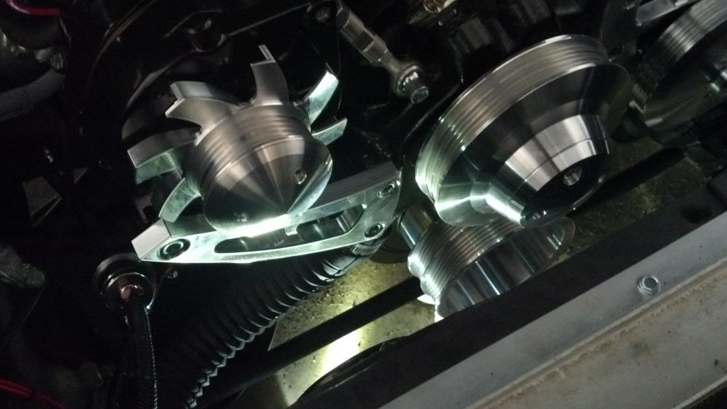

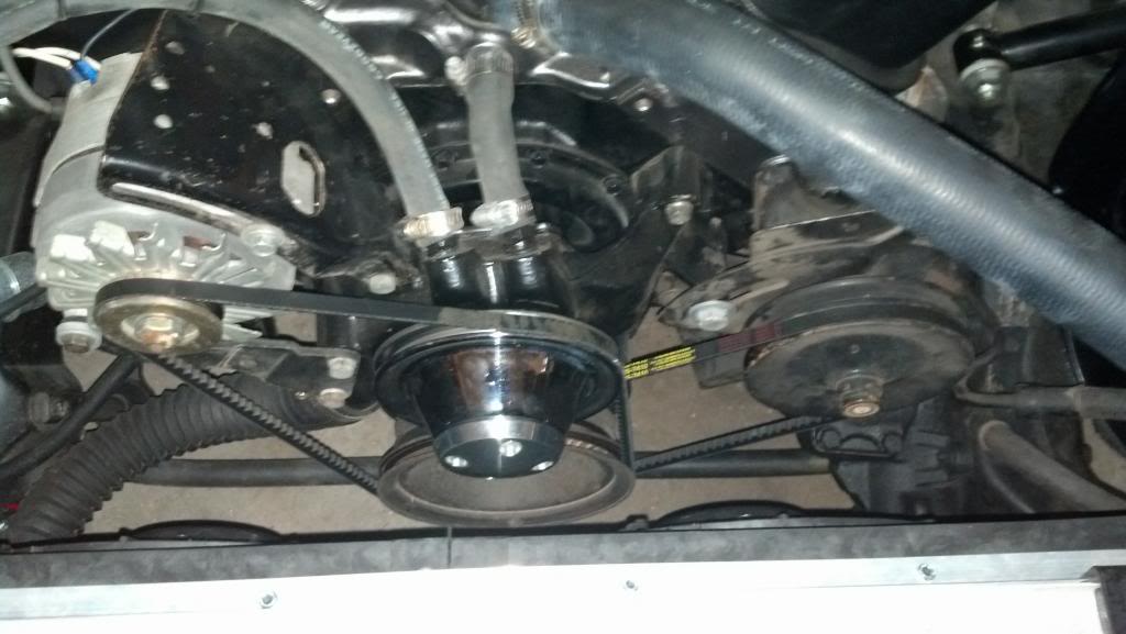

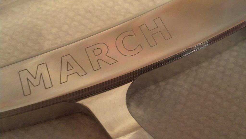

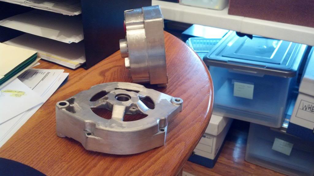

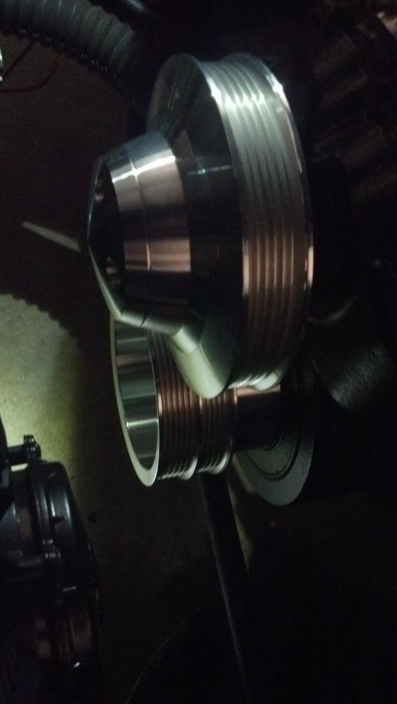

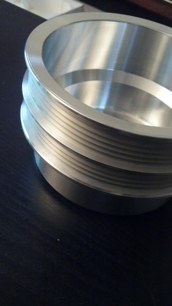

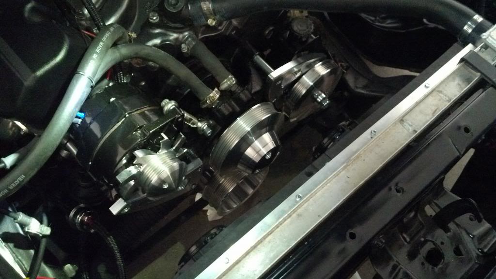

      I decided it was finally time for an engine bay overhaul. I bought a March serpentine kit from MCB and cleaned everything up before installing it. I started by smoothing and painting my alternator and power steering pump.
      Unattractive before pic
      Alternator smoothed
      Painted
      Some billet beauty shots
      Starting the install

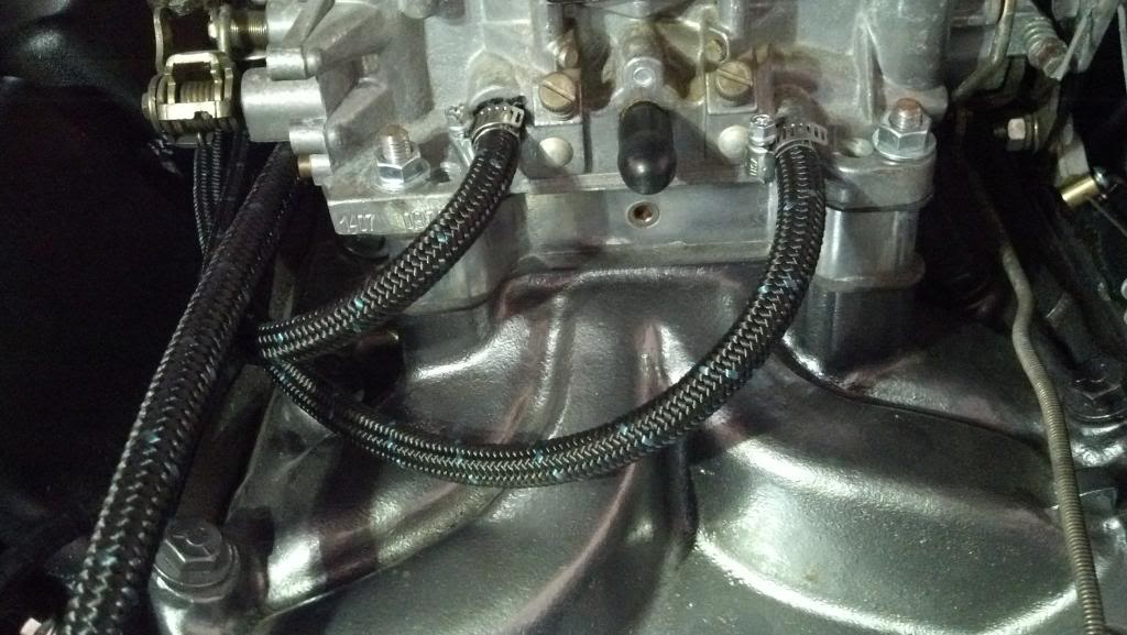

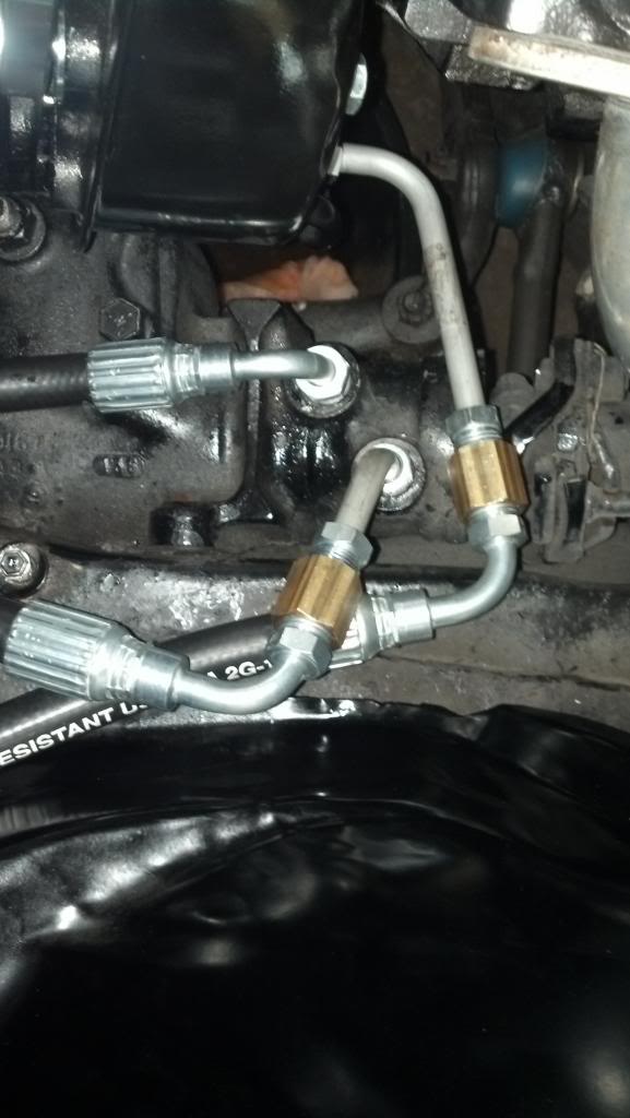

      I couldn't get myself to buy the $200 braided power steering pump hoses so I ended up searching all around town for parts and I have to say I was shocked at how unhelpful and disinterested my local auto parts stores were to help me out. So I took it upon myself and bought a few universal kits online and rigged them together to get a functioning power steering pump. It's not the prettiest set up but it works for now.

      I also began swapping out all the nasty rubber hoses for Russel's nice nylon braided stuff. I'll have to get some more pics because for some reason I stopped taking pictures.

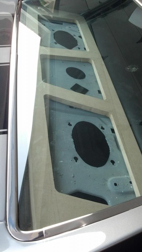

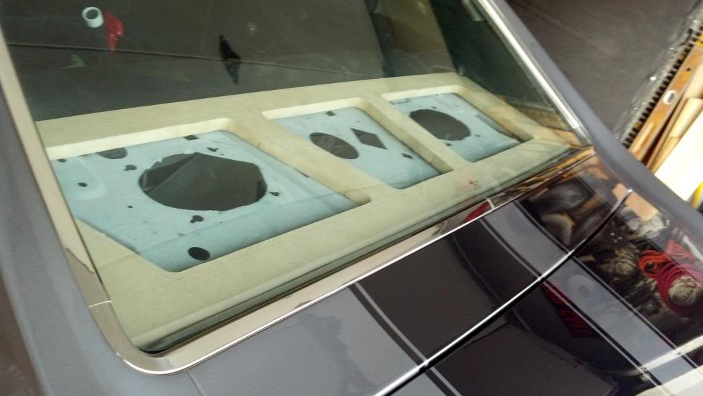

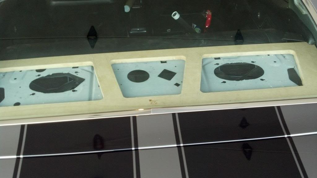

      Finally, I began working on my rear package tray as the first step in my interior garage makeover. I have a lot of sanding left to do but the plan is to cover it in some form of leather and have an aluminum trimmed perforated metal insert in the tree openings.
      I ordered the metal, should be here this week and am currently searching for leather or some kind of synthetic leather. If anyone has a product they have used and would recommend I would love to hear about it. I will be covering the package tray and door panels in the material I end up with.

      Looking good!! I have a similar plan for my rear package tray. I'm interested in seeing how the trim works out. How do you plan to make the corners?
      89 Mustang "Box Wine"
      Apr 2011
      61
      Thanks, what exactly do you mean by the corners. I just used a large drill bit and a jig saw for the MDF cut outs and will use a cut off wheel and a belt sander to make the corners on the aluminum.
      McKinney, TX
      1,623
      Quote Originally Posted by crazycarguy22 View Post
      Ok, sorry. Are you going to weld the aluminum sticks together or make it out of one large sheet? I guess I'll have to wait and see how you'll be doing it.
      Apr 2011
      61
      Oh I got ya, I am making it out of one piece. After thinking about it for some time I think I will make an MDF template with double sided tape to attach it to the aluminum and cut the trim pieces out with a router and copy bit. Unfortunately, I don't have a welder of any kind or any welding skills but eventually I would like to acquire both.

      Paint the horns black.
