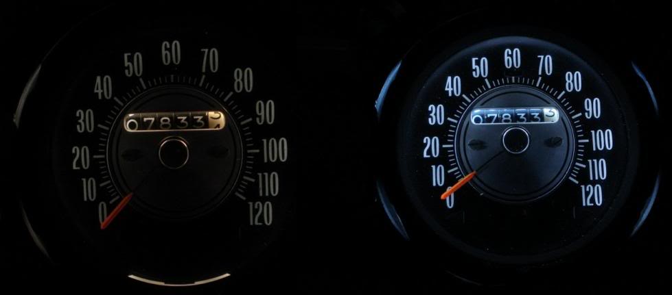

      I have a few for a few applications with perimeter lighting.
      First one up is my 1970 442's gauges, after restoration of the gauges insides with fresh paint for maximum reflection.
      Left is incandescents, and right is 194 5 SMD LED's.

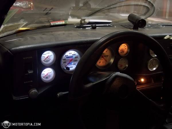

      2nd one is another member of Nastyz28 who took his new Autometer Phantoms and stuck
      5 SMD LED 194 wedges in half his gauges to show the difference.
