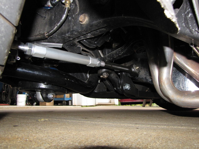

      I have been working on the car and keeping it driveable at the same time, which is very hard. The first major thing i did was remove the stock control arms and drop spindles and coils and install DSE control arms with ATS Chicane Kit, DSE double adjustable coilovers(1st stock sub frame to have these), stock spindles with C5 brakes.

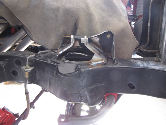

      Removed the rear suspension out of the car and install a Air Bar with DSE double adjustable coilovers. The air bar fit great and was install was super easy. I also put on a set of LS1 brakes that i had laying around the shop.

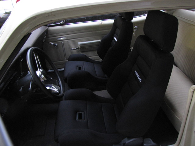

      Removed the bench seat for a set of corbeau seats. Ended up cutting the seat brackets down cause then were to tall.

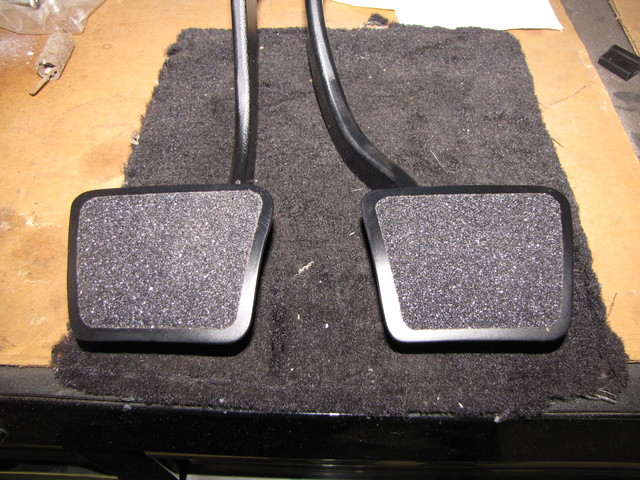

      After taking the car to Run to Music City and running the car with a turbo 350 set up for drag racing, i had to do something about that. Pulled the T56 off the shelf, ordered a quicktime bellhousing, Spec alum flywheel and Spec 3plus clutch. Before i installed the pedels i did a little mod to them that i seen Tommycomfort do to his. Took a peice of 1/8" plate and made it 1/4" wider on all sides and bend it to fit the pedels, and put a peice of non slip tape on them.

      Stock on the left
      All painted the taped

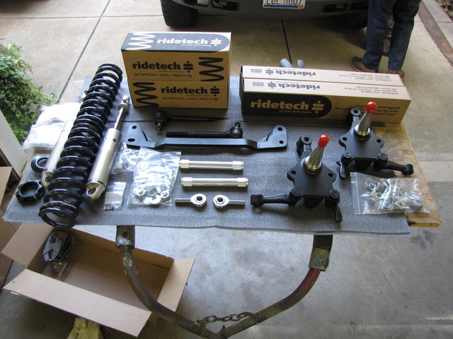

      Friday UPS dropped off 3 boxs from ride tech, New tru turn set up, and new coil overs.

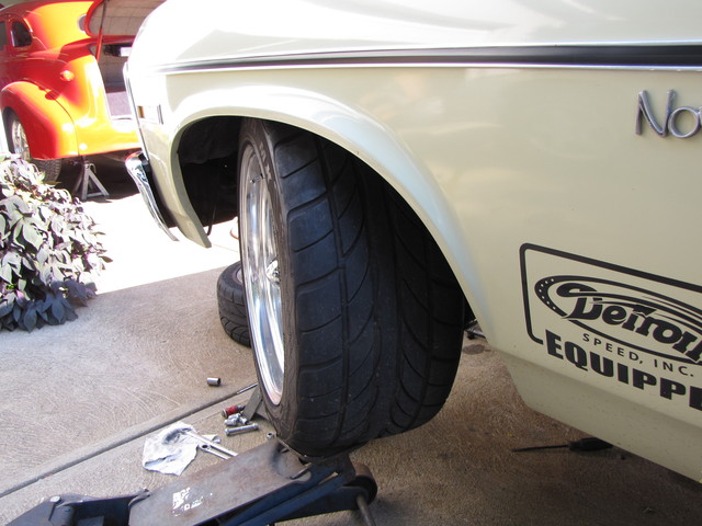

      Up front is 225's and out back 275's Those will change this winter going with 275 up front and 275 or 295 out back.

      question 275s fit up front? what do i have to do to get them to fit.... was planning on running 245 45s thanks in advance for any anwsers

      cool car interested to see how your going to run 275's also?

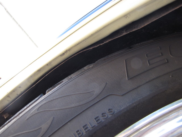

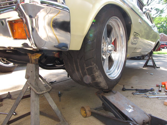

      Well, Bret and Tony at ridetech know how to take care of someone willing to push there car hard. While i was at the NSRA Nats, I got to meet Tony and after we weighed the car
      (3378 lbs), We got talking about the Tru Turn set up and next thing i know we start writing up a order for the tru trun, complete front and rear single adjustable coilovers.
      Everything is made very nice and went on the car super easy, Other then i had to mod the lower control arms, now remember i have DSE arms that i modded to run the DSE double adjustable coilovers, All i had to do was trim the bolt sleeve down, about 15min for both sides.
      Yes thats a 275 on the front of a nova.
      And if you want to see a overall pic of the car, you need to show up at the Midwest Musclecar Challenge or wait intill the event pics are up.
