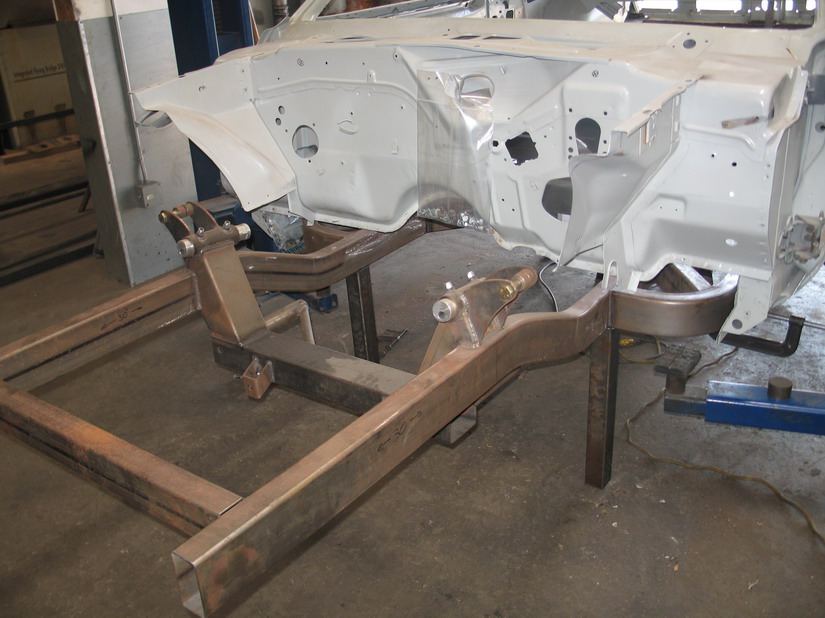

      Chassis

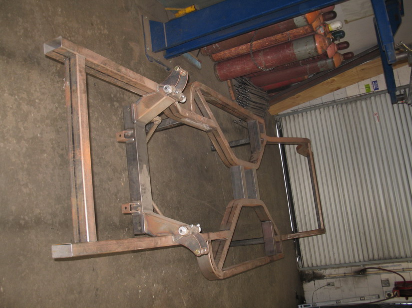

      Chassis Tabs to help with body alignment

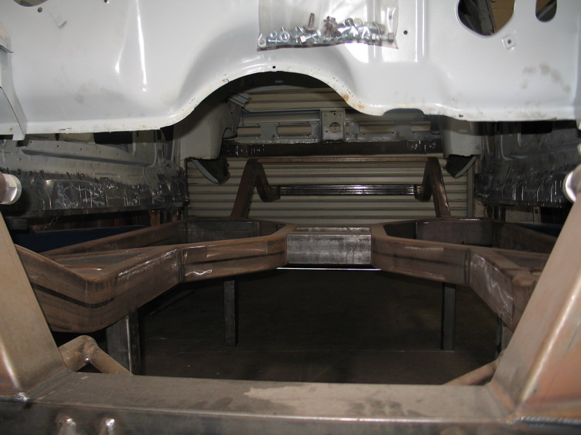

      Lowering Body

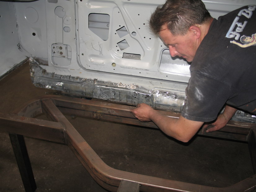

      From Firewall View

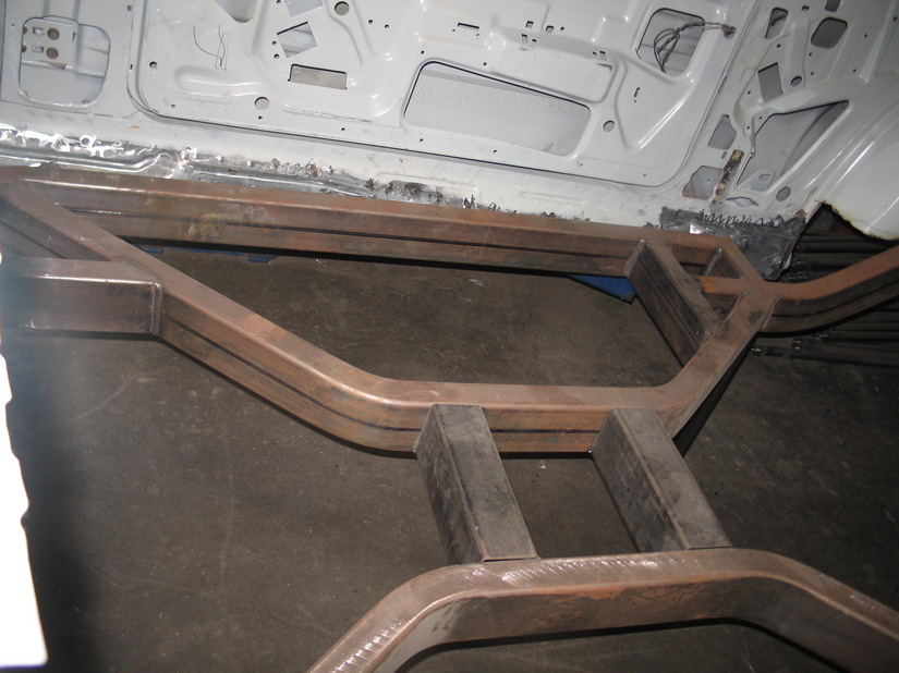

      Inside Rocker fitting over

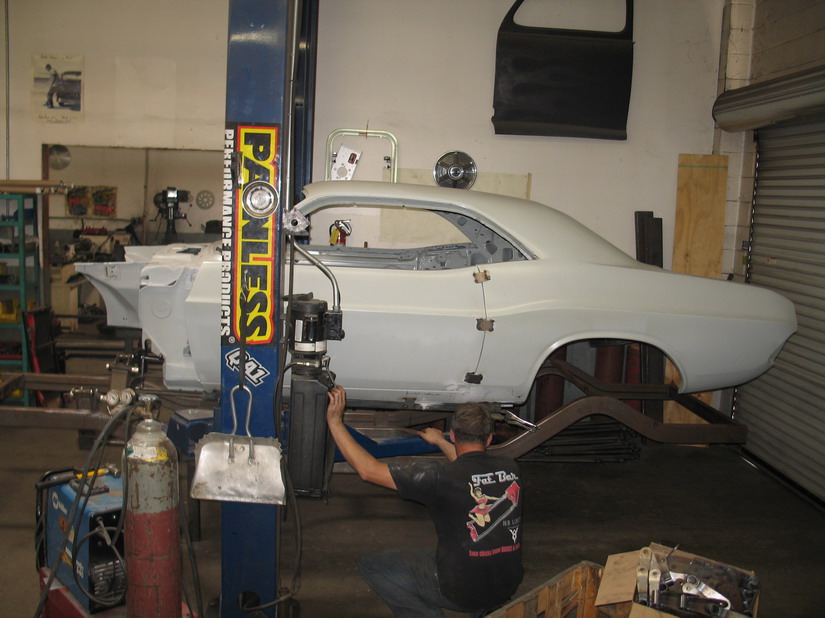

      Body and Rockers over frame

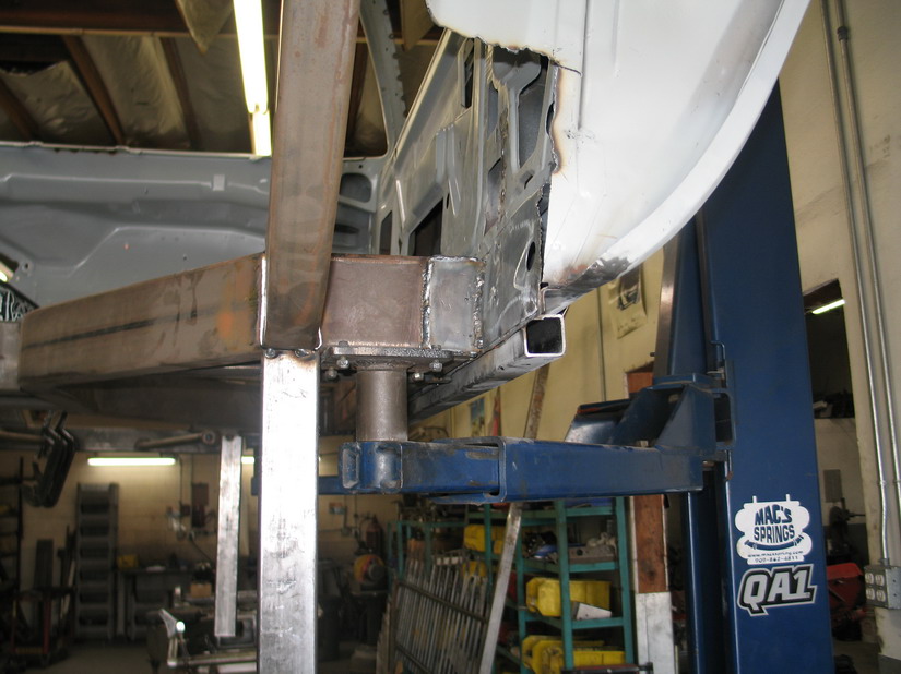

      Rear Rocker Mounting Plate-Rocker Brace

      Front Rocker Mounting Plates
