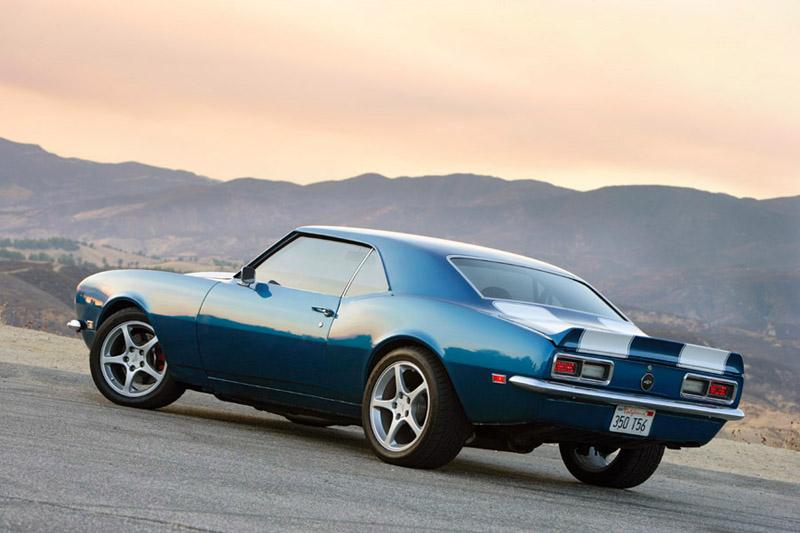

      They will clear your brakes but require huge spacers because of the disparity in offsets. Some people love them because they're modern and some people hate them because they make cars look front wheel drive. It's your car so it's your call but it isn't a straight bolt on and spacers that size are a bit of a band-aid.

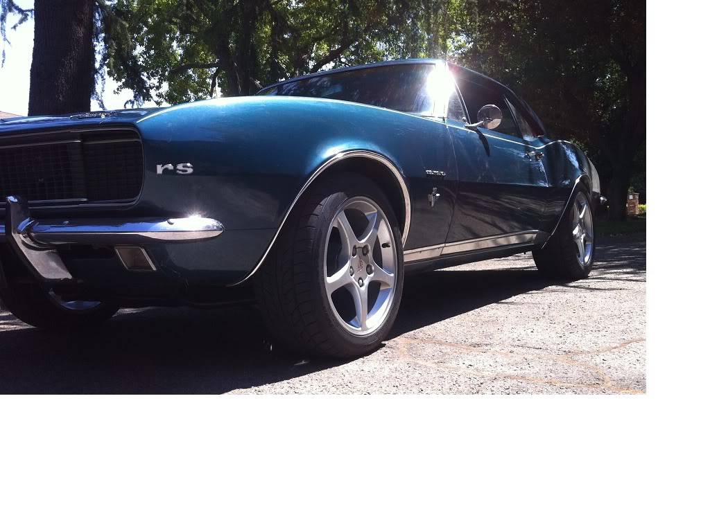

      Go for the vette wheels and don't look back. I run z06 wheels on my chevelle with spacers and they work great. You can also find replica wheels cheap and aftermarket wheels for BMWs fairly cheap. Check out Tsw wheels.

      what size spacers are u using and how much are they car looks good
      2
      Quote Originally Posted by blown67 View Post
      I am using 2" adapters in front and no rubbing with 235-45-17's. I need 2 5/16" in the rear with 275-40-18's and I can get a little rub on the driver's side over a bump if the suspension is loaded. I have DSE shock plates and I also need the space for the wheels to clear those plates. I still have drums on the back so the spacing may be different if you have a disk brake setup. I bought the cheapest billet adapters i could find knowing that they would be of limited use while I worked out the spacing as I got the car lower. I have an assortment of spacers from the local parts stores that used to get to the magic 2 5/16" for my fitment. My rear end doesn't sit perfectly centered so the passenger side has a bit more clearance than the driver's side.
