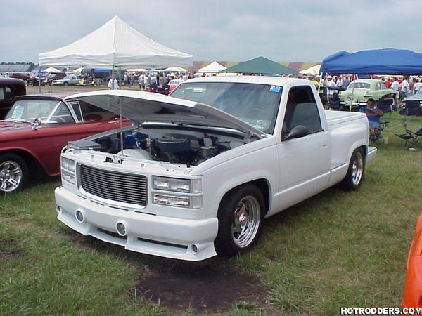

      Rebuilding the suspensions with poly bushings, adding a 4/6 drop with spindles and a flip kit and slapping on a rear stabilizer bar will get you a very tight and good handling truck. You can spend as little as 500 bucks to do the job and impress all of your friends by knocking their head against the pass side window doing a lane change...
      This is my '95 Sierra set up exactly as above.
