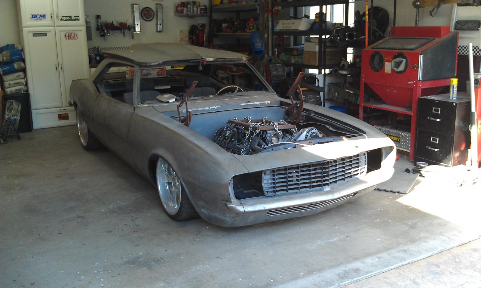

      It is a 67 Camaro, I did a few body mods as you can see I tried not to make them so noticable. The front and rear bumpers are off a 69 Camaro, so are the tail lights and the front grille. I also ditched the vent windows and replaced them with 69 glass and internals. Shaved everything off and changed the hood cowl a bit.
      brphotrods.com, I bought the kit through summit racing since I have an account there. Im not sure what it would take to locate the flywheel where you want it but this kit puts the engine forward a bit and leaves me with about 8" clear from the WP pulley to the core support. If you are using a 700R4 or 350 tranny there is a spacer for the flywheel you can use and will require longer bolts if thats what youre looking for....

      Thanx, the grille was kinda tricky, the 69 Camaro body is about 2" wider overall at the nose so I had to section the grille and bond it back together. I will have to get a custom billet grille made to fit it but that will come later. I finally got the engine to fit so now im feeling more confident on getting back to finishing my body work and begin my custom dash and center console. Will post more pics as soon as I figure out how to change the pixel settings on my images??? I used a different camera.

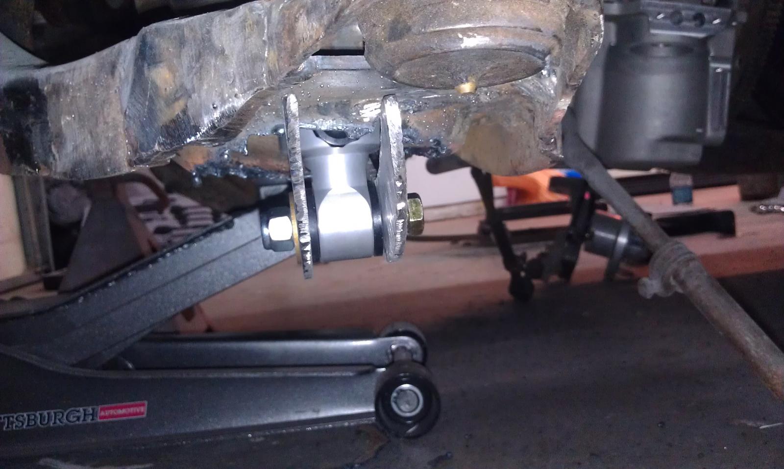

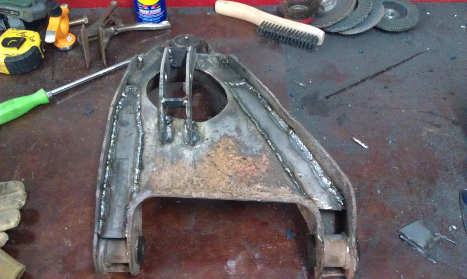

Size:  172.9 KBWell, I got rid of the front air bags and installed a set of shockwaves, the air bag did not allow me to install shocks in the front. Frenching-in shocks into the frame was an option but not for me. I had to modify my lower control arms shock mounting points so that I would be able to lower the car as much as possible. Front control arms have so much work into them, I could of just bought tubular control arms but since I had about 1 1/2" sectioned out of them, top and bottom I realized tubing would be harder to reinforce. finally I got it done, I did not fee comfortable driving on just air bags.

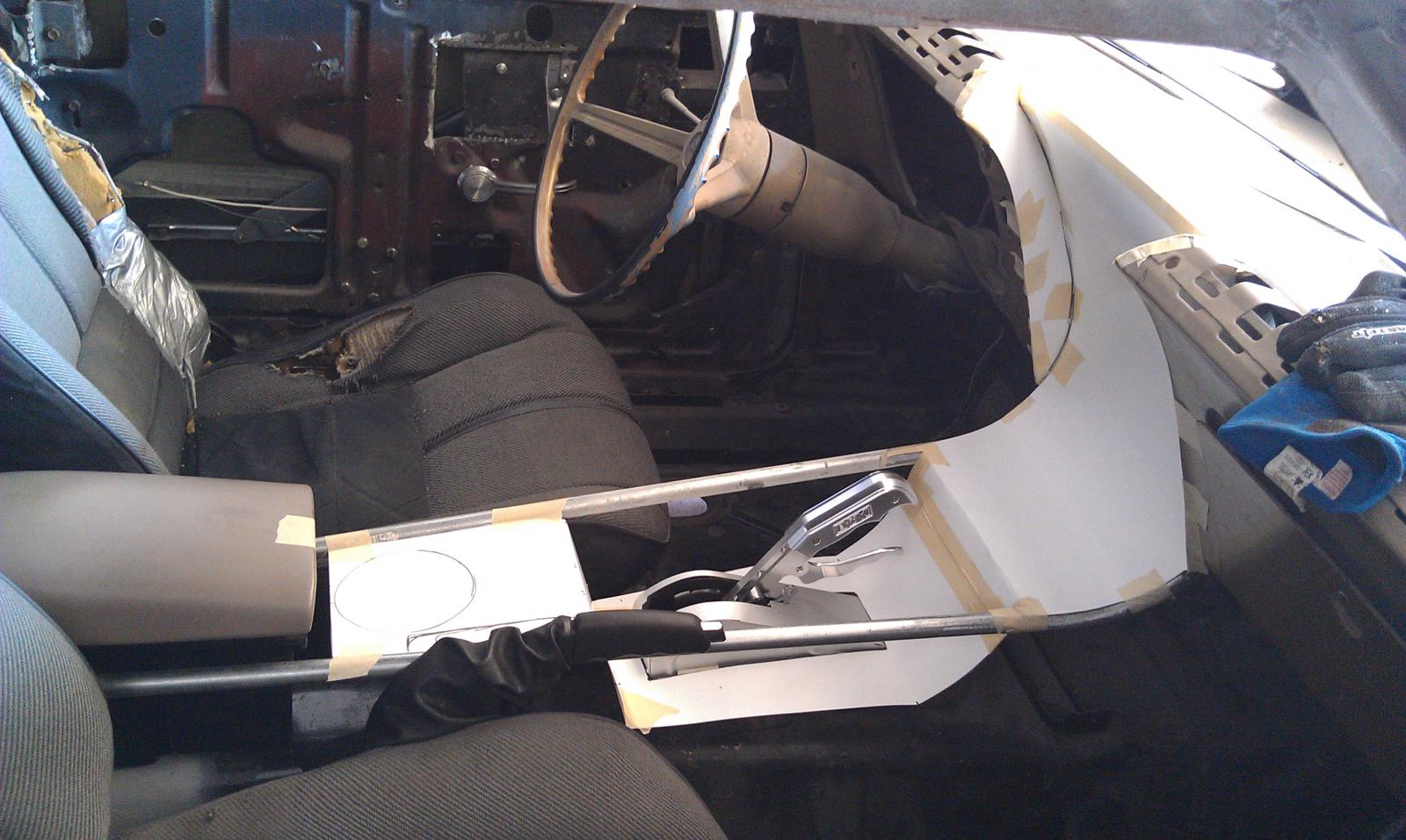

      I also started working on my center console and interior mods since im changing the outside im also changing the inside. will post more pics as I continue progress.
