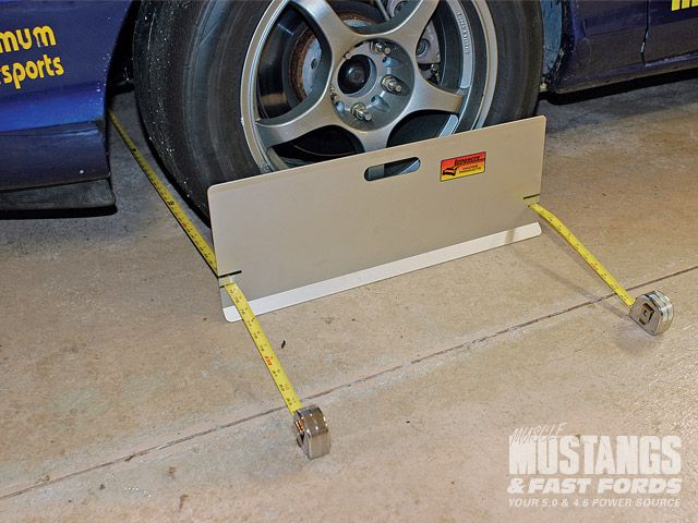

      frojoe: We use this fancy measuring device to check bumpsteer (basically a "home made" version of the commercially available units out there):
      When the tires are on the car and the car is on the ground you can check toe with these simple plates (a lot of racing companies sell these):
      68camotion: If you want to fit a 10" wide wheel on the front of a first gen you only have a couple of choices 1-TruTurn; 2-new subframe. Since a new sub is many times the cost of the TruTurn it makes it much easier to justify.
