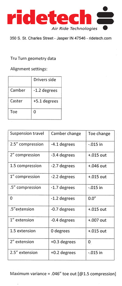

      I have finally gotten a chance to gather the camber curve and bumpsteer data for your guys who are interested in such stuff. You'll notice that the camber curve is fairly radical, but appropriate for this size wheel/tire combination.
      You'll also notice that the bumpsteer numbers are just stellar! As indicated at the bottom of the graph, the total variance through 5" of suspension travel is under .050"...about the thickness of a dime. Put in context...many [most] newer cars have .150" to over 1" of bumpsteer variation. Indycar guys shoot for under .020".
