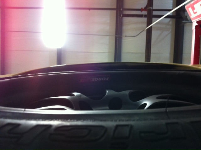

      I can only speak for the earlier cars (67,68) as the 48 hour car is a 67, but the fenders were worked over to make the wheels/tires clear everything at the dramatically low stance we wanted. The 69 should not be nearly as modified as it has more clearance to begin with. However, I cannot say how much as we have not yet fitted a 69.
      As you can see by the following pictures the part of the fender with that held the stock trim was removed. The remaining lip was then rolled under and a new panel was attached to this. This new panel allowed a slightly modified stock inner fender panel to bolt to the fender, thereby filling all the gaps.
      I'm sure more information will be available on more "stock" vehicles later, however, there's not much out there currently as this is a VERY new product. The 48 Hour car was built to be beaten so we did everything we could to fit the largest wheel/tire on a stock subframe and keep everything clear and out of the way when you dump it into a corner at over 100mph at one of the large tracks!
      Here's a shot from under the car (the car is on a lift):
