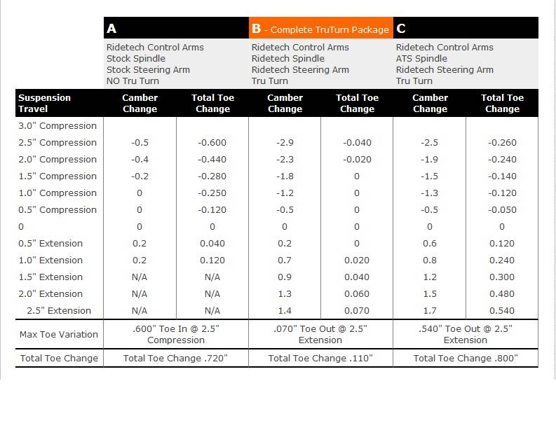

      Is it possible that the toe change numbers are flipped in this chart for column C?
      True T.
      My blog
    2. #242
      Indiana
      1,371
      No, that looks about right. Column C is intended to show that even a collection of fine components, if not specifically engineered to work together, MAY not yeild the results you intended. There is nothing wrong with that ATS spindle, its a finely engineered component. BUT we did not build the Tru Turn system around the ATS spindle, we built it around our ridetech spindle. Thats why we include a lot of this type of detailed explanation on the website below that chart. http://www.ridetech.com/store/tru-turn/

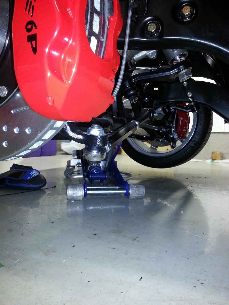

      I just wanted to share with every one what I dreamed up. This allows me to run 5.5 - 6 inch back space, you can use any spindle and it cost me $30 bucks a side. I have it on my 67 and 69. I have been running it on my 67 camaro for 8 years now, no issues, no bump steer.
      It allows the tie rod to tuck inside the rim. Name:  2015-03-18 21.41.27.jpg

      Well that's an interesting solution. Any opinions from others on this?
