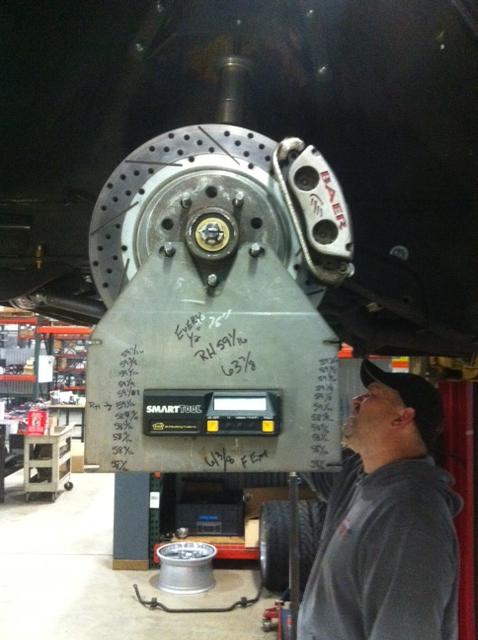

      Quote Originally Posted by marolf101x View Post
      frojoe: We use this fancy measuring device to check bumpsteer (basically a "home made" version of the commercially available units out there):
      Attachment 54219
      Thanks for that info Britt..
      Couple more questions.. what is the width of that plate (looks to be maybe 14" wide)? Just trying to get a grasp for the distance of the bumpsteer measurement to the spindle's balljoint axis.. Also, is the 0.0XX" bumpsteer measurement between both sides (overall change in toe) or only for 1 side (measured from some central plane in the middle of the car)?
      Thanks again!
      joe
