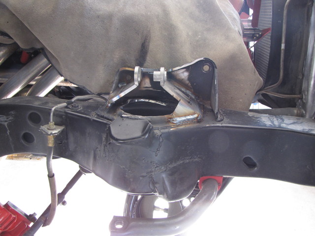

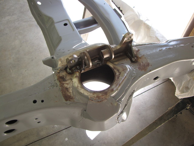

      Bret you are talking about the ATS upper mount, i have that on my nova. The DSE upper mount set up, you cut the factory upper a arm mount off and install a new upper control arm mount. The new DSE mount holes are dropped about 5/8 or 3/4". so with the upper control arm mount dropped and tall spindle wont you have a bunch of neg camber gain?
      ATS upper mount
      DSE upper mount
      As for DSE control arms. i have DSE control arms,ATS upper coilover mount with the tru turn, but i had DSE coilovers(double adjustable, and to fit them i had to modify them) and switched to ridetech coilovers(and when i went to ridetech's i had to make new spacers)
      If you dont have control arms and your looking at the tru turn, just buy the Ridetech arms, then everything is made to work together. I had the arms and made them work.
