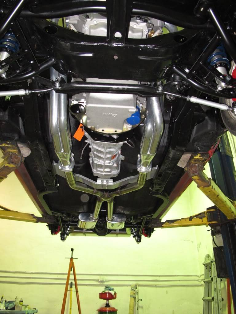

      I have TT with Dynatech headers on a TSP LS3 and a T56. We had to put spacers under the frame motor mounts but the headers cleared the TT. I used S&P conversion plates with energy suspension mounts. I had ATS plates but S&P plates raised the motor up more. I am running 18x9.5 wheels with 265s. I will post pics once the wheels are mounted.
