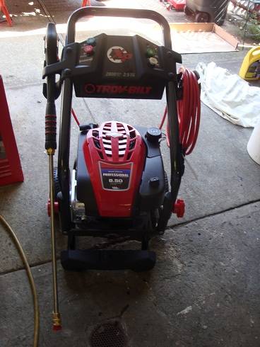

      Best $300 I ever spent. I love clean parts to work with.
