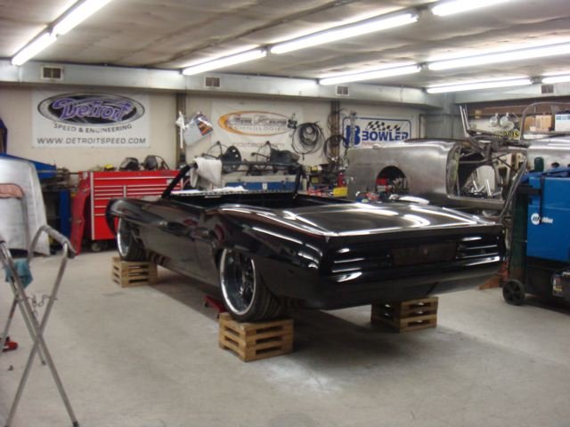

      I'm not too fond of jackstands.
      I was thinking of using this method. Thoughts?

      I'm spoiled, I use a lift. But I don't see anything around with the pic you have other than how are you going to get it down. You would have to raise the car really high to get it off the blocks since the suspension would have to drop down.

      I use the lincoln log method, and just to be extra safe I have a tie-down strap (10,000lb rated) that I loop around one of my back tires and around the bottom of the stand...there is no way that car is coming off of the stands.
      The great thing about the wooden stands (lincoln logs) is that you can add to them if you want to stand higher, and total cost to make them is about $10.00!

      Robert, If I'm able to jack up the car high enough to slide those under, I'll be able to lift it high enough to slide them out.

      When I built my stackable wheel cradles I also built stackable platform sections for the jacks. I can raise a car up 2 full feet with my current setup (double what you see below). Cost was nothing for the wood, I disassembled shipping skids for the 2 X 4's. I made the wheel cradles long enough to allow the car to roll a little to compensate for the movement necessary because the jacks don't lift straight up. This prevents tipping of the cradles while raising the car. There are 4 "top sections" of the wheel cradles with a flat surface while the rest of the sections are the typical 2 x 4 blocks. Same deal with the jack support sections, top section has a flat surface and the lower ones are just 2 X's. Jack platforms are nice for trucks and other tall vehicles rather than stacking blocks on the jack pad.
      EDIT: I realized after posting that the truck pic below shows no supports. I was not going to work under the truck, just needed the front wheels off the ground so I could rotate them by hand to bleed the power steering. DO NOT WORK UNDER A VEHICLE THAT IS ONLY SUPPORTED BY A JACK!

      Very nice. I see you made yours stackable. I'm not sure how I feel about that. I really don't want to do a base for the jack.
      In my pic in the OP, I counted 7 2x4's high so that's only 10.5" high, which doesn't seem like much, but looks like enough from that picture. And you have 8 with gives 12". I don't think I'll need a jack base if I lift under the rear diff to keep the suspension loaded, block the rear wheels, then use a jack for the front center and use a 2nd jack under each a-arm to do the front wheels one at a time.
