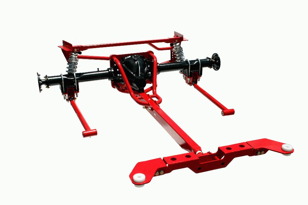

      -The only leaf spring conversion that is a 100% bolt-in design with no welding or fabrication required
      -Billet Watts link locating device comes standard
      -Multiple rear end fitments available (10 bolt, 12 bolt, Ford 9")
      -Adjustable pinion angle, ride height, anti-squat, and roll center

      Quote Originally Posted by BMR Tech View Post
      If I ever do another F-body, this is what I want to go with. Sweet setup.
