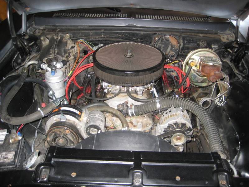

      Hi guys, is some one knows a direct swap for this bulky, yet heavy (kinda ugly) MC, I was looking into the aluminum body with plastic reservoir (GM type).
      Let me know!

      I took a recommendation from Paul at Hydratech Braking Systems and used a C6 Corvette looking MC that that works perfectly in my Buick Turbo T. It had the same brake line sizes / thread pitches / port locations. It was from a 2000 Australian S10, Raybestos MC390572 ($99.95).

      You could use the 81 Camaro one, but it might require a booster change (opening in the booster needs to be larger to fit the master cylinder). Both disc/drum and disc/disc (Firebird) versions are available.
