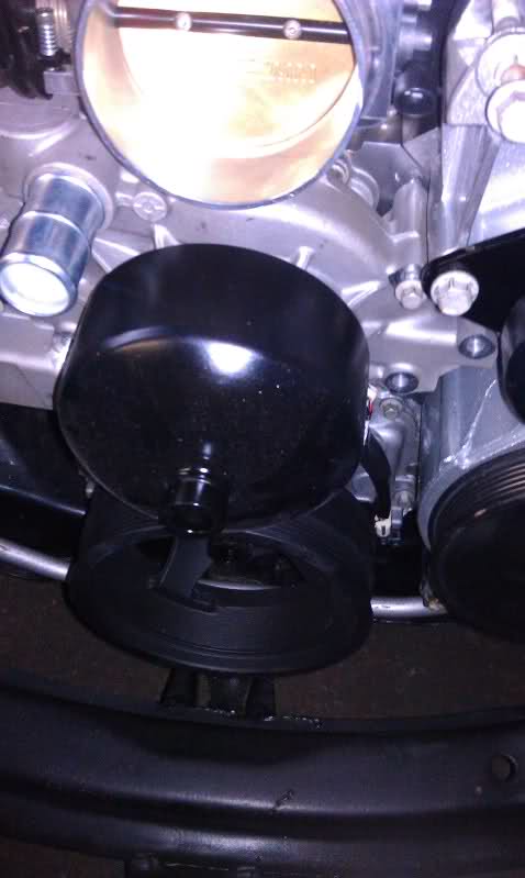

      Finally got the alternator today, tried installing it and found a few new interference problems.. Fuel crossover had to be moved to the back of the intake, there was an extra evap? vacuum connection on the drivers side behind the throttle body that had to get cut and capped, otherwise everything went fine. Measured for the belt size, and we're in business!
      also mounted my catch can, routed hoses, and cappped off extra ports on the intake
      Probobly worth noting that LS1 camaro ignition coils/brackets I had did not clear the break booster. I also had a set of 2004 truck coils/brackets and those cleared just fine, mosly because looks like truck coils/brackets are mounted higher on the valve cover then camaro coils.
