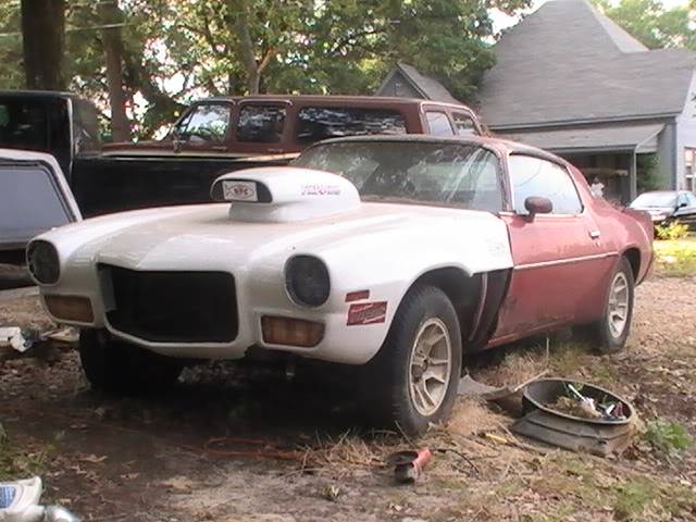

      Just wanted to introduce myself. I'm David and I've just started working on my 1981 Z28 Camaro again. I've had it for 15 years (since I was 18), but it's pretty much just sat for the last eight years or so. The end goal is to someday run the Silver State Classic in the 150mph class. Obviously, as a pretty much bone stock car, I need to get to work. Here's a horrible picture, but it's all I have on this computer.
      I'm here to learn about suspension systems and what does and doesn't work on these cars. I peeked in on the suspension forum and boy, I have a LOT to learn. But I'll get there... Thanks for the great site and I look forward to finding answers to my many questions.
      And no, the cheezy screwed-on L88 scoop isn't staying. Amazing, but it looked cool to me 15 years ago.

      So... plans for the car. The front sheetmetal is already gone and I'm in the process of mocking up the one-piece '70SS fiberglass front end. I got a great deal on it; right now it has a snorkel scoop on it that I may or may not keep.
      The big decision is gonna be suspension setup. Do I try to work with the stock subframe and replace the control arms, or go with a custom setup with C4 or C5 stuff? Complete front and rear suspension clips from a c4 corvette are as little as $1200 for both, and look pretty straightforward regarding the install. I can't afford the DSE stuff, so I have to work with what I can afford. Suggestions are welcome.
