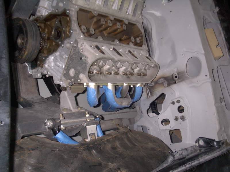

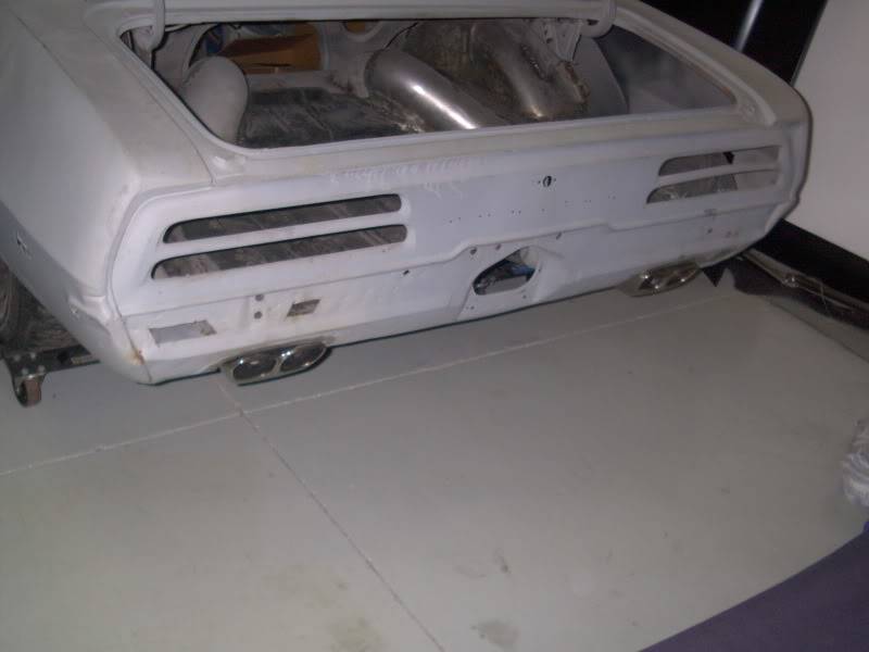

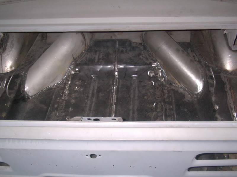

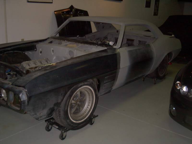

      here are some pics of my build[/IMG]
      [/IMG]

      Very cool....I'm assuming the two channels in the trunk floor are for exhaust tube clearance?
      The modified rear valance panel looks good, too.

      yes Leigh you are correct, I am using air ride and with there air bar there is no room to run the 3" mandrel bent exhaust I purchased from magnaflow, so I had the trunk modified. Question how do I bring this link over to the project side? copy and paste, or get a Mod to do so?
