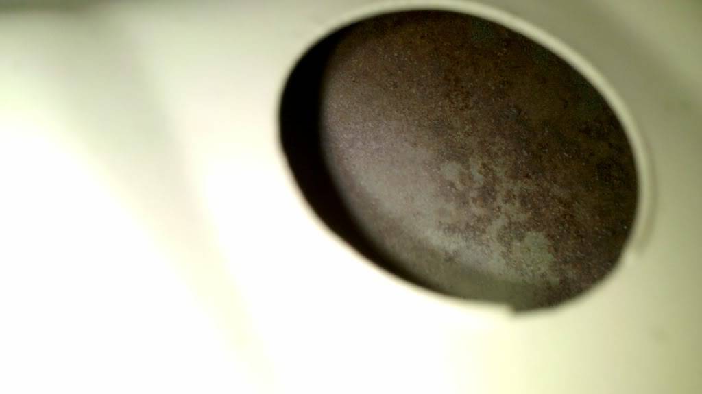

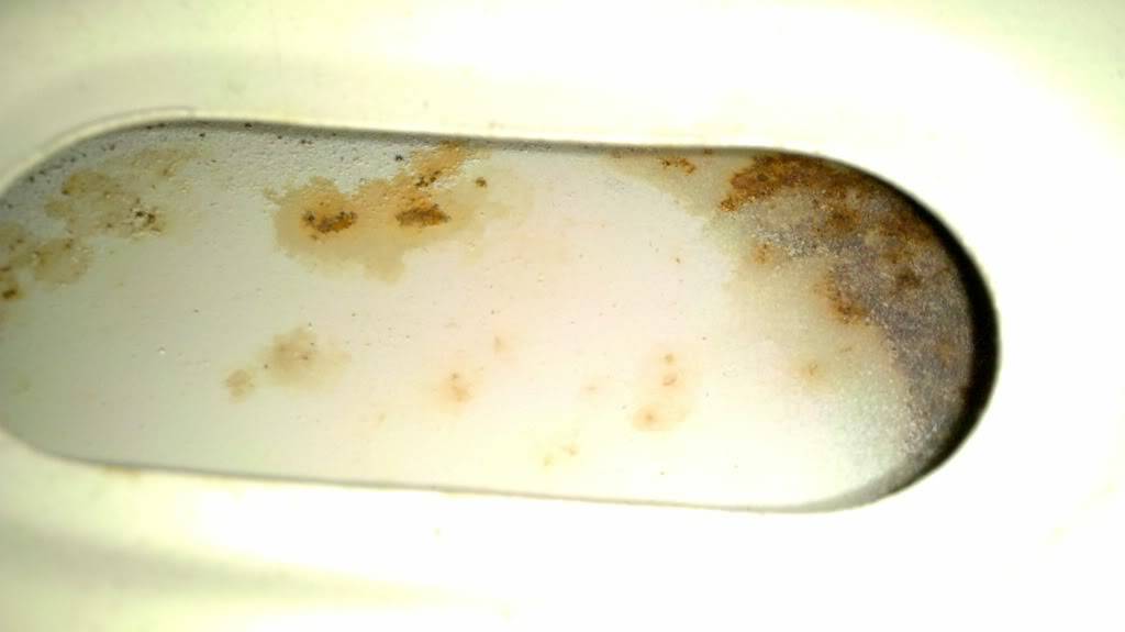

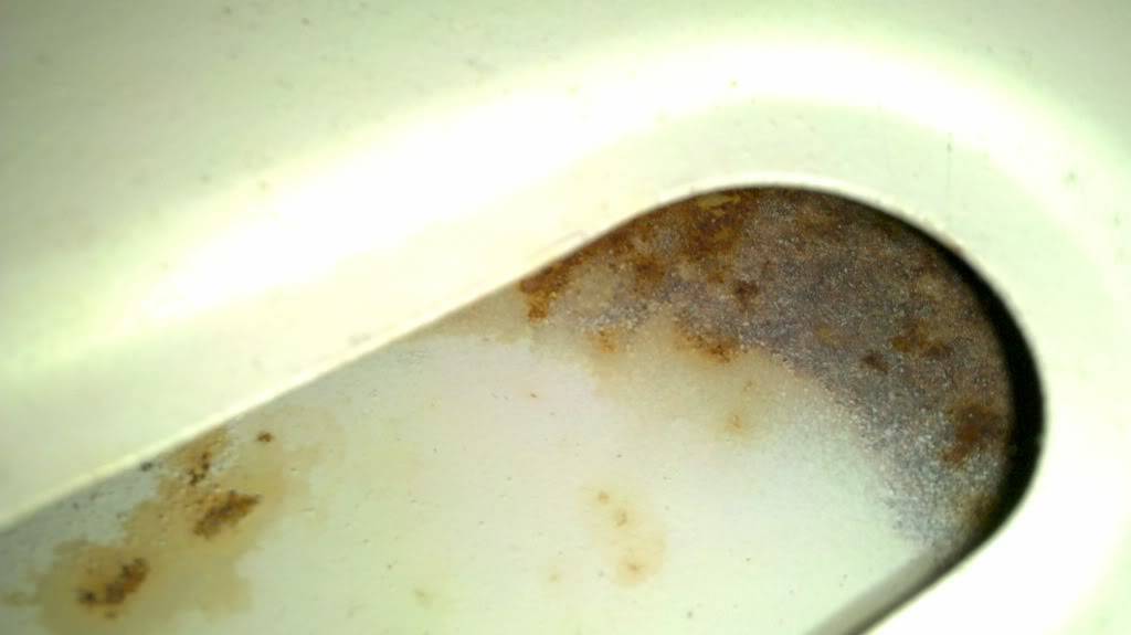

      The underside of my trunk lid, between the skin and the shell, has surface rust, what is the best way to deal with this? Any help is appreciated.
