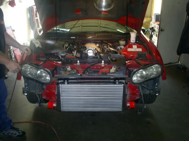

      I made some fake IC in cardboard to check position ans interference in the camaro: the9" heidh could be OK, but very tight, I will go for the 6", it is rated for 1000HP: enough for my application

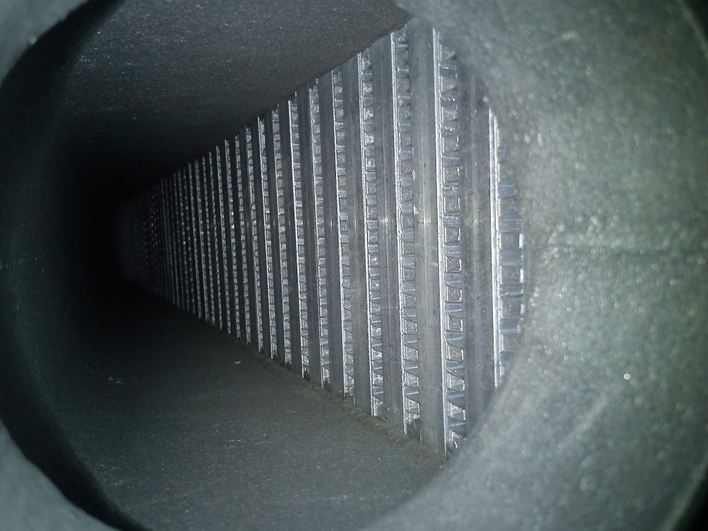

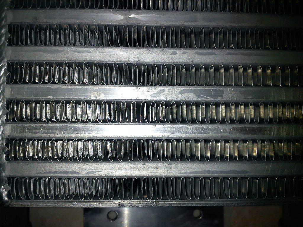

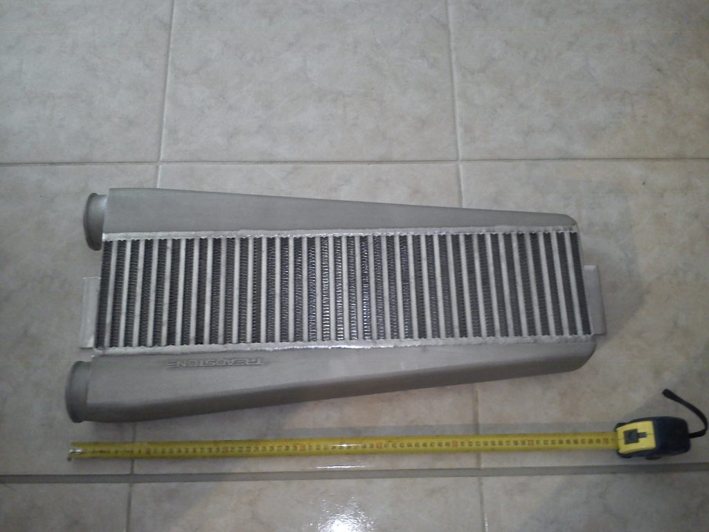

      I received my intercooler today.
      I don't think there will be a problem to make it fit in the car, and it should be big enough for my power goal.
      Some pictures (the scale is in cm not inch)
      internal fins:
      external fins:

      Looks good - I haven't been around for a while - but you can make a long IC like that more efficient by putting an air splitter in the inlet side that forces ~1/2 the flow farther down the inlet tank to the second half of the length of the IC. Not needed on the output side. It wouldn't be a hard mod even with end tank on.
      Jim
      Don't take a knife to a gunfight.
      Half-Assed = Half-Fast
      Jul 2008
      Strasbourg, France
      143
      Country Flag: France
      That would make the flow inside more even.
      You mean by putting a piece of sheet-metal inside that divides the inlet in 2, right? how would you be sure it does not move after ordoes not get pushed by airflow?
      Dunwoody, GA
      4,983
      The psi inside the intercooler will be basically the same through out the intercooler. So there will be no forces pushing on one side of the splitter that aren't present on the other side. Weld the splitter into the inlet and let it extend into the intercooler a little and call it good. Maybe even put a slight down curvature to the splitter. 1/16 to 3/32 thick aluminum should work just fine.
