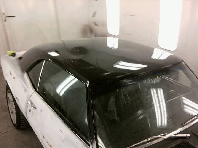

      you want to use an etching primer on raw metal, then you can use the por-15 (thinned down and sprayed-takes about 72 hours to fully cure for this purpose) then about 4 layers or more of a high build primer to block down, then a primer sealer, then color, then clear
      here's the roof panel on my car after a por-15 shoot then it sat in the booth overnight

      when panel are prepped correctly por-15 works without a hitch on, floors, sub frames, seat frames, so for our shop it was a fun to use the product to coat the inner quarters, trunk floors, and roof skin on my car to see how it holds up
      a few years and no issues!!
