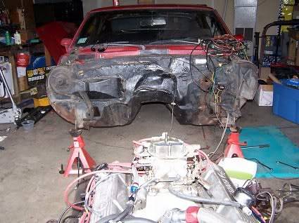

      and this was my car in my 2 car garage, just roll out to work on it and roll back when done

      Thanks! But...you are showing how to support it AFTER the sub has been removed. How do I support it DURING removal and avoid caving the floors in?

      I used the rockers to support the car, stronger than the floor. Or you could use the crossmember the subframe attaches to, just support it out by the rockers.

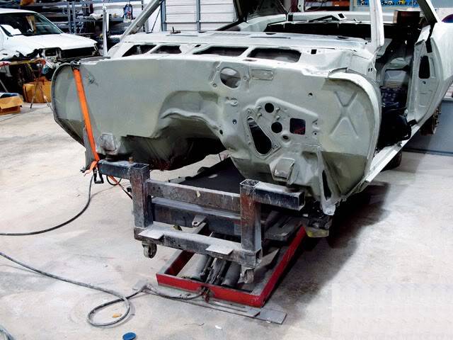

      I have always used a 4x4 running under each rocker panel 24" long to distribute the load.

      That sounds like a good idea. I was going to have a dolly fabbed out of steel, but based on what you've said and what Rod shows in his pics, I think I may just make an all wood one. Thanks guys!

      jackstands under the pinch weld on the rocker panels- that's the strongest point on the whole body and it's where the cradle held the body at the factory until it was dropped over the subframe. some jackstands even have a handy little notch in them that fits around it. be aware that the body will be tail-heavy if the rear end is still in it, so put the rear stands under the axle to keep the center of mass between the stands. if the rear axle and leaf springs are out of the car, then support it at the rear of the pinchweld on the roekr panels in front of the axle.
      the dolly you fab up to move it around can use these same points.
