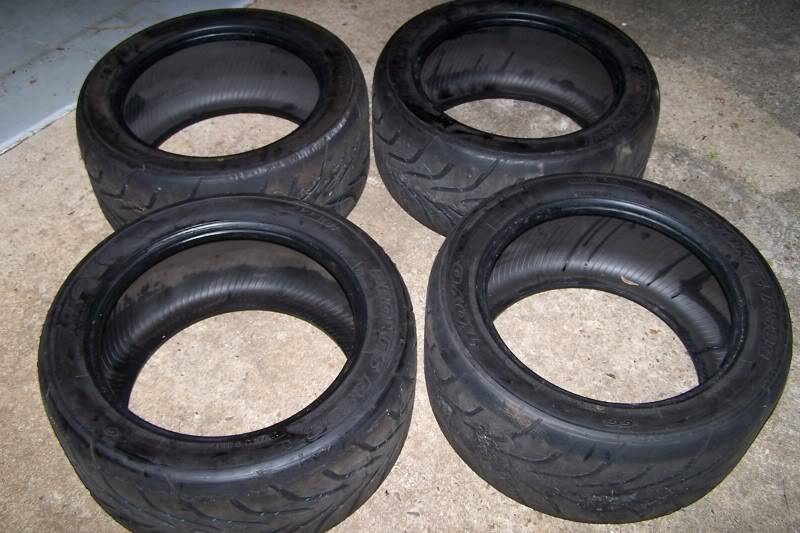

      Picked up a set of used Toyo R888's at Road Atlanta this weekend in the size that I need - 275/40/17. They have a little life left in them, but were bought mainly to use as rollers, check fit, backspace, etc.

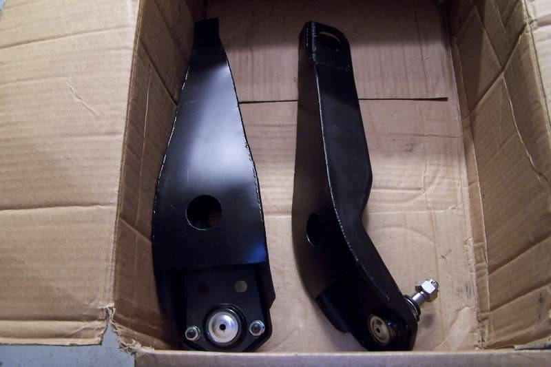

      Also picked up some nice boxed lower control arms at Road Atlanta from Jeff Puras - he's a retired jet mechanic and does very nice work! Picked up a clean pair of upper control arms from Jeff as well; one of mine has had some welding done to it. Plan at this point is to at least start off with stock front suspension coupled with coil-overs and aftermarket brakes. Here are the boxed lowers -

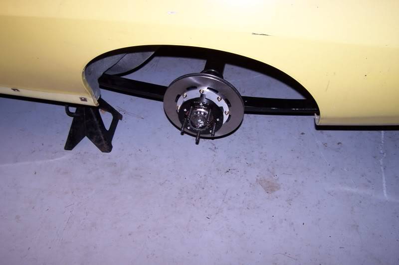

      Got one of the hubs and calipers on. Other side is fighting me.

      Think I have the hub issue worked out - - the seal on the back of the hub and the bearings were hanging up on burrs on the threaded portion of the axle tube - - chewed up the seals on both hubs. Sanded the burr down and now things are sliding on and off nicely.
      One of the axles was too long; Speedway recommends that the end of the axle sit about 1/16" - 1/8" below the level of the drive plate. Driver's side was right at 1/8" below drive plate - good to go. However, the passenger side was .73" below the drive plate. The axles are threaded on the ends so you can screw a bolt in the end (jam nut it w/plenty of red Loctite) to space the axle out a bit, but this would have spaced the axle out too far of the splines in the TrueTrac diff, which only has 1" of splines, and the splines end 1 1/8" outboard of the spacer in the diff. Have a 32.25" axle on the way; it should be dead on or maybe 1/16" too long. If so, I can take a bit off the end to dial it in just right.

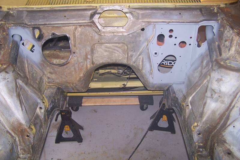

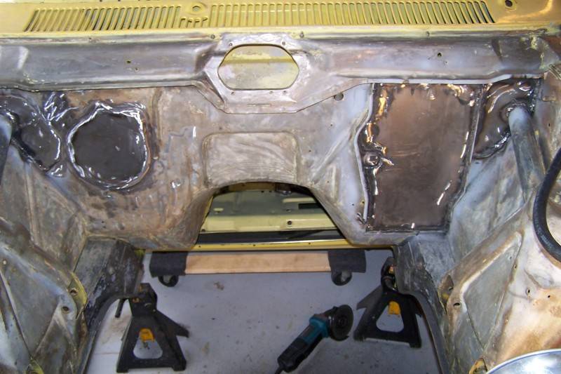

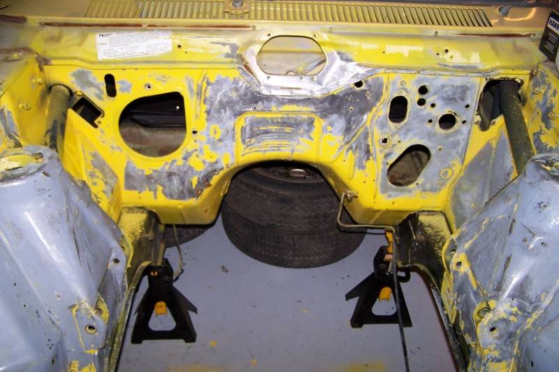

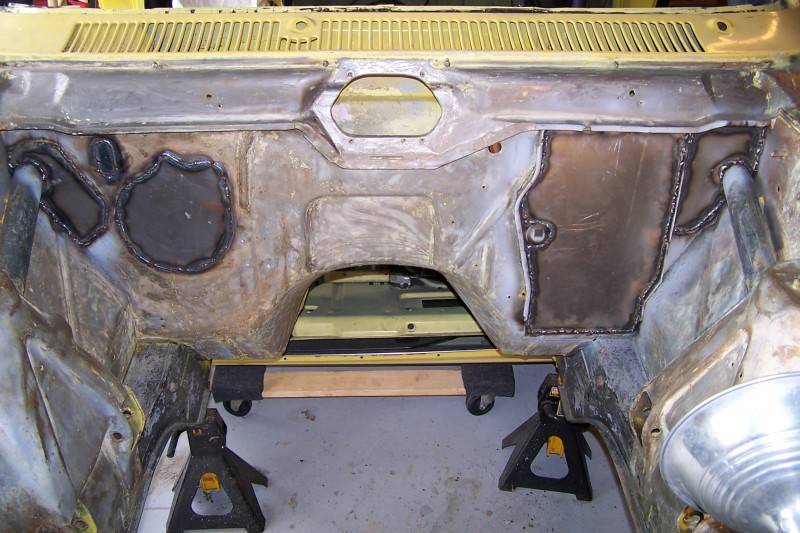

      Ok, the firewall is starting to look better.
      You can pretty much follow the progression of the photos below, but I stripped the paint from the engine compartment a while back. Took it down to the metal.
      Then treated with a metal treatment - Picklex 20, I think - kept it from rusting.

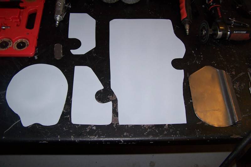

      Then made some templates for the necessary patches using a sliced up manila folder.
      Traced out the templates on a sheet of 18 gauge sheetmetal. Cut them out with a sheetmetal nibbler and then shaped with die grinder, cutoff wheel, hand file, etc. Took quite a while before I had them all fitting just right.
      Then I prepped the areas to be welded - ground down to the metal with a angle grinder. After it was down to the metal, I sprayed it with Eastwood's weld through primer.

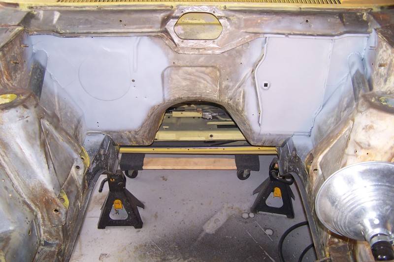

      Since welding thin stuff gives me fits, I called in some experts - local AMC'ers Jeff Reeves and Jeff Puras came over to lend a hand. Jeff Reeves laid down some nice beads and affixed the sheetmetal patches to the firewall. Most were lap welds; only one butt weld. Anyway, big thanks to the 2 Jeffs for their help; it came out great.
      I then ground down the welds with an angle grinder and painted with more Eastwood primer. Next step is to strip and prep the entire engine compartment for primer and paint.
