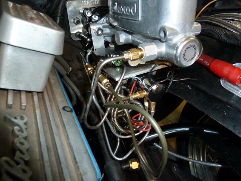

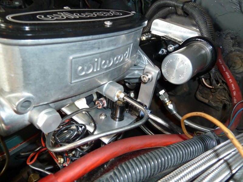

      I just installed it on a 78 Trans Am. Here are a couple pics.

      what master cylinder did you use? i sent a message to wilwood a while ago and never got a word back from them. there are a few astro's and late model vans with good hydroboost systems in them. is the p/s pump any different between the standard and the hydroboost?

      you sure have a mess of lines running around there, I like that reservoir, it looks good.

      Yeah. I put a line lock in to have fun with but it added all kinds of plumbing!
