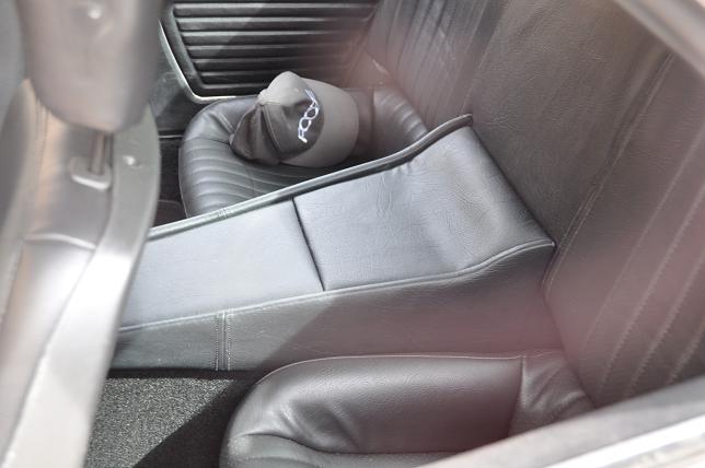

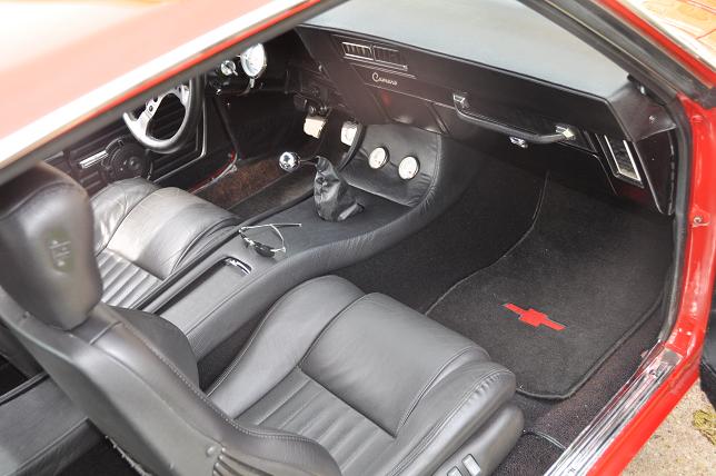

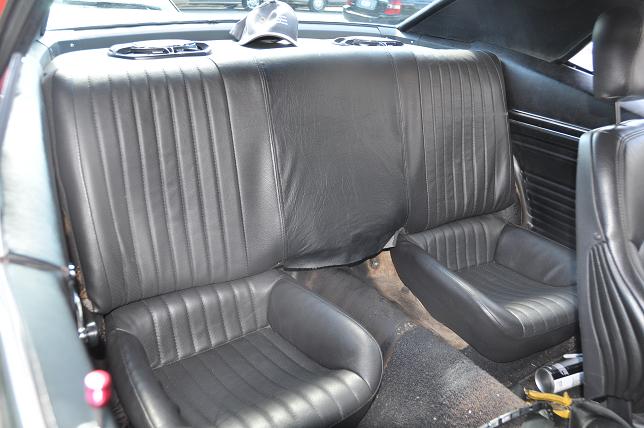

Size:  84.3 KBOK never done this work before, boy did I learn allot. Front seats where easy the rear seat had to be expanded by 10". Then started the center console this was not easy. all turned out ok, however, the piece I used to hold the gauge cracked so I have to make a new one. Maybe carbon fiber next time?
      Just need to add the cup holders and a few marker lights. Thought I would share. Next comes the doors and back panels

      Few updates fixed the gauge part added some lights and a shifter trim ring..
      Cup holders or not ????
      Nov 2009
      New York
      366
      Ok went with cup holders front and rear... Done!!!
