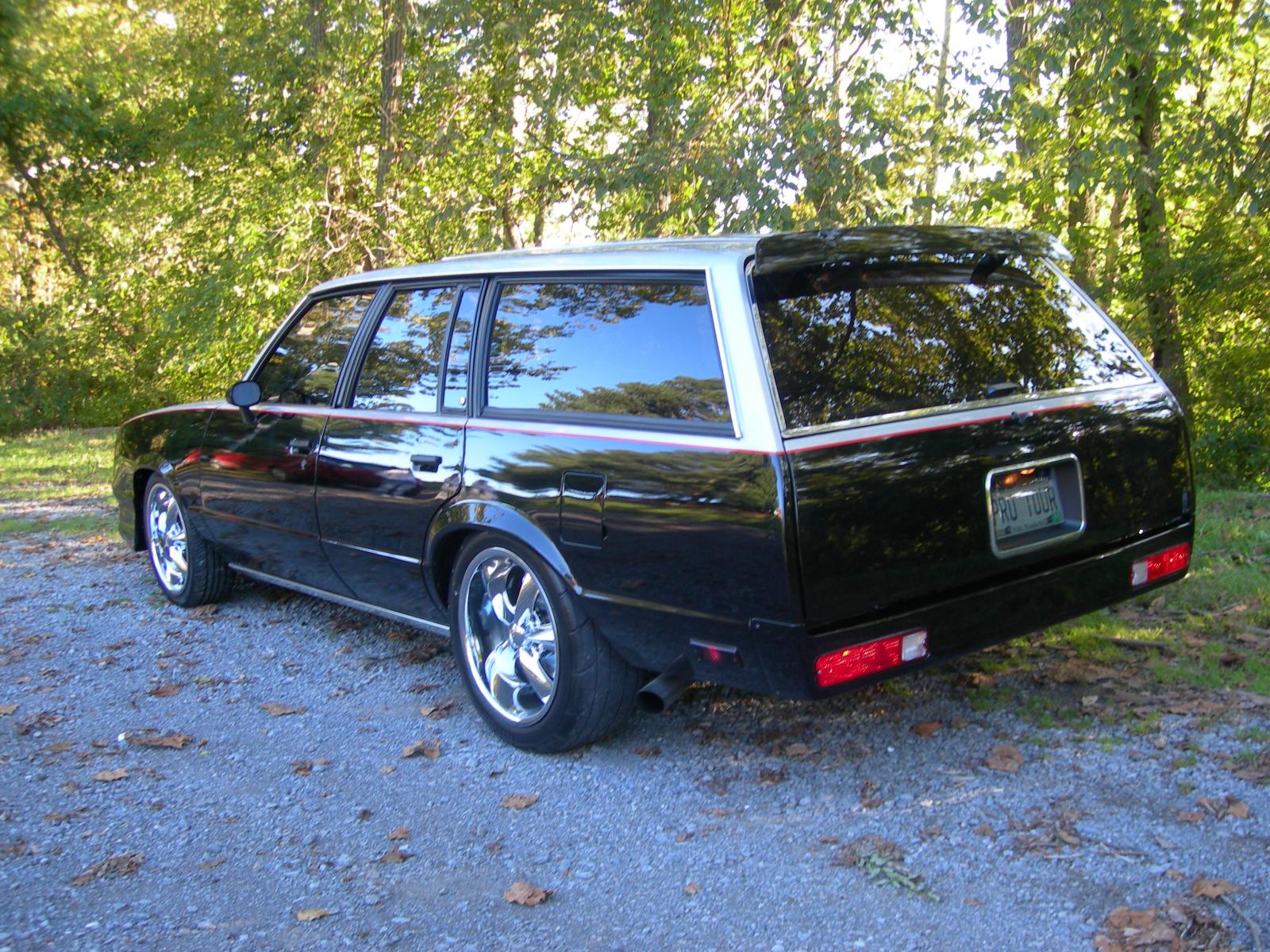

      Finally I have an update on Project Grocery Getter. I got her back from Bulldawg muscle cars and the Power Tour in Mid June and have been steadily working to improve her to what I considered to be a world class vehicle. The following is a list of what I have done since the initial build.
      1. The AC compressor on early Chevrolet Malibu V8's was located on the drivers side and LS engine conversion's locate's the compressor on the passenger side. Solution is 1986 V8 Olds Cutlass used passenger side AC compressor and we installed a new condenser from that year cutlass which eliminated AC hose's running across the front of the LS engine.
      2. Installed a new AC Delco evaporator from Auto Parts Warehouse .com.
      3. Had all new AC hose's the correct length for the changes made at local hose shop.
      4. When you install an LS engine in G-body cars the engine is moved slightly to the passenger side for clearance issues and a drive shaft safety loop purchased over the internet caused the drive shaft to make contact with the loop. A local machine fabrication shop made me a loop out of 1/4" steel solving the clearance problem and worked out perfectly.
      5. Removed the stock G-body radiator overflow canister and replaced with a Moroso Aluminum canister from Jeg's.
      6. Replaced both transmission cooling lines with #6 AN braided steel hoses.
      7. Purchased 2 front inner fender panels from Chicago Muscle cars, restored them and replaced the reproduction units. I had purchased earlier because they was brittle and shattered in use.

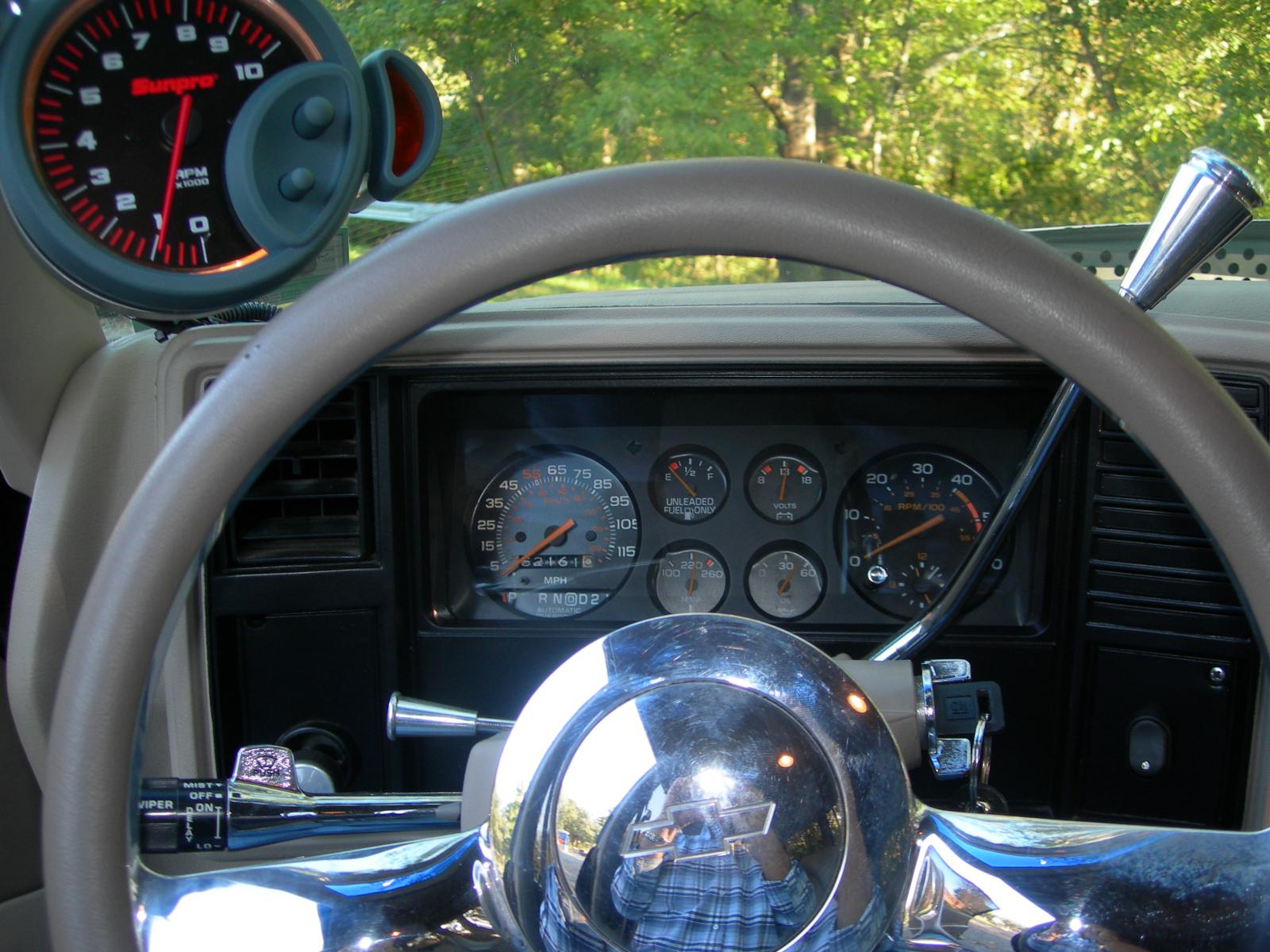

      8. Replaced the stock 83 Malibu instrument cluster with a panel out of an 1986 Monte Carlo SS which gave me a 115 MPH speedometer. Also replaced the instrument circuit board with a new NOS circuit board Also installed shift indicator for OD Transmission equipped cars.
      9. Installed a mew Sun Pro Tach with shift light on the A Pillar.
      10. Replaced both upper control arms.
      11. When you remove the front bumper and rear support braces as well as the LS aluminum engine you loose 250 to 300# off of the front end creating a suspension that is completely out of whack. To solve this problem I had the car professionally weighed by Rocket Chasis and the car weighed in at 3452 pound with a full tank of fuel. 883# pass front 939# driver front 819# pass rear 811# driver rear. With this info I was put in touch with Afco racing spring and a set of 900# 11" Street stock springs was installed along with Bell Tech S10 2" drop spindles and a new set of Bell tech shocks. After a front end alignment the car goes down the road straight with a decent level of ride.. Also a 1 1/4" sway bar and links was correctly installed.
      12. Replaced all 4 wheels with a set of Foose 18x7 Front and 18x9 on Rear. Mickey Thompson Drag Radials on the rear. an additional set of wheels and tires for rally use is in the plans.
      13. Tinted the windows with 20% tint.

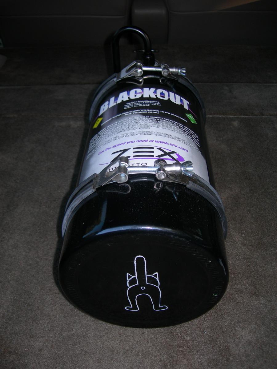

      14. Installed a ZEX 150 HP wet nitrous system complete with pressure gauge, safely evacuation tube and a MSD timing twister to retard the timing when NOS is used.
      15. Installed the Abbott X Box for the speedometer and works perfectly.
      16. Also and definitely the most importantly is to thank all of the people that made this car possible.
      1. BULLDAWG MUSCLE CARS
      2. DINK LOVE at LOVE PAINT
      3. BILL CLARK
      4. SCOTT MILES
      5. STEVE STUTLER
      6. JEFF PLETCHER
      7. RANDY AMOS
      8. PAUL CARVELLI
      9. MARK SIMMS
      10. JEFFRO at COMPTON METAL'S
      This car is unbelievable handles like a slot car stops on a dime, unbelievable acceleration.
      Everything I dreamed it could be.

      Thanks for the update Tom! I'm glad to see that the Malibu is everything you wanted it to be. This project meant a lot to all of us here at Bulldawg, and we hope that you get many, many years of enjoyment out of it. You deserve it.
      BTW, I like the artwork on the ZEX bottle! Your way of saying the car is "the cat's ***" ?
