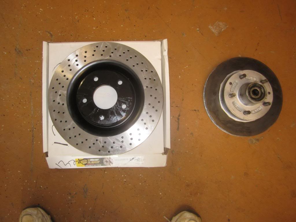

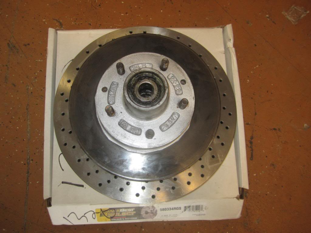

      We just received the new front rotors. They are C6 "J55" front rotors, from the Z51 suspension package. They use standard C5/C5 Z06/C6 base calipers (all the same), but a taller abutment. The calipers and pins are on the way, and the abutments should be in today also.
      Comparing the old rotors to the new is like comparing tea saucers to trash can lids!
      The old rotor on top of the new:
      Joe Hinds
    4. #64
      Cartersville, GA
      1,298

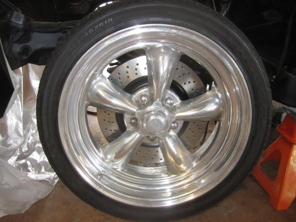

      Rotor installed...still waiting on calipers, brackets, etc.
      Joe Hinds

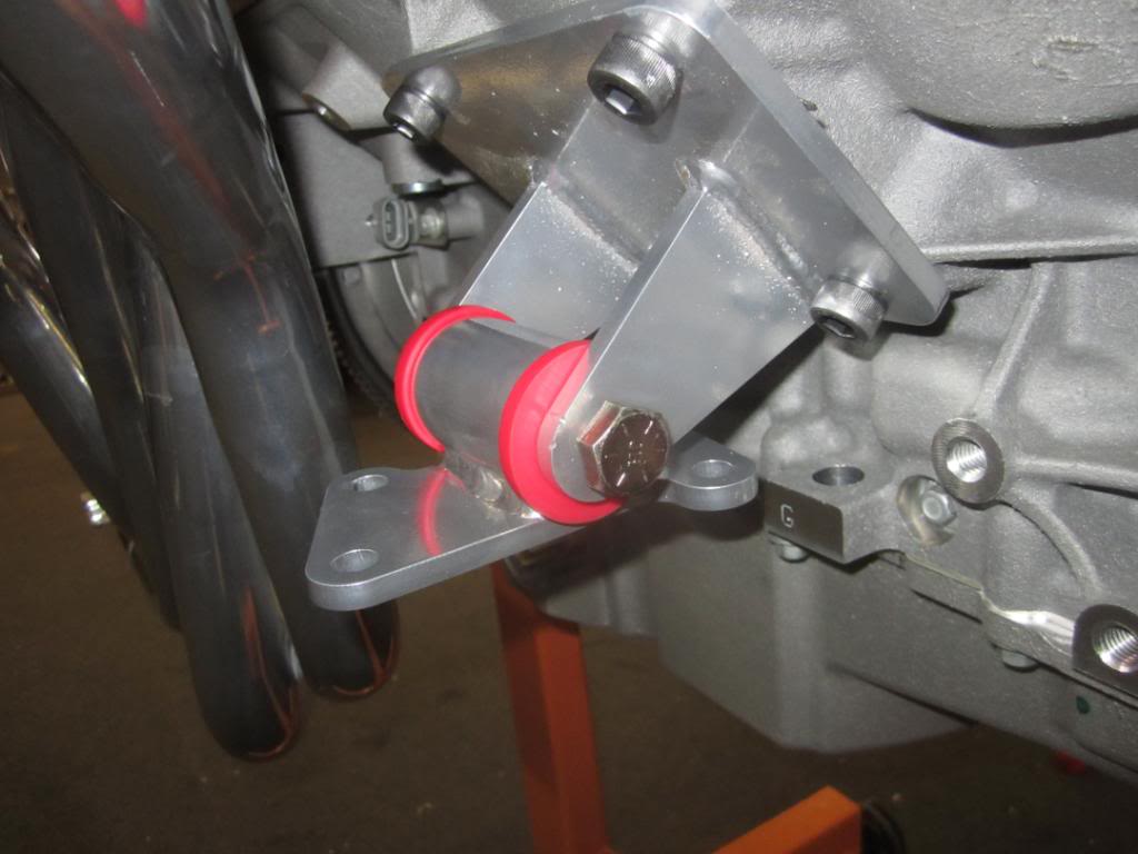

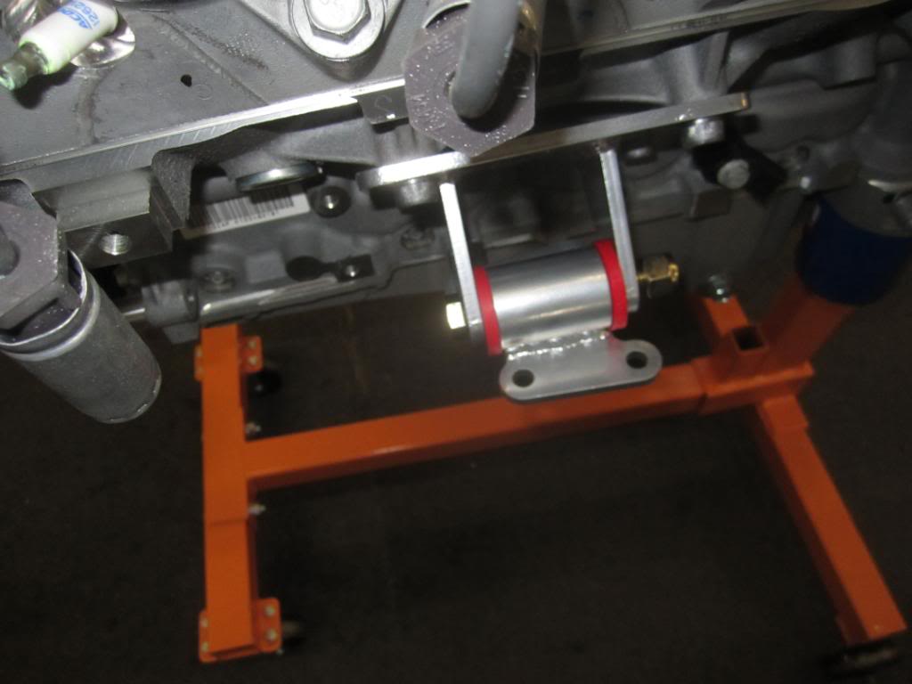

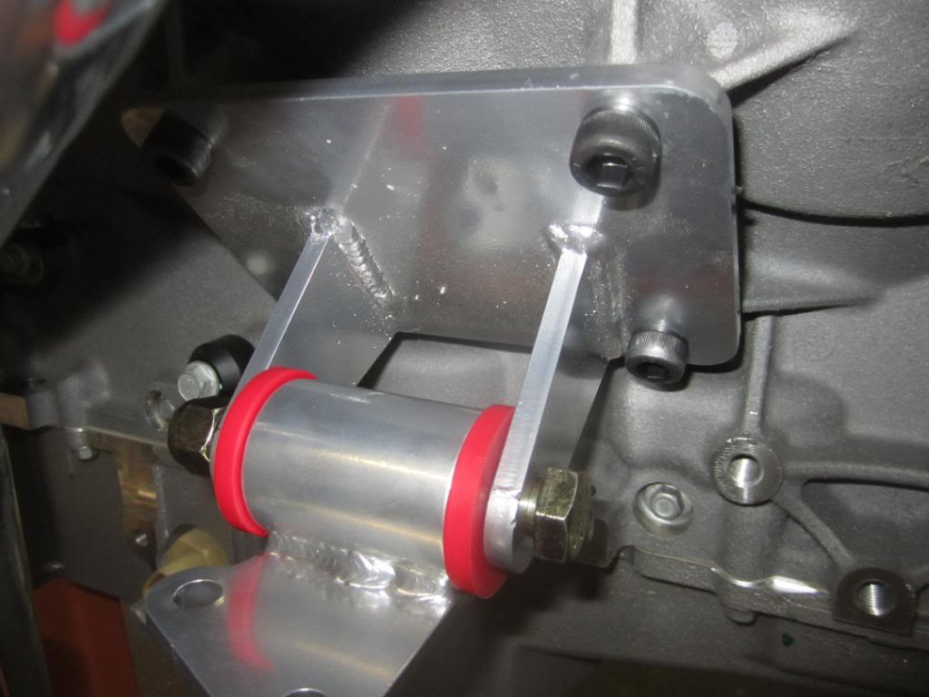

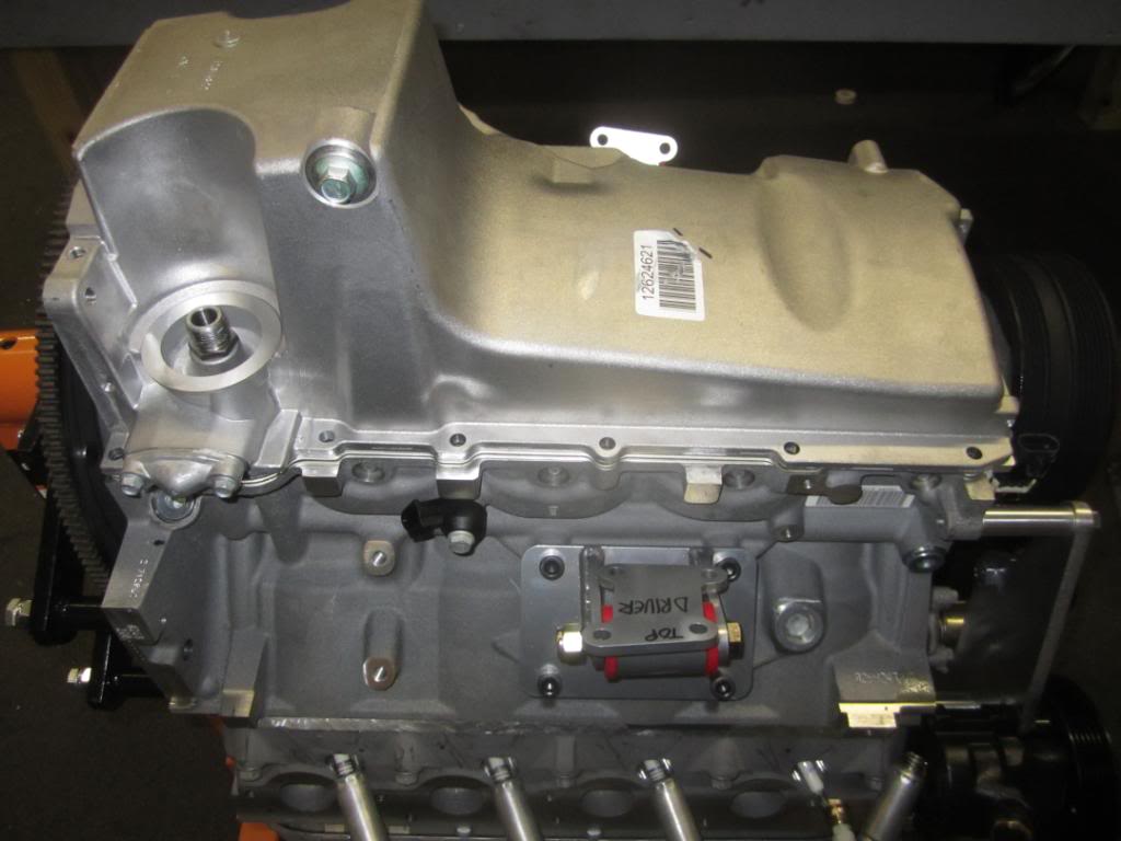

      Here are a few shots of the BRP/Musclerods engine mounts. They come powdercoated with a nice silver, and have Energy Suspension bushings installed. All the parts are marked, so there is no guesswork as far as how to mount them.

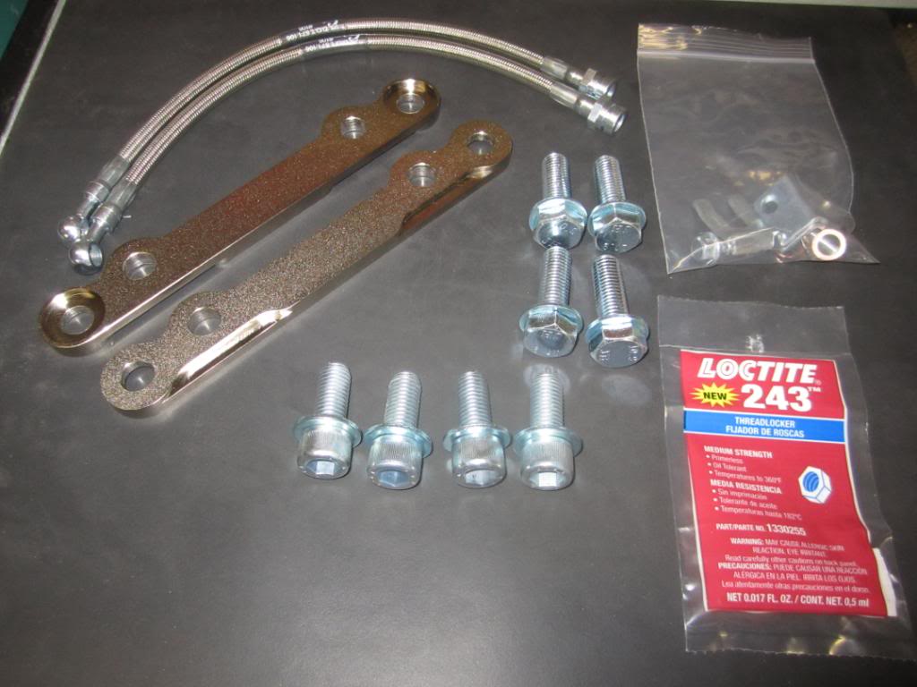

      I got a surprise today...my order from KORE3 came in (just ordered late Thursday!). I ordered the front hoses, and the caliper bracket kit. They came with all the hardware, brackets for the hoses, as well as Loctite for the mounting bolts. This was my first order from KORE3, and won't be the last. Thanks Tobin!

      Question - are you going to paint that gold plated crap on the brackets?
      I think its some kind of plating they put on metal. I've had a few swaybar brackets that have been covered in it, and after a few years start to rust out. So everytime I see that type metal finish, I always scuff it and spray bomb it.
      Also - nice choice on the z51 brakes - I still have my setup sitting in storage till I can bolt them on a project car, haha.

      Yes, definitely...it looks good now, but I agree, it will be rusty in no time. I have a few items that I may just powder coat, if I can get it done quickly enough so as not to hold up the build too much.

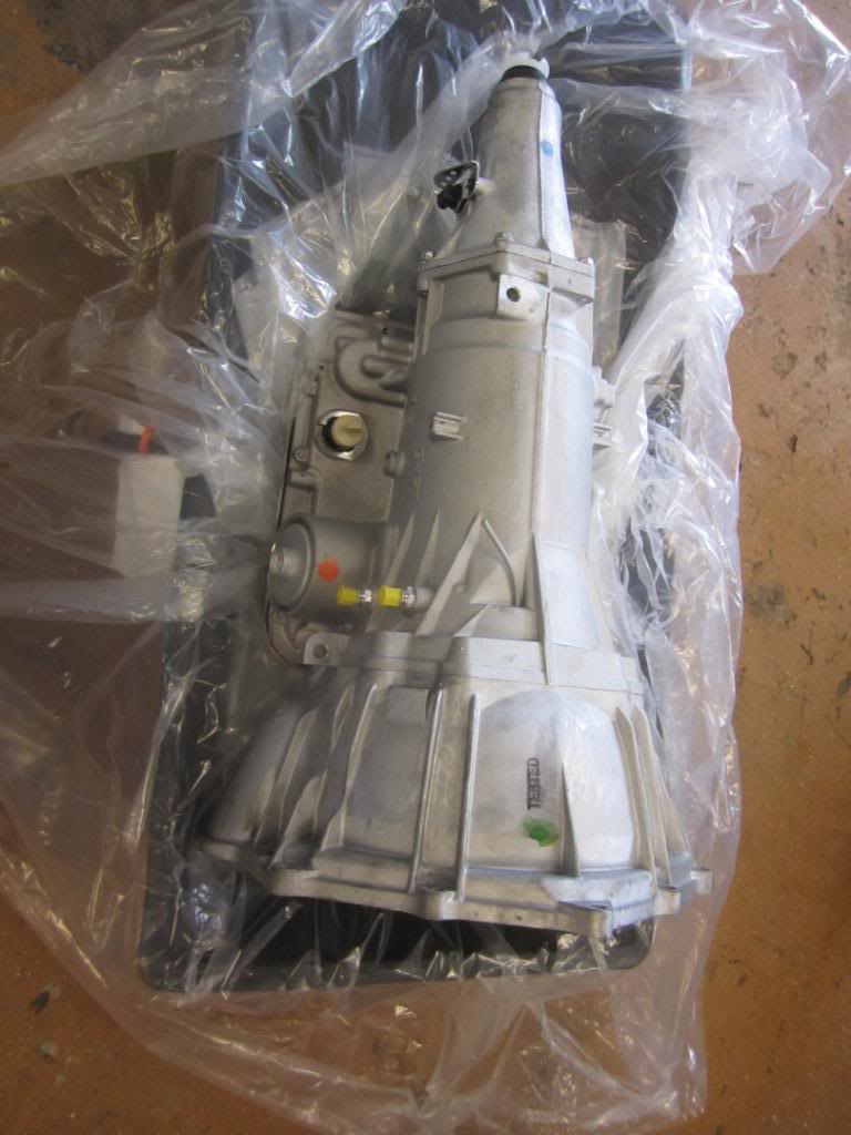

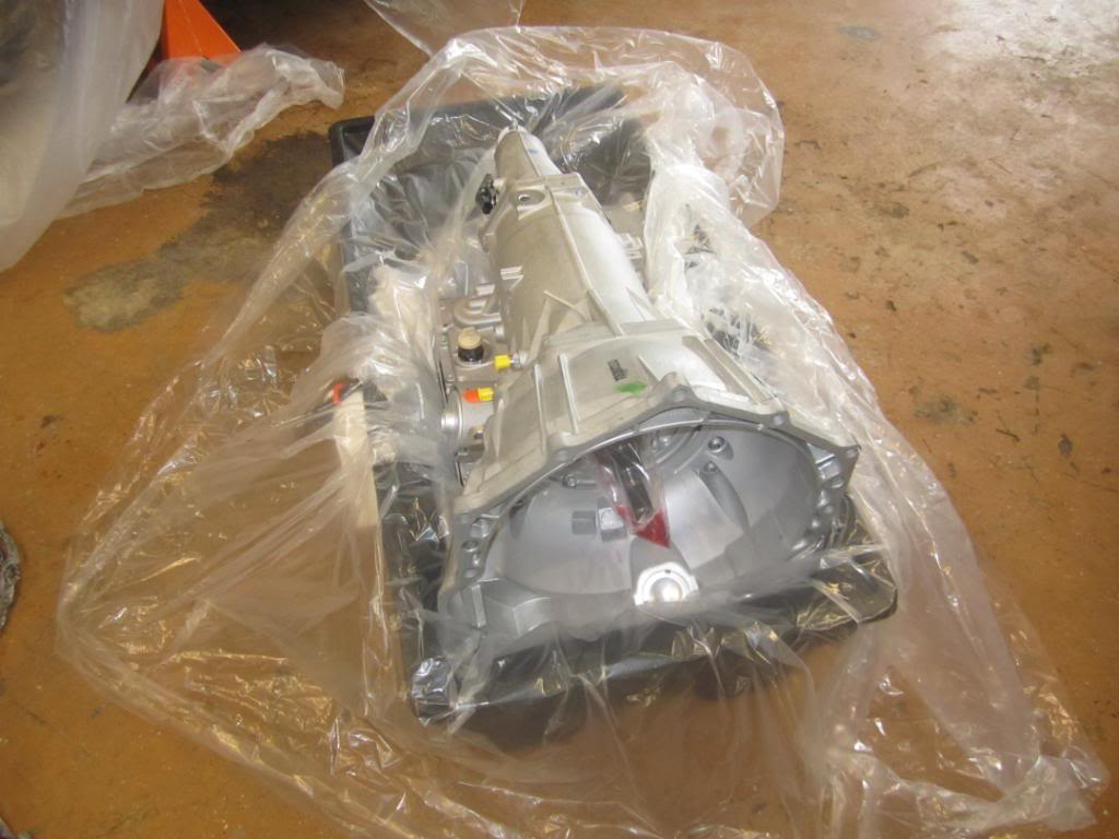

      Some of the goodies we got in today:
      The Supermatic 4L70E Transmission
      Joe Hinds

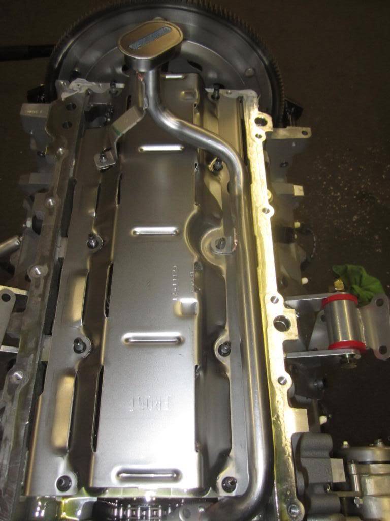

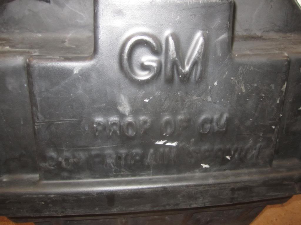

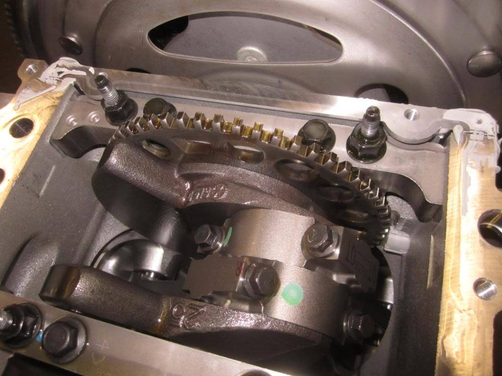

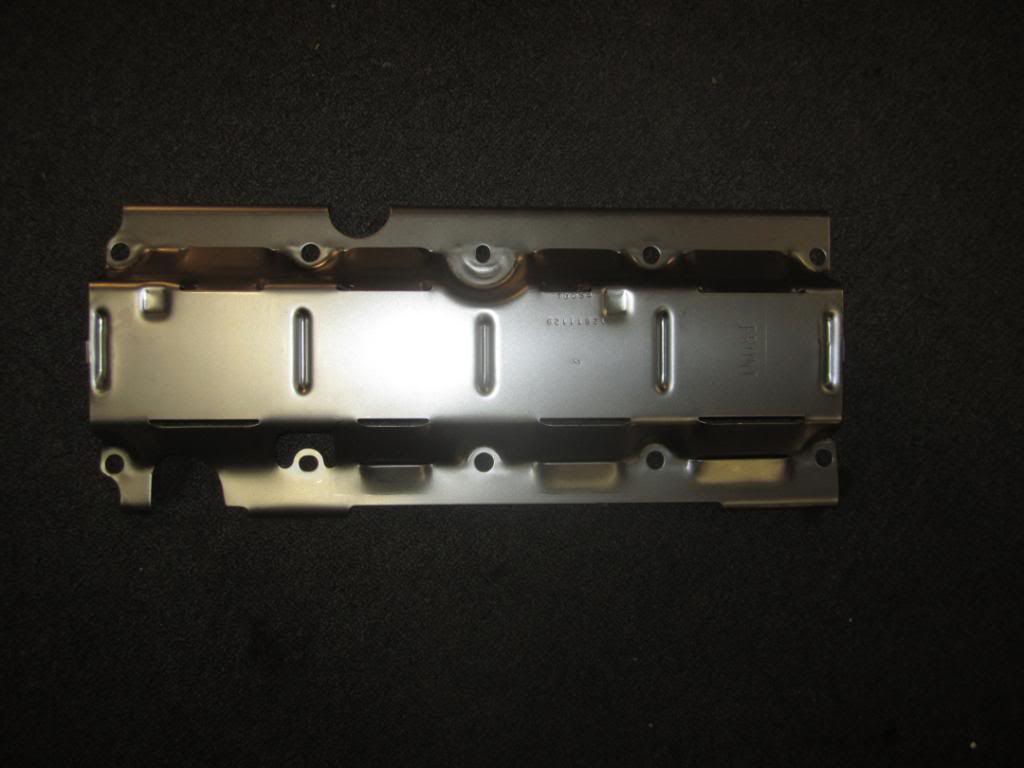

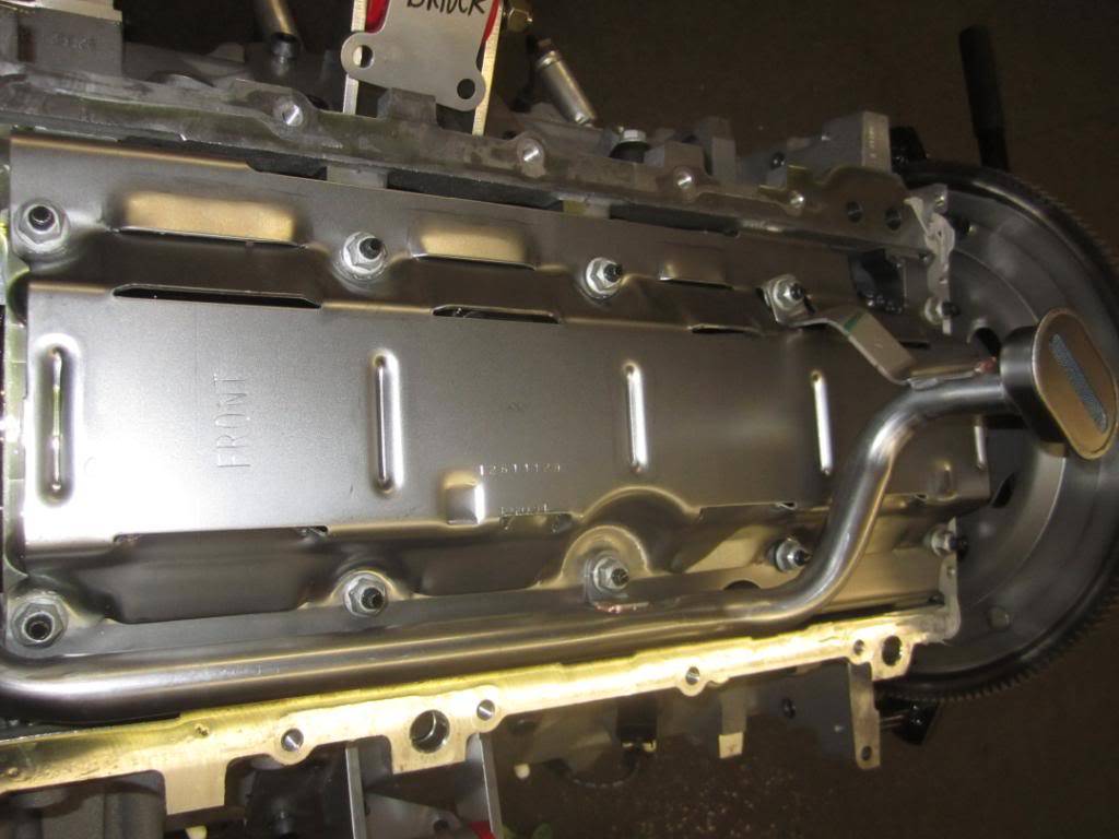

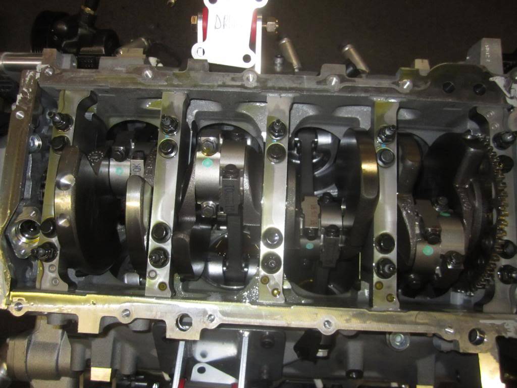

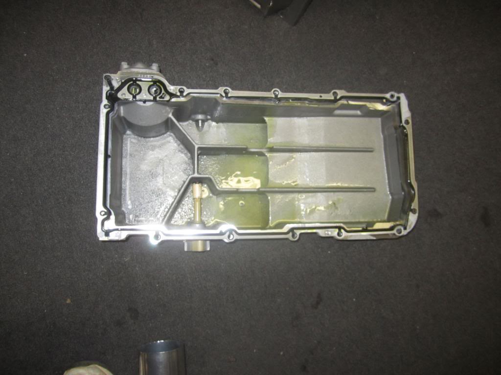

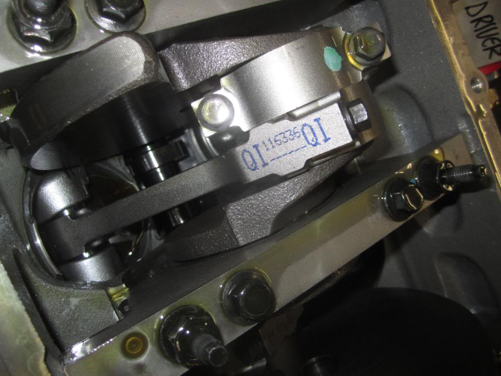

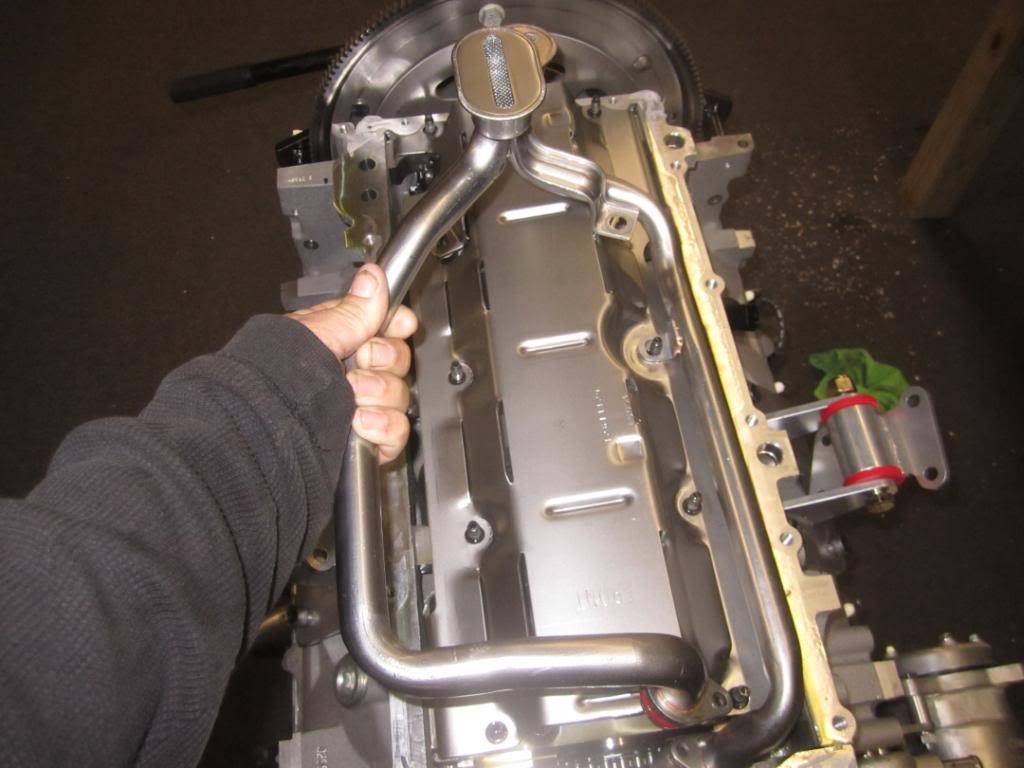

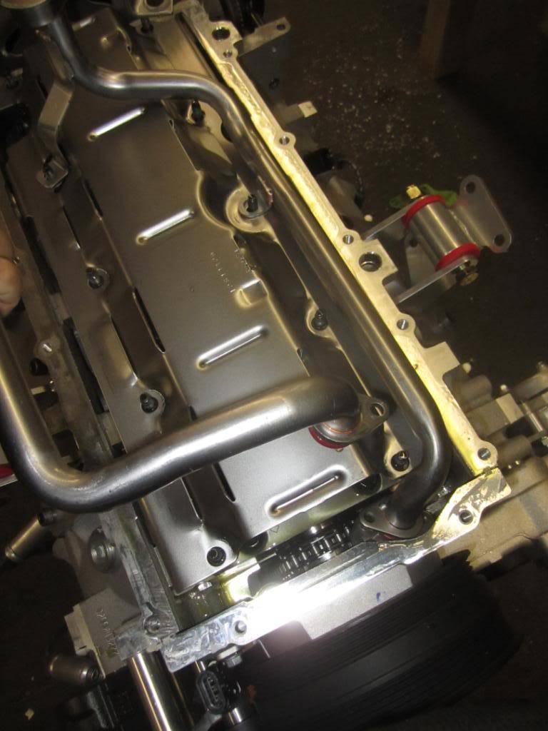

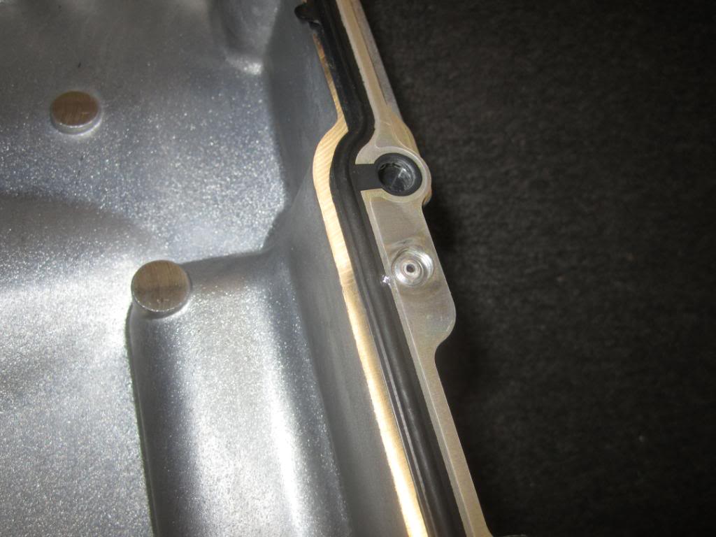

      I spent a good part of the day chasing parts and talking to customers, so now that the shop is quiet I'm getting some stuff done. Fortunately my crew got lots of cleaning and detailing done while I was busy, so hopefully we'll be installing the engine in the morning. Still lots to do before its ready to fire.

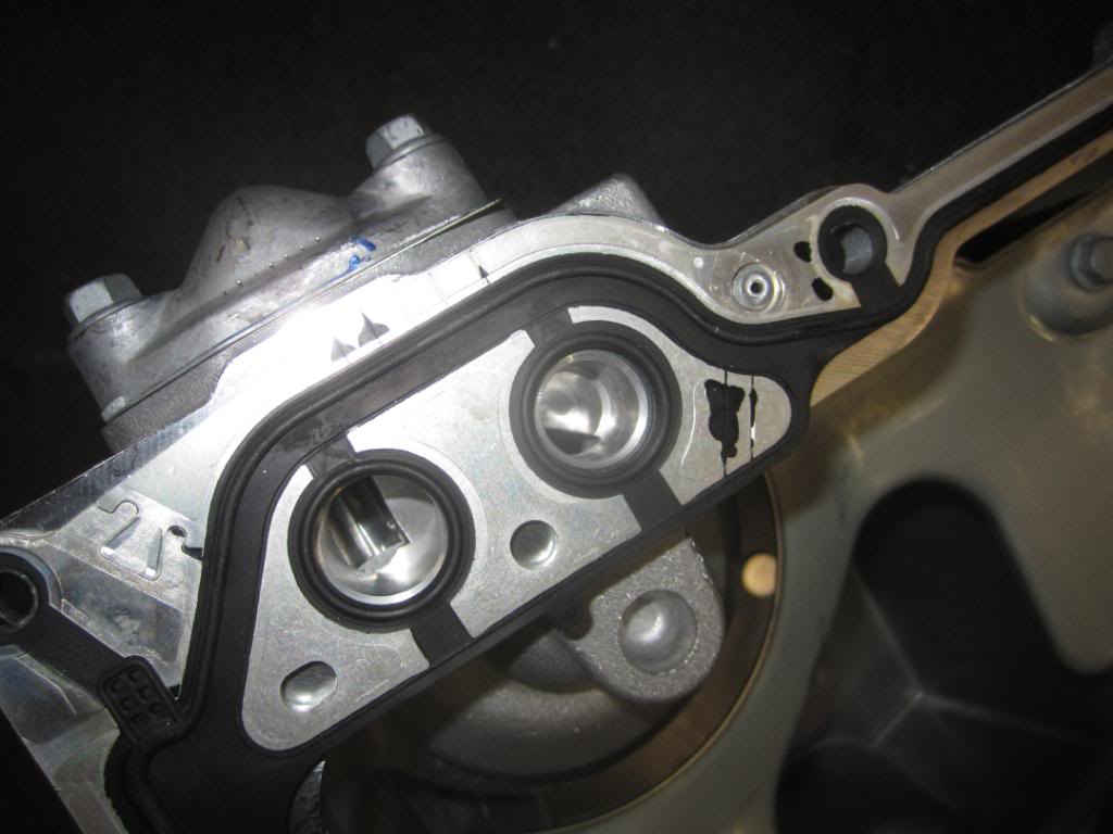

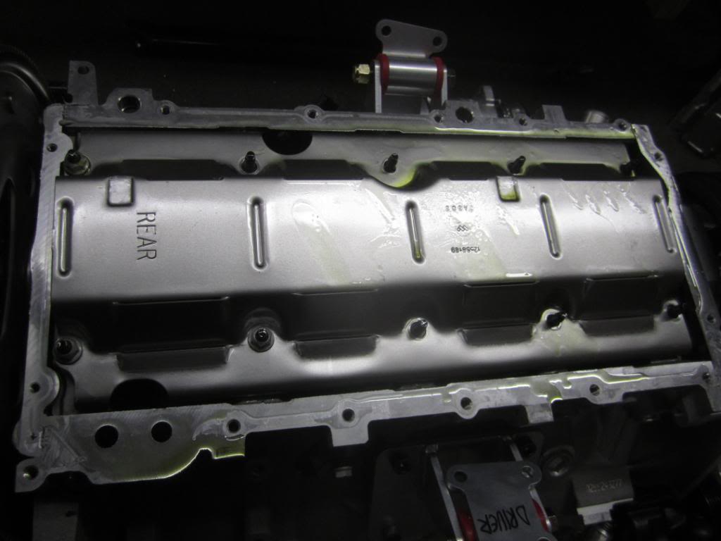

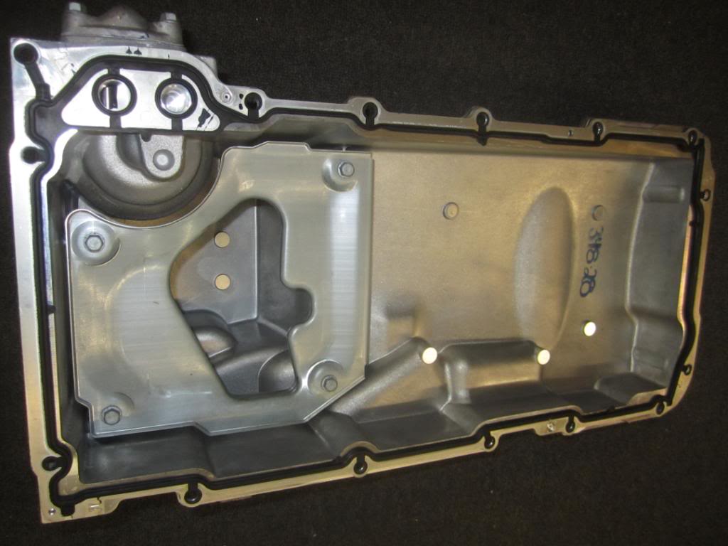

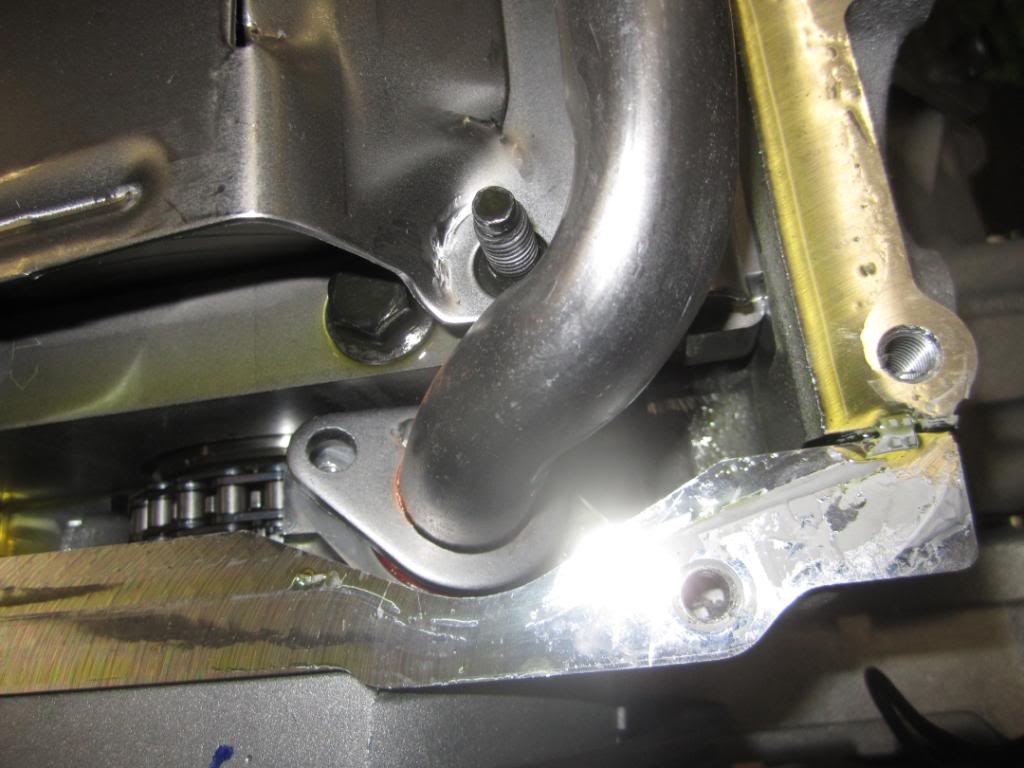

      The original Corvette pan was still on the engine, so I decided to get started on changing it out for the "musclecar" pan.
      I just removed the pan, and the pickup, before remembering I should be taking pics. Doh! Its been a long day. The widage tray isn't much different than the replacement (different part #s, and a few subtle differences).
      Inside the original pan
      The new windage tray
      Inside the LS3
      The new pickup bolts up from the opposite side (both sides are drilled)
      Here I am holding the old pickup:
      The new pickup and windage tray bolted down:
      The new pan and gasket. Note the gasket is riveted to the pan in 2 places. I guess GM doesn't want the gasket to slip out.
      The pan in place, but not yet bolted down. I need to get some gray Hylomar in the morning for the corners (that is what GM used)
      9:47PM...time to call it a day.
      Joe Hinds
