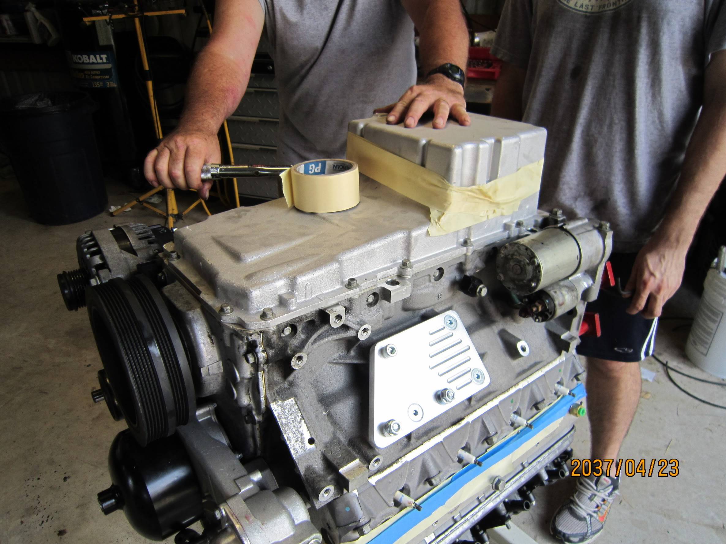

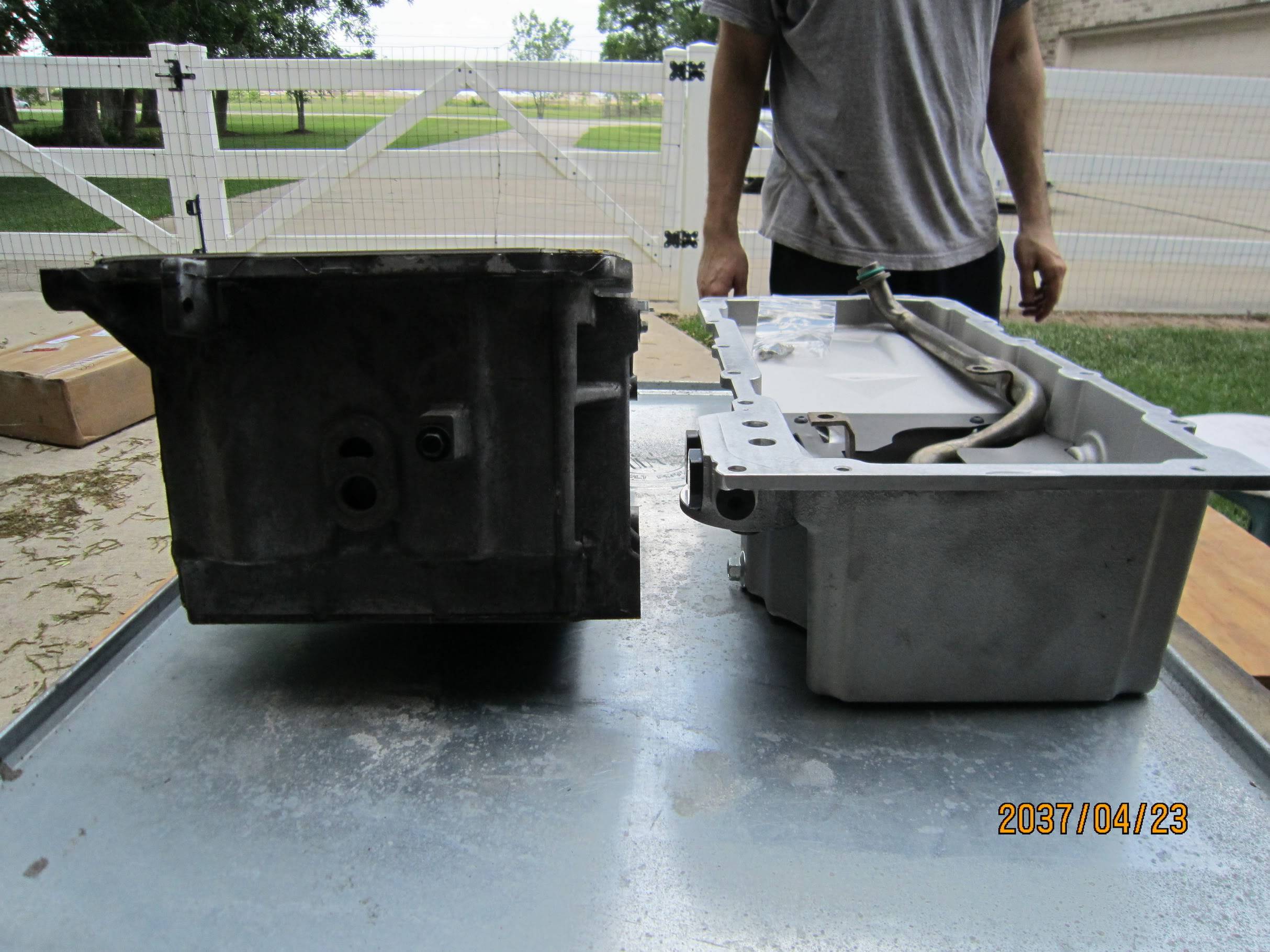

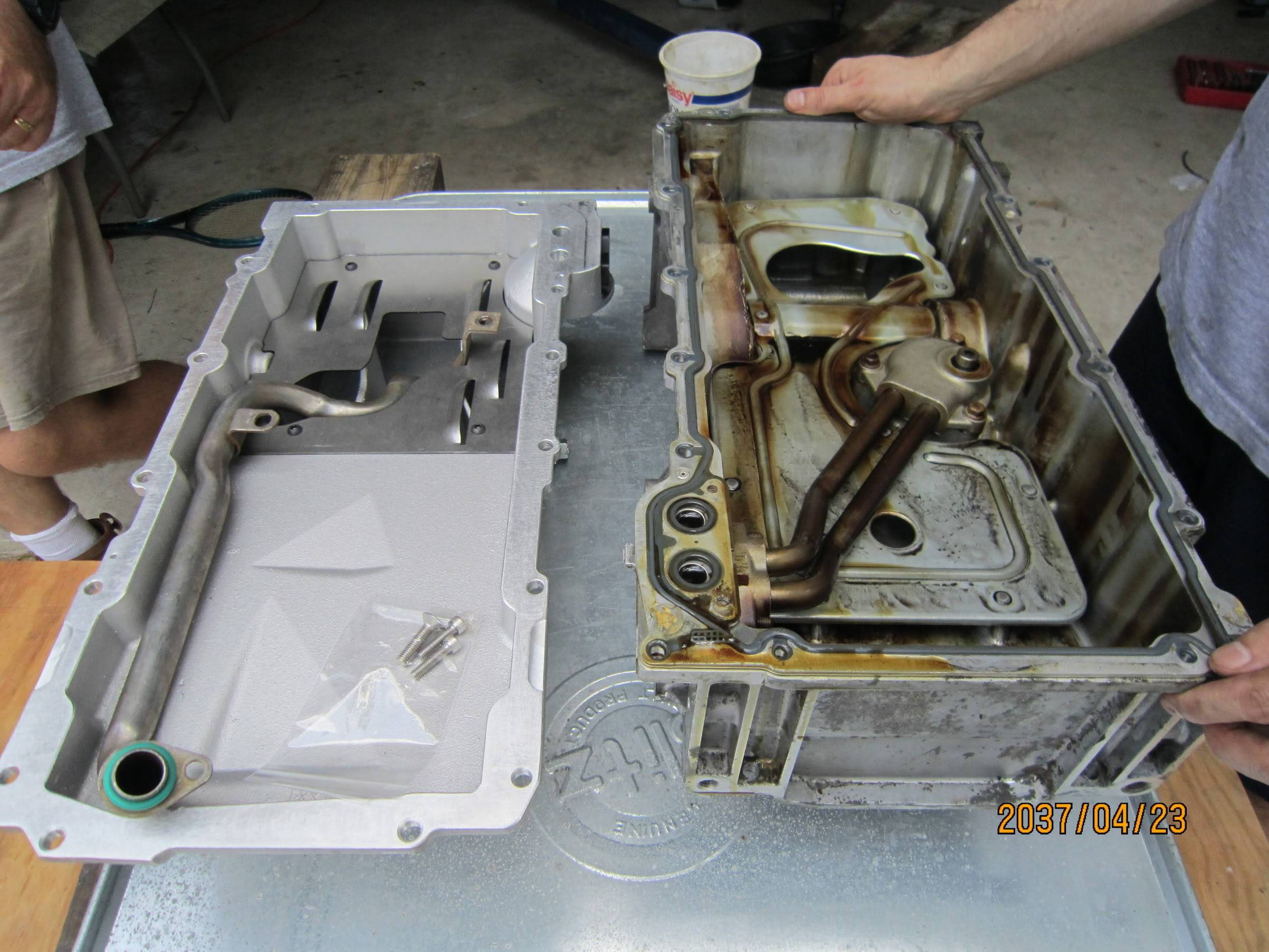

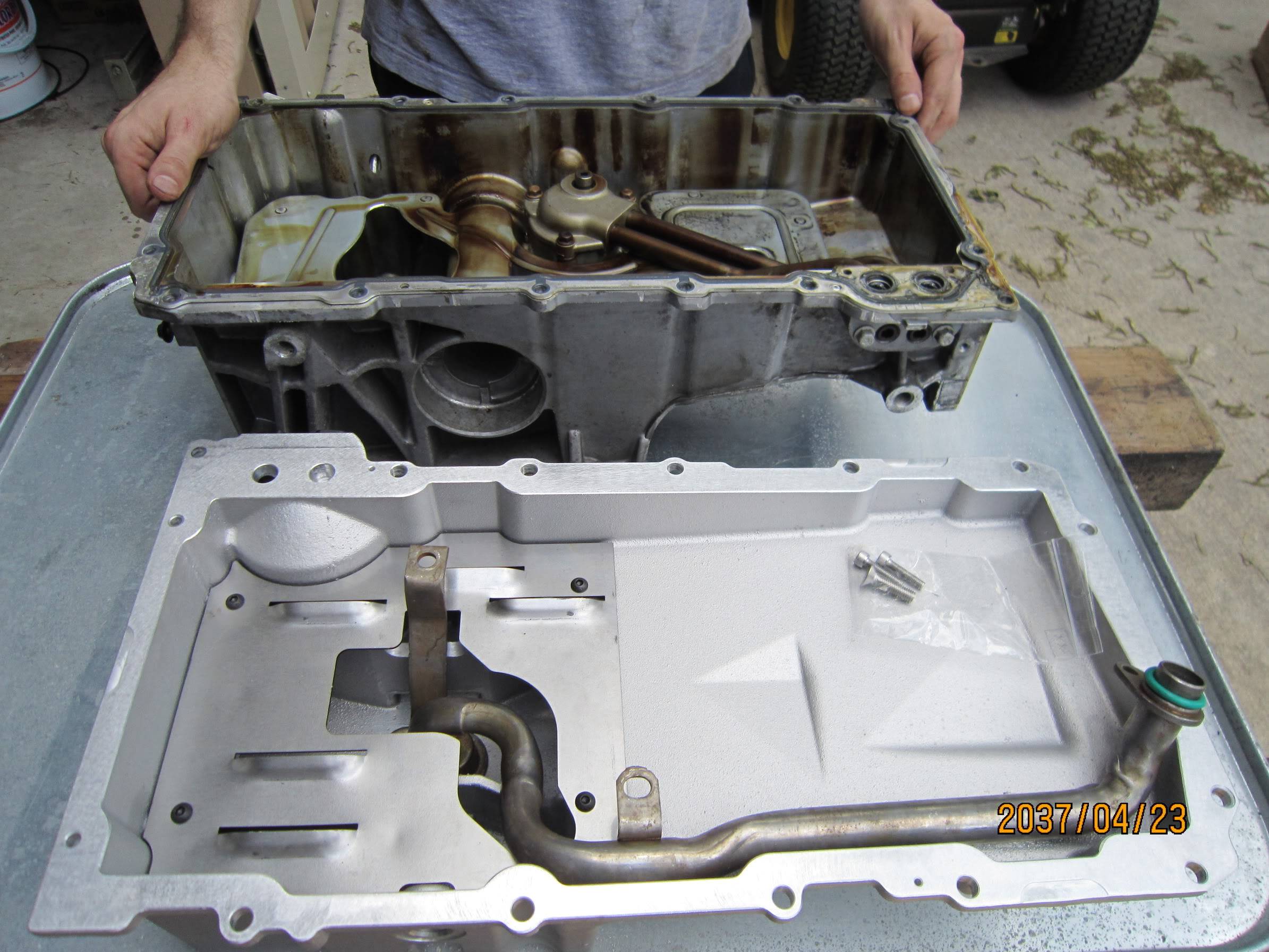

      If you have a stock truck pan already installed you will have everything you need. I have an LS2 out of a Trailblazer - the installation took about 30 minutes...
      1. removed the stock pan
      2. removed the pickup tube
      3. installed Mast pickup
      4. Drilled out stock pan gasket rivets
      5. installed gasket onto mast pan (riveted the gasket back on)
      6. installed and torqued pan. (mast provides three new allen head bolts for the rear of the pan
      7. Install filter and LS1 oil level sensor (which are on the way for me).
      slightly different than the stock pan...
      and installed on the engine
