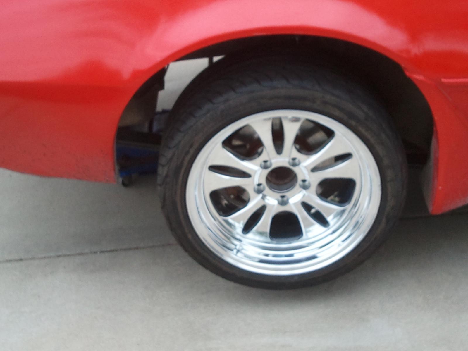

      here are some pics of the 10s I am putting on my 1979 trans am this a ws6 car so has rear disc brakes
      NO tubs all stock and its tight
      I have a mock up 245 40 in the pic I think I could squeeze a 255 in there but I am not sure.
      Name:  2011-04-23 11.40.00.jpg
Size:  118.9 KB I would lower the car to fill the wheel well BUT my super 44 mufflers are already about 3 inchs off the ground any lower and they would scrap the ground. so i am not sure how people get away with it unless theres scrap or they run glass packs.
      Name:  2011-04-23 11.40.19.jpg
Size:  117.8 KB I didnt roll no fender lip this is stock
      and I hear on here how guy can stuff a 275 under here but i dont see how cause its almost touching on the inside wheel well NO I didnt have to beat my seat belt bump in
      Hope this helps anyone who is trying to stuff a 10 under a 1979 Trans am
      NOTE all cars are not the same 1977 and 1978 could be different
      Ill post more as this build goes on maybe a 255 fits and doesnt Rub the inside will see and ill let you know
      like i said its STOCK and its TIGHT

      Id run the muffler in the OE location, provides more clearance. I guess the camaro and firebird wheel wells are different, my car wears 275's on a 9 inch wheel and has 1.5 inches of clearance.

      The problem is the backspacing. What is the backspacking on that wheel?

      I want to say they are 6" deep but ill head the shop and double check

      Running 275's on a 9.5" on my 73 Camaro. No issues there. PLENTY of clearance. Definitely has to be the backspacing.

      well the rim and tire shop and the company I ordered the rims from set it up and they are pro when it comes to rims and tires
      so i trust them on the set up they sold me
      FRONT 3 1/4
      REAR 6" deep
      10 7/8 out side to out side
      I think a 255 will sit flush with the rim

      All the 10" wheels I have ever boughten all measure 11 inches wide. Are you sure you dont have 9.5s?

      yes they are 9.5s i just call them 10s
      any tips on a tire that will mount flush with the rim
      and doesnt balloon over the edge
      I dont want the rim edge to show like they do with the 245

      I would do a 265/275, I had run 255s on 8.5s and it was perfect

      ya I am going to try and get a mock up 265 tire to do some test fits
      hope it works
