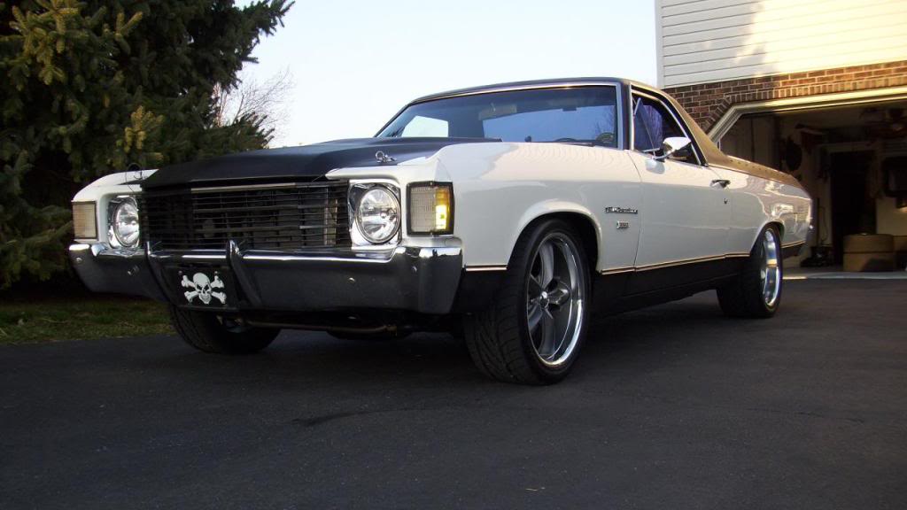

      I currently have stockers that I cut down a bit for the look I want for my Pro Daily Driver HeLLcamino, but am not happy with the 39 year old lack of stability that these springs have.
      I read about Eibach Pro Kit with a 1.3 inch drop, but I don't believe that will make me happy considering how low my truck sits now. Do the Eibach's lower them more then they claim? What other brands did any of you A-body guys have that are stiffer yet low enough for a decent look?
      Here is a pic of it now with the cut stocker fronts.

      I went with the Eibach Pro Kit and could not be any happier. The truck sets the exact height as the pics above, but with way better support and handling. Thumbs up to Eibach on a great spring!
