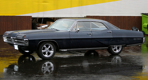

      Any help selecting a master appropriate for a 67 B Body (Canadian Pontiac) appreciated.
      Big car.
      Originally Drum/Drum

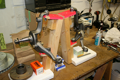

      Will have C3 fronts with Wilwood D8-4's
