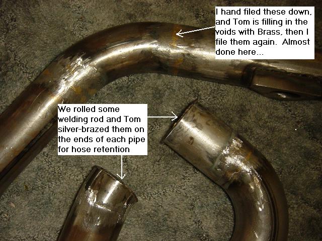

      I used welding rod and my buddy Tom braised it on:
      No issues of hoses popping off (like some of my friend's chrome tubing, no bead), and the beads are small enough to allow an easy install. Since the beads are rounded, as opposed to a sharp-edged flare, they don't chew up the insides of the hoses. After ceramic coating, looked really sano.
