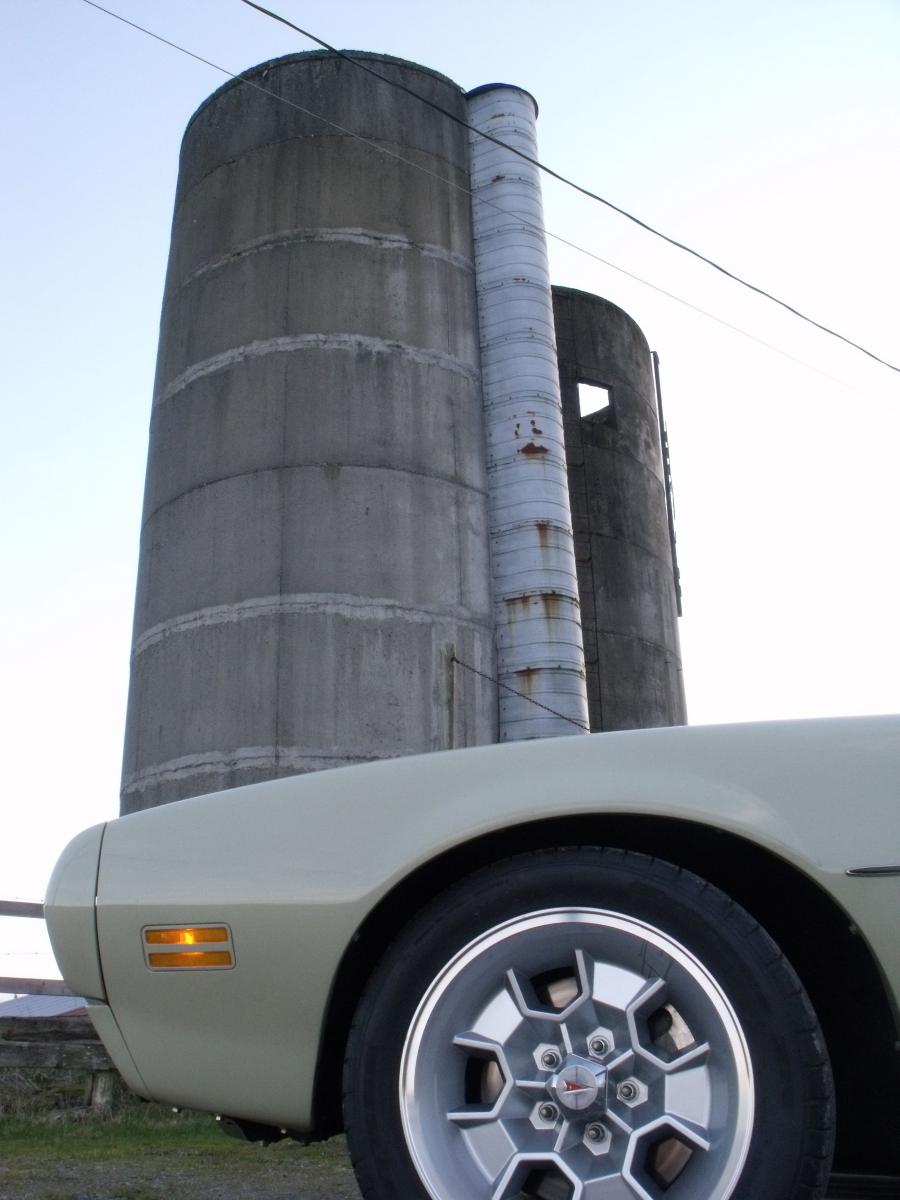

      Just got these mounted,fit is great. They work well with the C6 caliper and Kore 3 hubs with the exception of the dust cap. Even with the small dust cap installed I needed a small(1/4") spacer in order to use the wheel centre cap. The centre caps need massaging to actually fit and stay in place.

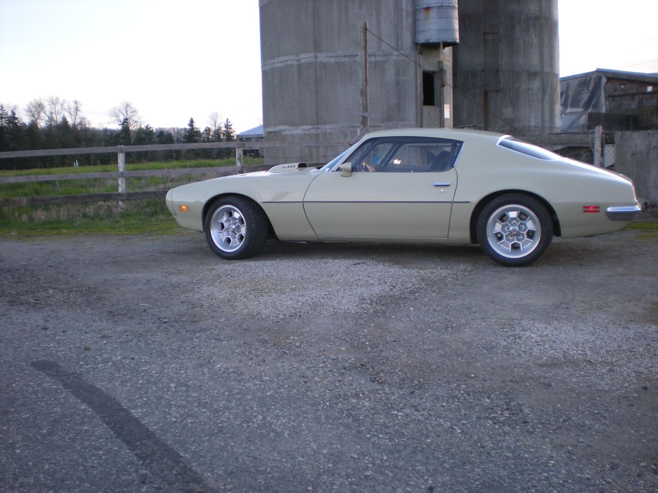

      Slightly closer pic

      Is that 285's all the way around? Can you take a pic approaching the nose but still to one side enough to see the wheels? Looking good!

      Looks good. I'm not a huge fan of the SD formula look with the shaker and no spoilers......but its a pretty car. Definitely looks like you have some negative camber......what arms do you have?

      The arms are Speedtech uppers from Blake. They definitely allowed for more caster, and fit well. IMO one of the better offerings.
