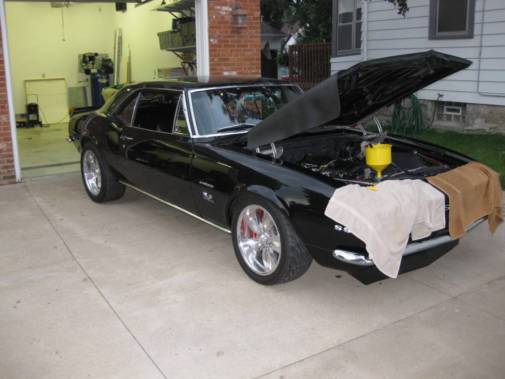

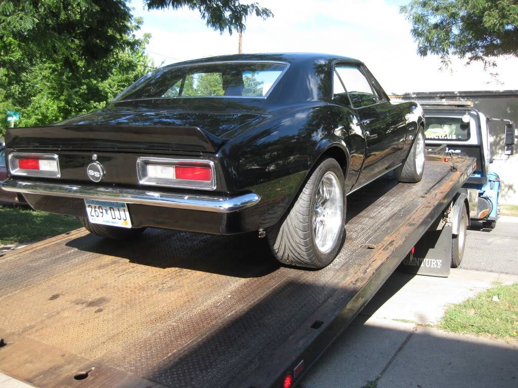

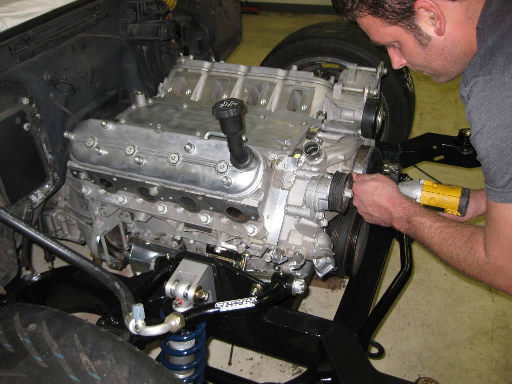

      Took awhile, but I have been busy working in the garage. 90% of the car was completed in October/November. I was able to put a few hundred miles on before winter arrived!

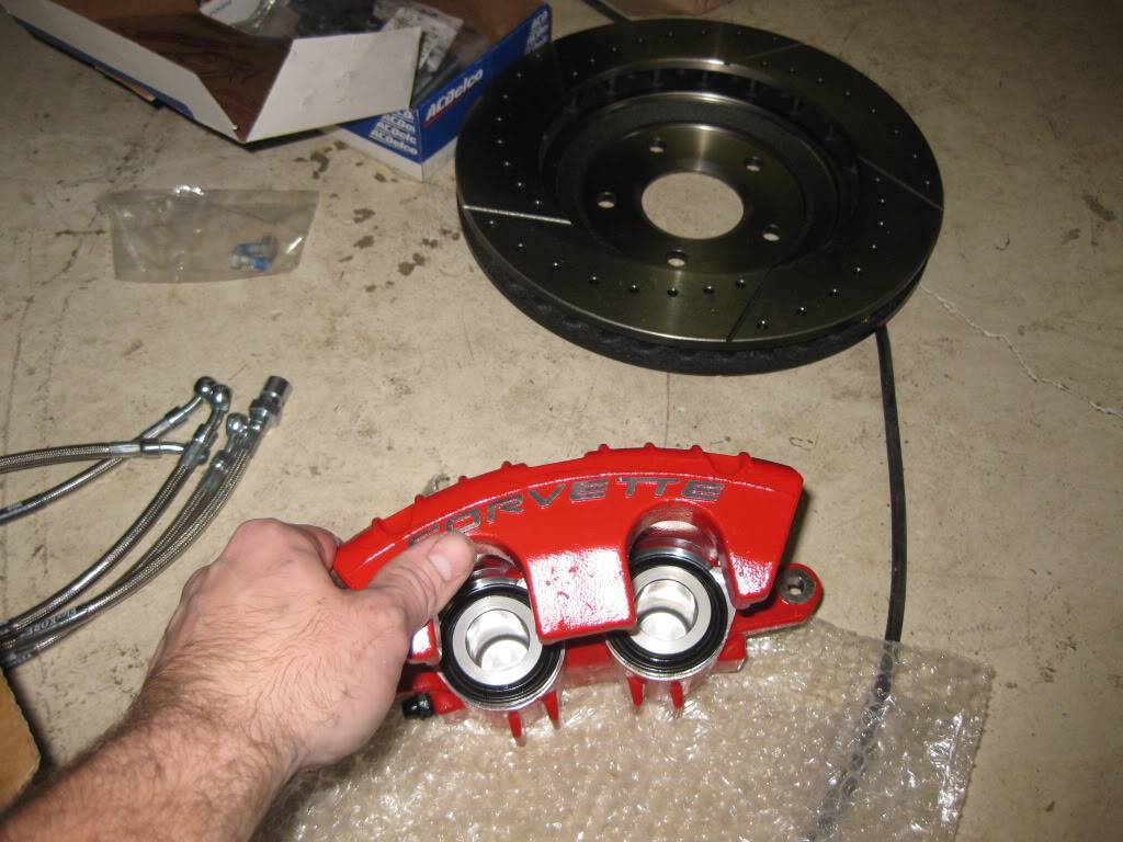

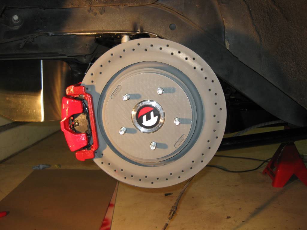

      The brakes for Tobin @ Kore 3 were perfect. Well packaged, thorough BOM, and great help on the phone!

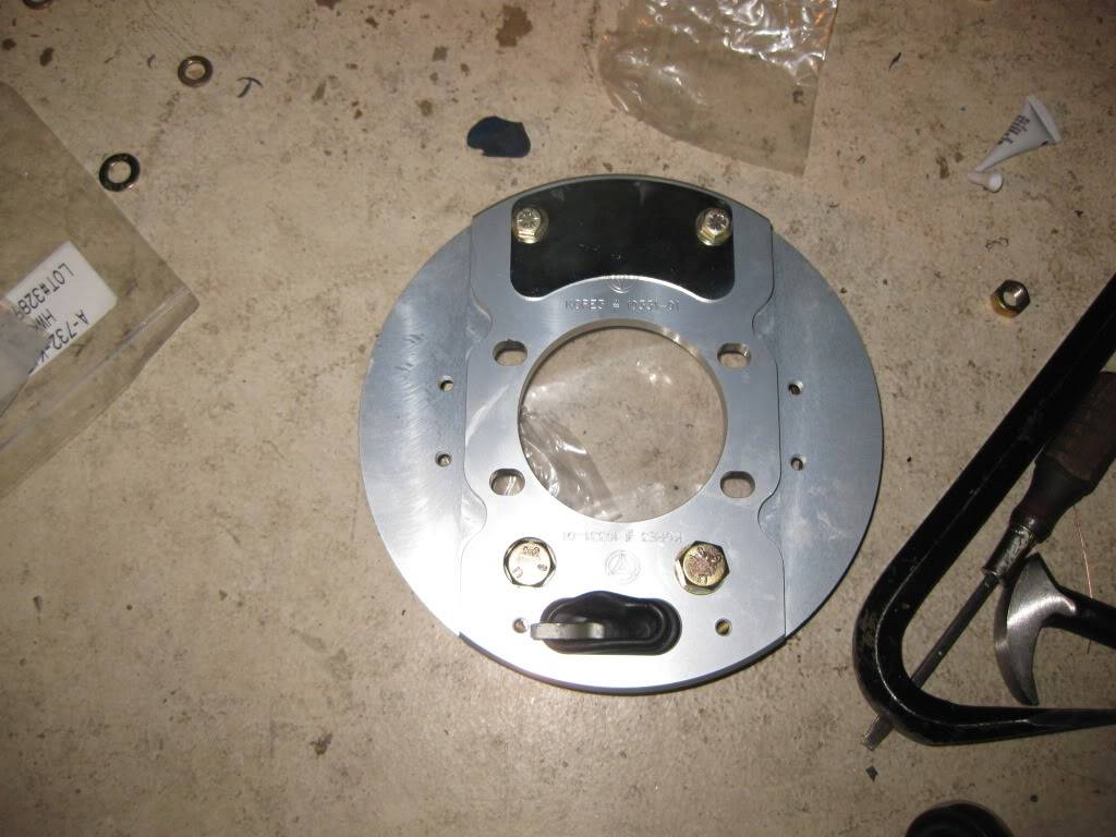

      Perfect back plates! They were a shame to cover up!
      New pan from car kraft:

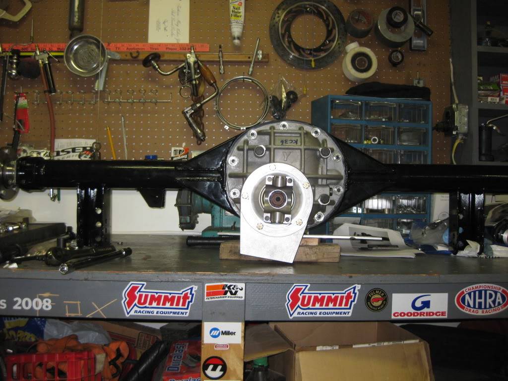

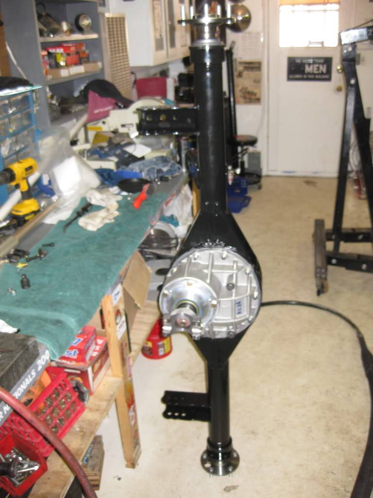

      New 9" from Quick Performance in Iowa! Great value, quality, and service (thanks Brydon)
      I did have to re-machine the pinion support--not all flanges have the same pattern (speedtech assumed a strange 3rd member, I had a Yukon gear)

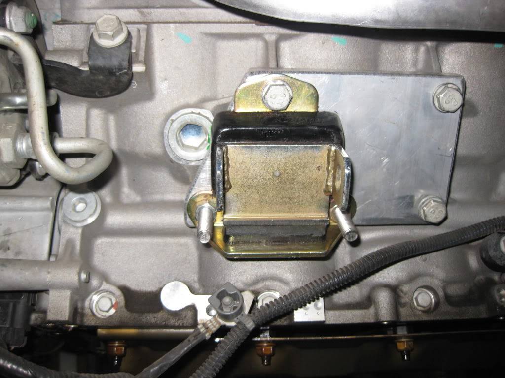

      I made custom Motor mount plates out of 1/2" alum plate:
      Installed a SS tank by Rick's:

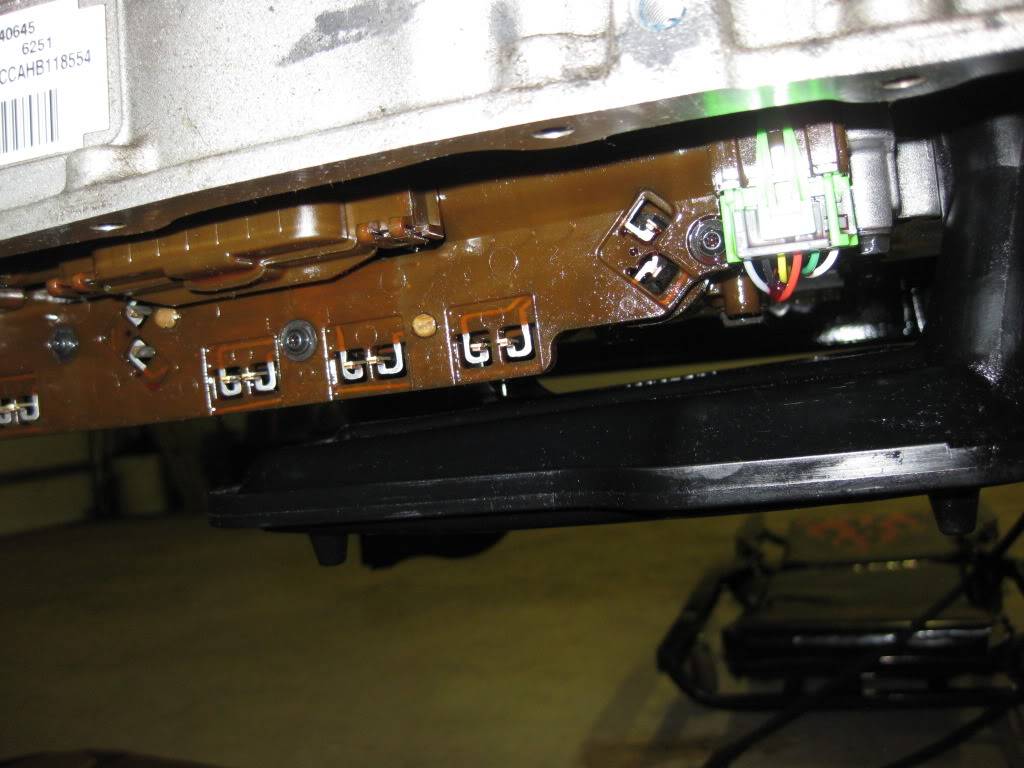

      Pulled the TCM, and had the shift points quickened by Jim Miller at Zero Gravity Perf in Phx, AZ (Jim was a calibration engr @ GM for 25 yrs).

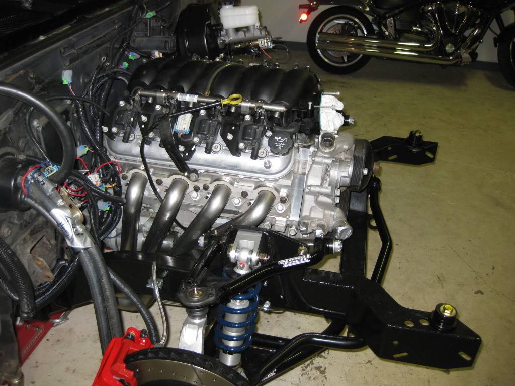

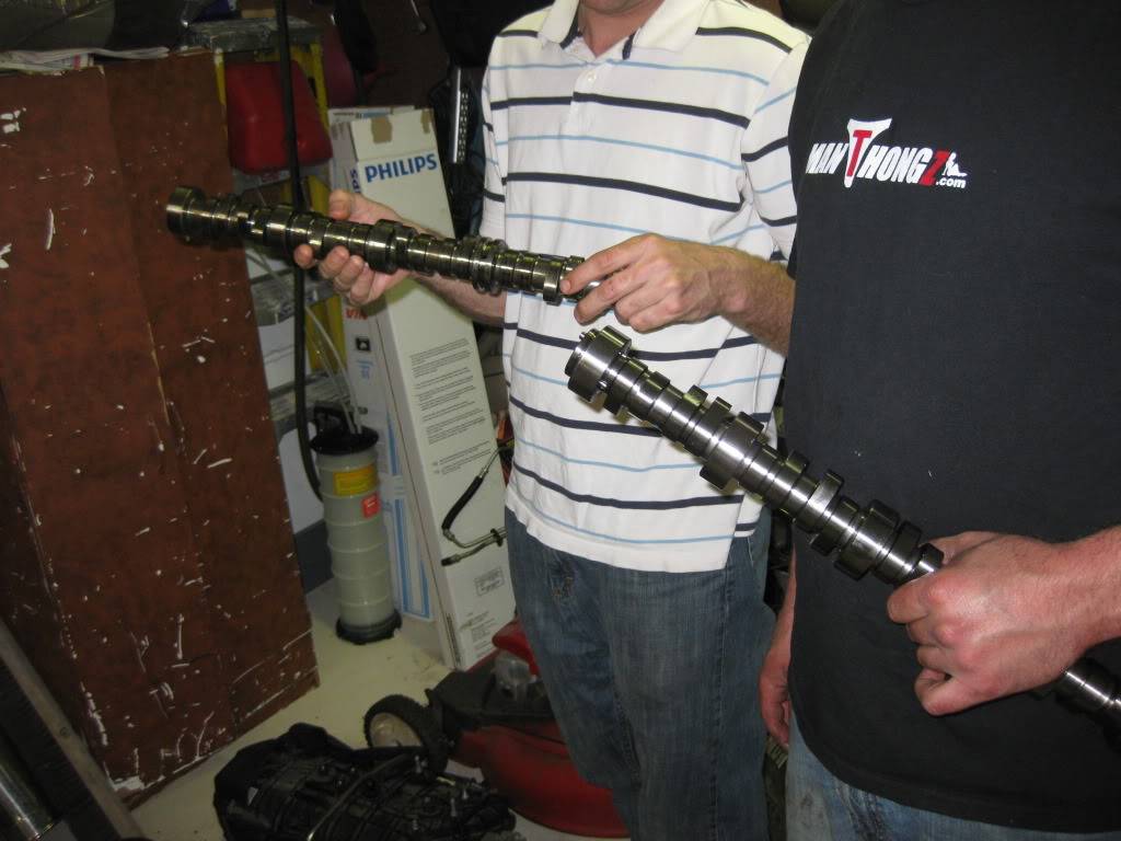

      I then went to Texas Speed and Perf:

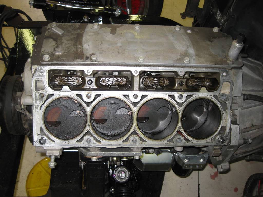

      I ordered a DOD and VVT delete kit with the largest cam I could fit without cutting the pistons:
      (jesse, my friend wearing the "Man Thong Racing t-shirt", is an LS Pro)
      I was told the motor had 1700 miles on it......seems like a lot of carbon for 1700 miles! (maybe 17k or 27K?)
      All Clean:
      Valve Springs:

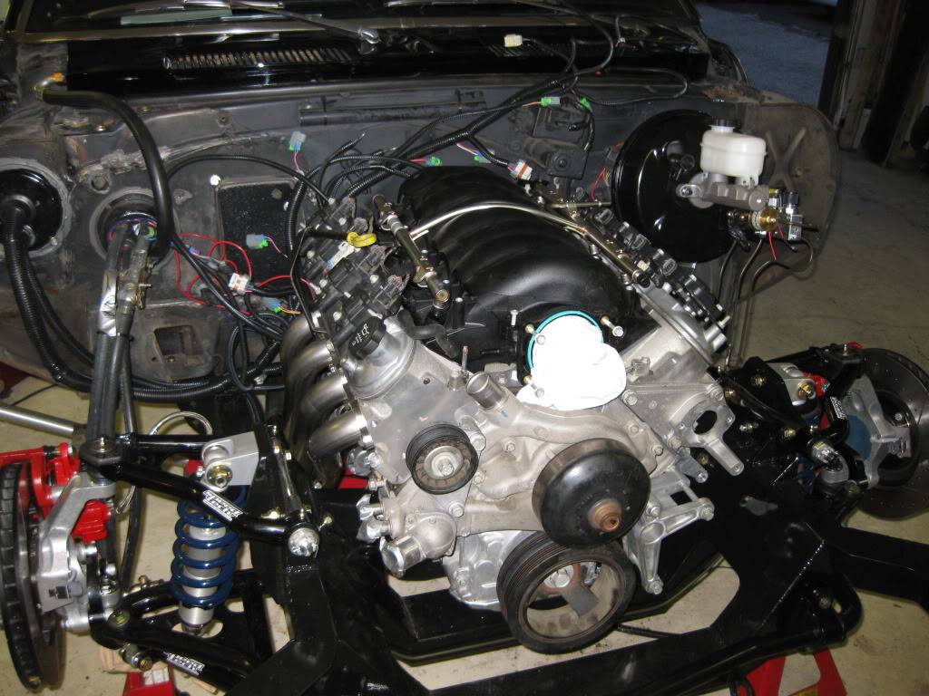

      Ended up buying a used LS3 intake....and an F-body Acc system:
      I could not help it, I had to get the headers!
      4th Gen Booster, right hand drive S10 Master cylinder (from Tobin). and the brake system was good to go!

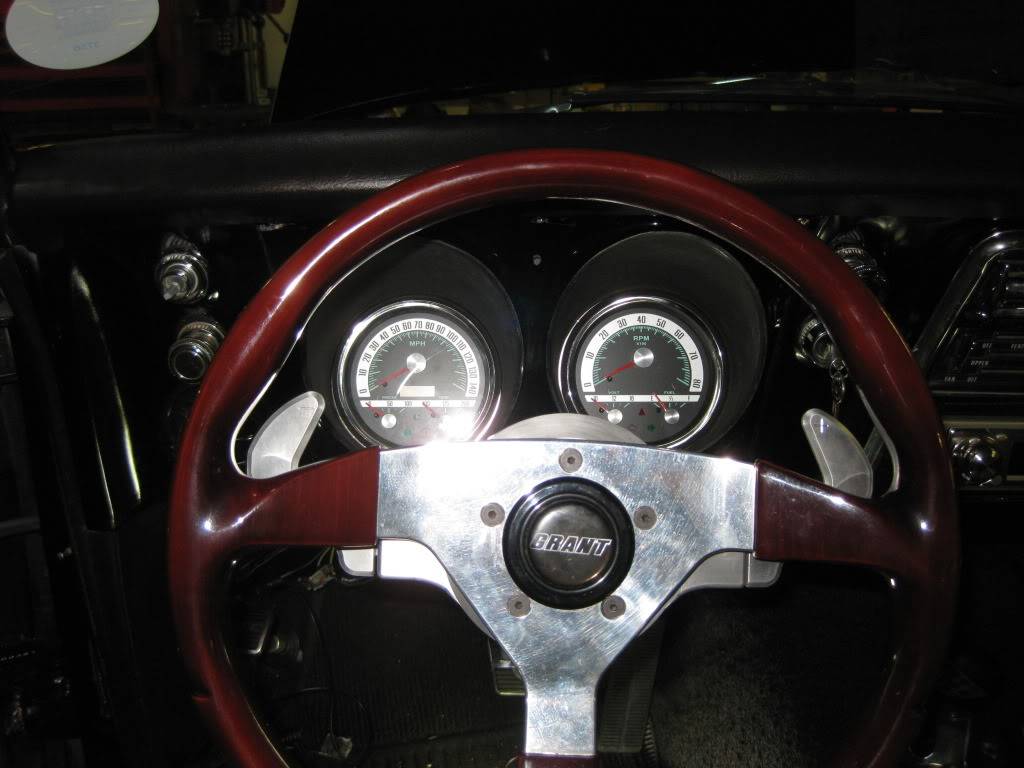

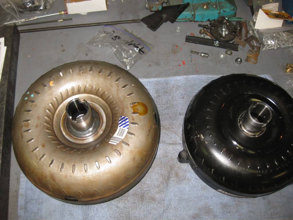

      Protorque Converter--10" with a 2800 stall (through Twistmachine---should be fun with the Paddles:
      My helper (helper actually preferred playing "Angry Birds" over wrenching):
      Paddles from Twistmachine! Thanks Steve (he was very patient, helpful, and great to work with)
      Gauges from New Vintage---very cool!

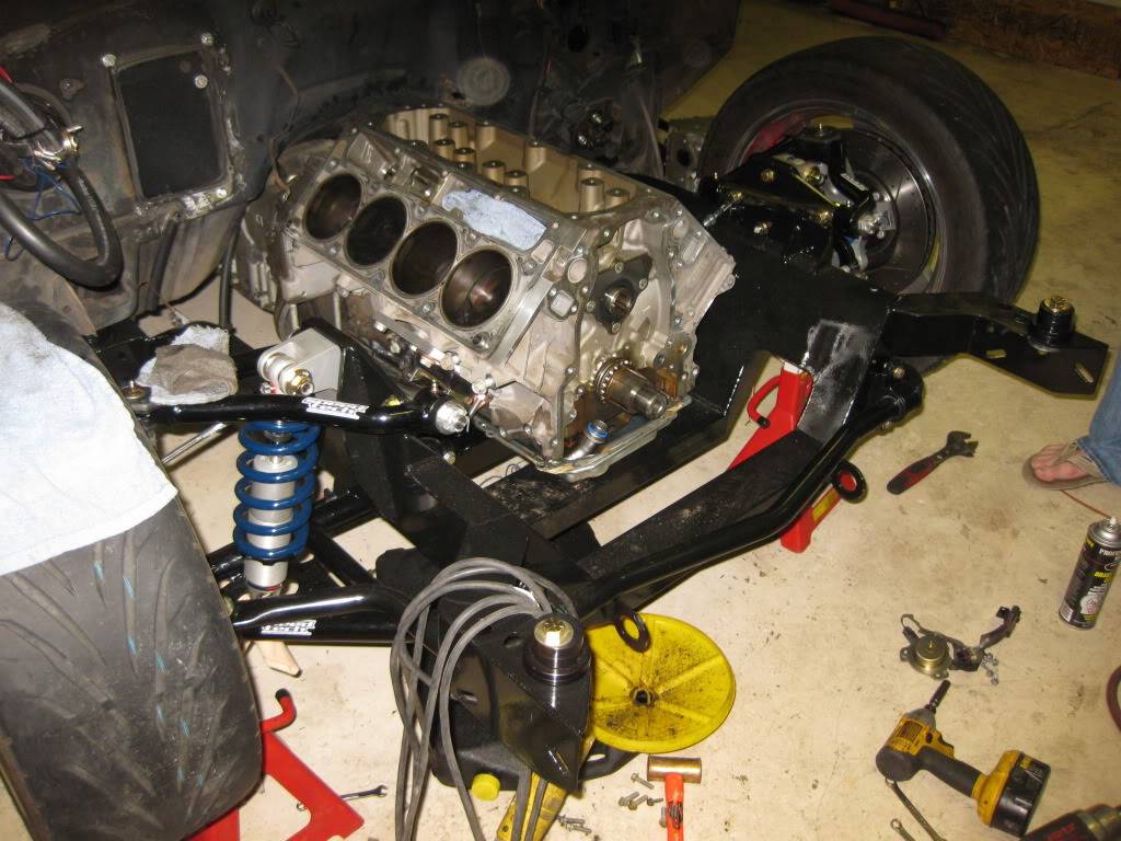

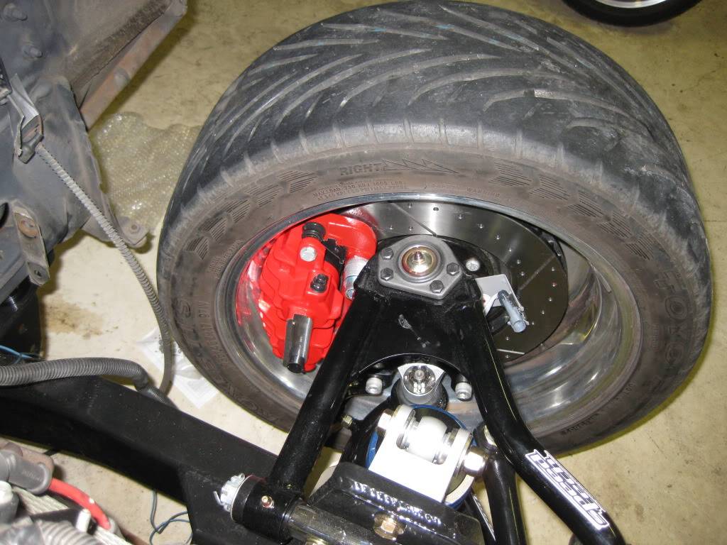

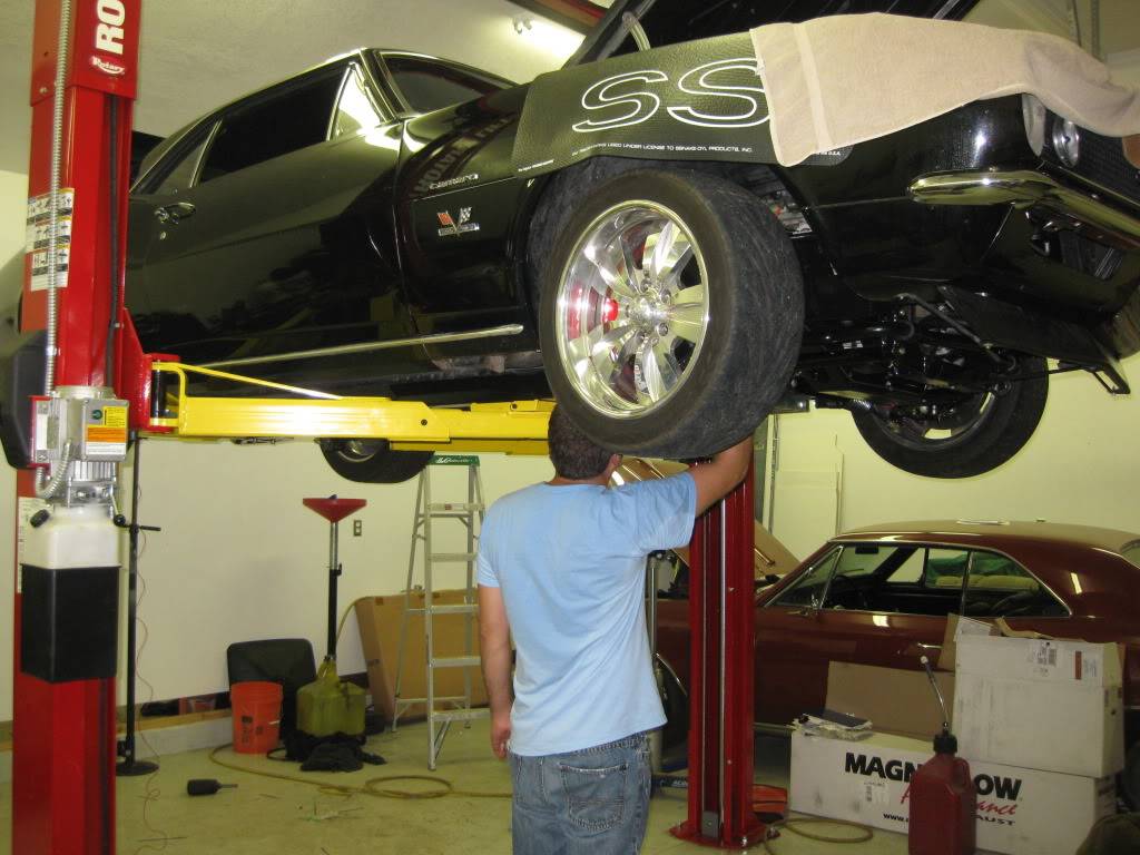

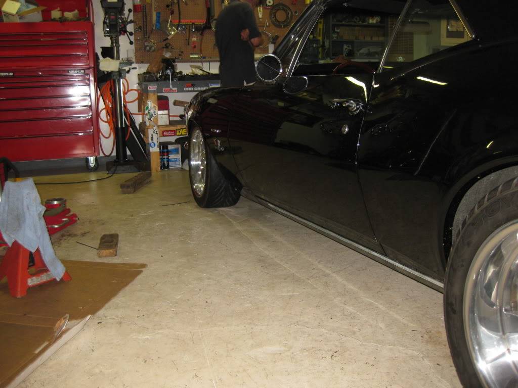

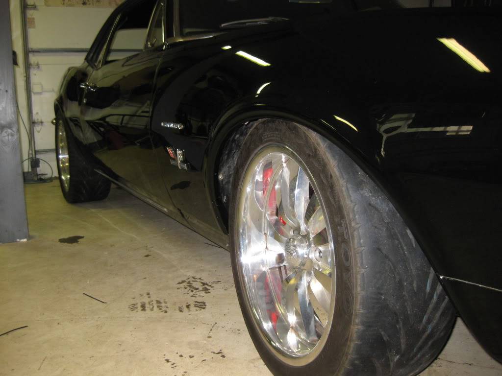

      With the help of 4 friends, the front Clip was back on!:
      Little too low for tire clearance! (had to get longer front springs from Roger @ speedtech--needed 10" instead of 8"--I also went to the 450# springs)

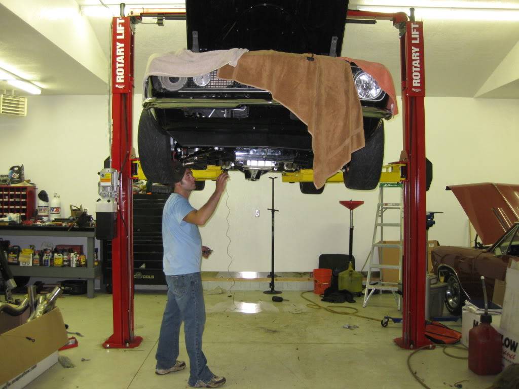

      Tuning @ Jesse's shop (can you tell it was hot?)

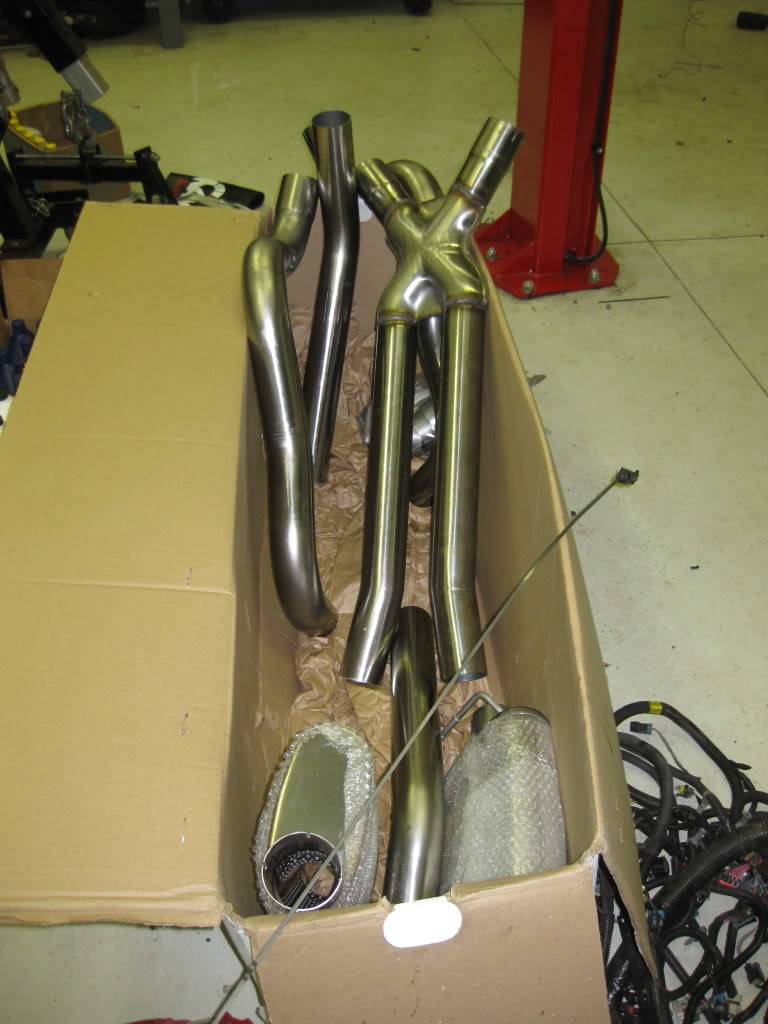

      Off to get exhaust:
      Magnaflow 3" SS system did not fit, so I had Taylor Star Automotive do a custom 2.5" system. They did a wonderful job!
      After tuning we found that the 90 degree ellbow I purchased from Steet and Perf could not be used, so I had a custom one built.
      Thanks to Gino, Andy Wicks (Dynotuneusa), Jesse, Justin, and 15 gallons of gas, we were able to get the car running great!

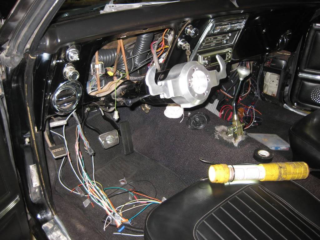

      I have some wiring, gauge calibration, and sound insulation ahead of me as well!
      Hope to have everything ready come spring time.
