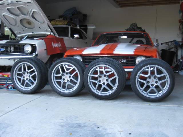

      I ran C5 wheels on my now-sold '68:
      You need bolt on wheel adapters - roughly 2" thick - front and rear. The nice thing is that with custom adapters, you can get the backspacing dead on.
      For the Z06 wheels, I'm pretty sure the fronts are tough to fit on an unmodified stock subframe, and the rears require a minitub. That said, C5 wheels are a great low cost wheel solution, particularly as a second set of wheels.

      [QUOTE=Mkelcy;791925]I ran C5 wheels on my now-sold '68:
      Those wheels look great on your '68 allthough I would have lowered it a bit more. Yeah, I've been doing alot of research on adapters. It's going to be important to pick up some quality hubcentric spacers. I found a company by the name of Motorsport Tech. They use alcoa 6061t6 billet aluminum and can custom make anything you need. He's about a two week wait though because he is currently about 200 orders behind.
      You're looking at two sets of Motorsport spacers in that picture. Great outfit and will make anything you need.
