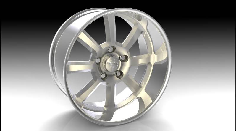

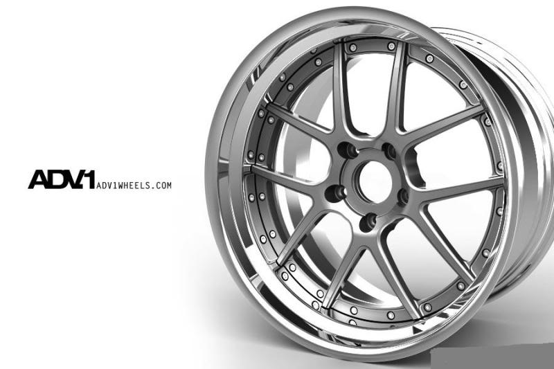

      This is the road course style that I like. Who makes these?

      ^ those look like Boze wheels, I could be wrong tho. On some of your other questions, I'd skip the white vinyl top and you should have no prob w 10 in wheels w a mini tub as long as you get the right backspace/width rear end....

      What are road course style wheels? If by that you mean, "not 5 spokes" then there are plenty of wheels to choose from. Lots of guys run the euro looking split spokes such as the boyds pt-10s or anything that looks similar, on 1st gens.

      I call them road course wheels because thats what I mostly see on the track cars. The rearend is mark williams modular 12 bolt with the aluminum bells and steel tubes. So the tubes will be made to whatever length i need.

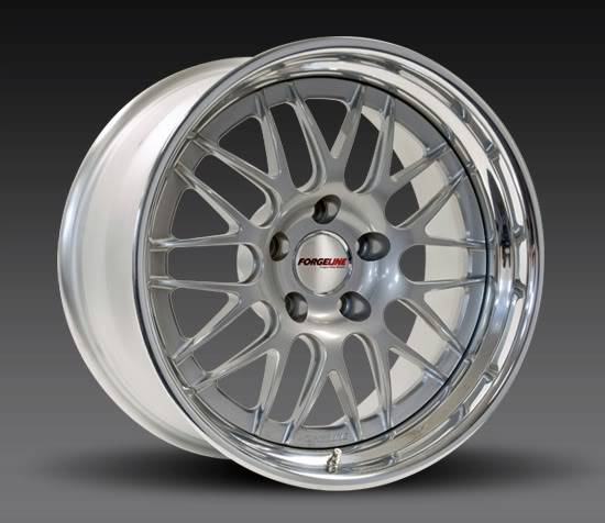

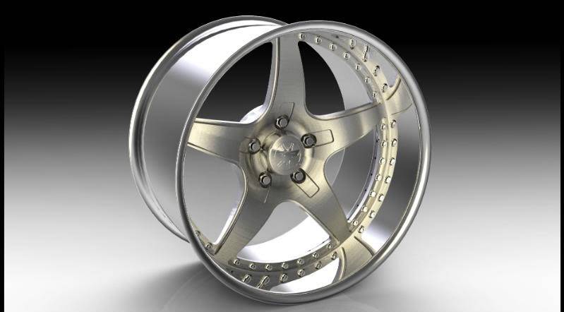

      Here are some ideas for you.

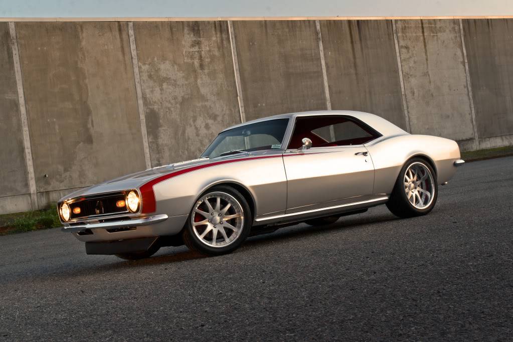

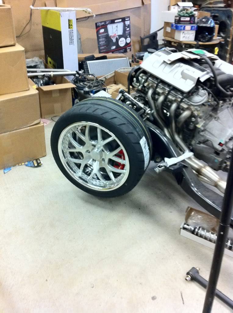

      Here's one we did 18x8s and 19x10s with a 295/35/19 out back that is quite a bit more tire than would fit comfortably in a stock wheelwell but doesn't require the big upcharge for 12s or the price of supercar tires and the difference between the front and rear tire sizes isn't enough to cause a big understeer situation like 245s and 335s.

      Tell me more about that car. Stock front suspension? Does it have a minitub? I like that.

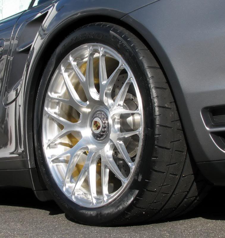

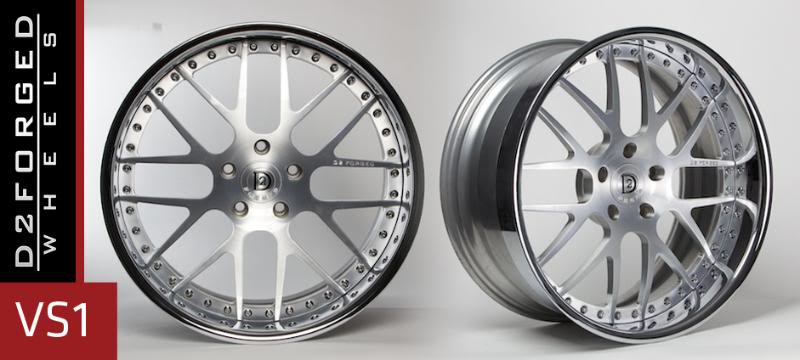

      i always raelly like these ones , but i think theyre too big for what your looking for

      Im running into the same problem. 335/30/18s arent that expensive if you get the kdw2 but im afraid to look at the price difference of a 10" and 12" wide wheel. My car is a 67 camaro dse quadralink and mini tubbed. I want a deep dish staggered setup too
      Any chance we can see a rear end shot with those 295?

      How much chrome is on the car now? If you have a lot of chrome, then I think the wheels would look good with brushed centers and polished lip. I like the first Forgeline that PTS posted.

      Stock front subframe with tubular control arms and mini-tubs out back. You could get a 305 on the 10s as well but like we talked about on the phone last week, when you go with supercar size tires, you get supercar size sidewalls which you said you weren't into so the 295/35 or 40 is really your best bet.
      Oh, and ditch the vinyl top. They're moisture traps that disrupt a car's clean lines.

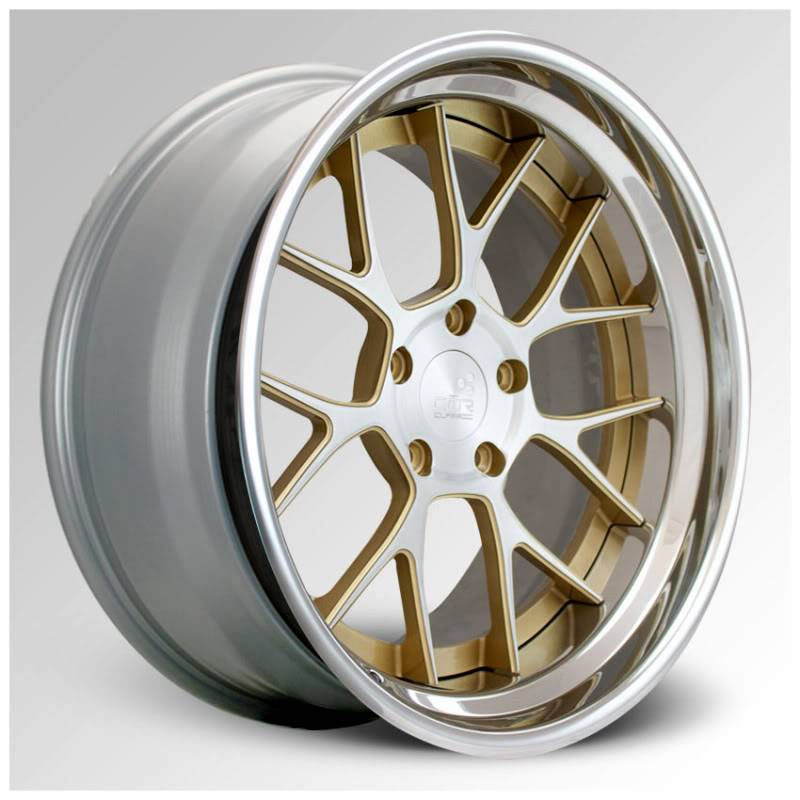

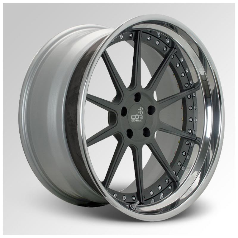

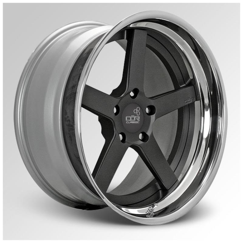

      OMFG! i say u get those CCW CLASSIC's!!
      if i could ever afford them i would!!!!!!!!
      I <3 CCW CLASSIC's......................................... ................................:heaven:
