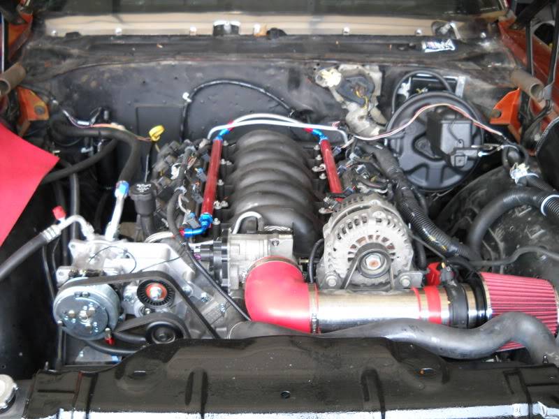

      In the "bang for the buck" catagory, the GM kit is nice. But relocating the AC compressor is often required. On my 5.3, I went with the truck alt/PS pump (free) and a Kwik performance high AC bracket ($100 when bought with Classic Air kit).
      Not nearly as pretty as the ones above, but seems to work fine.
