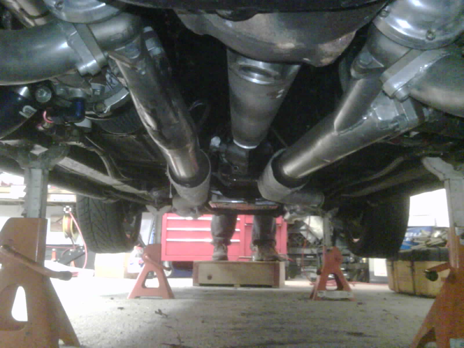

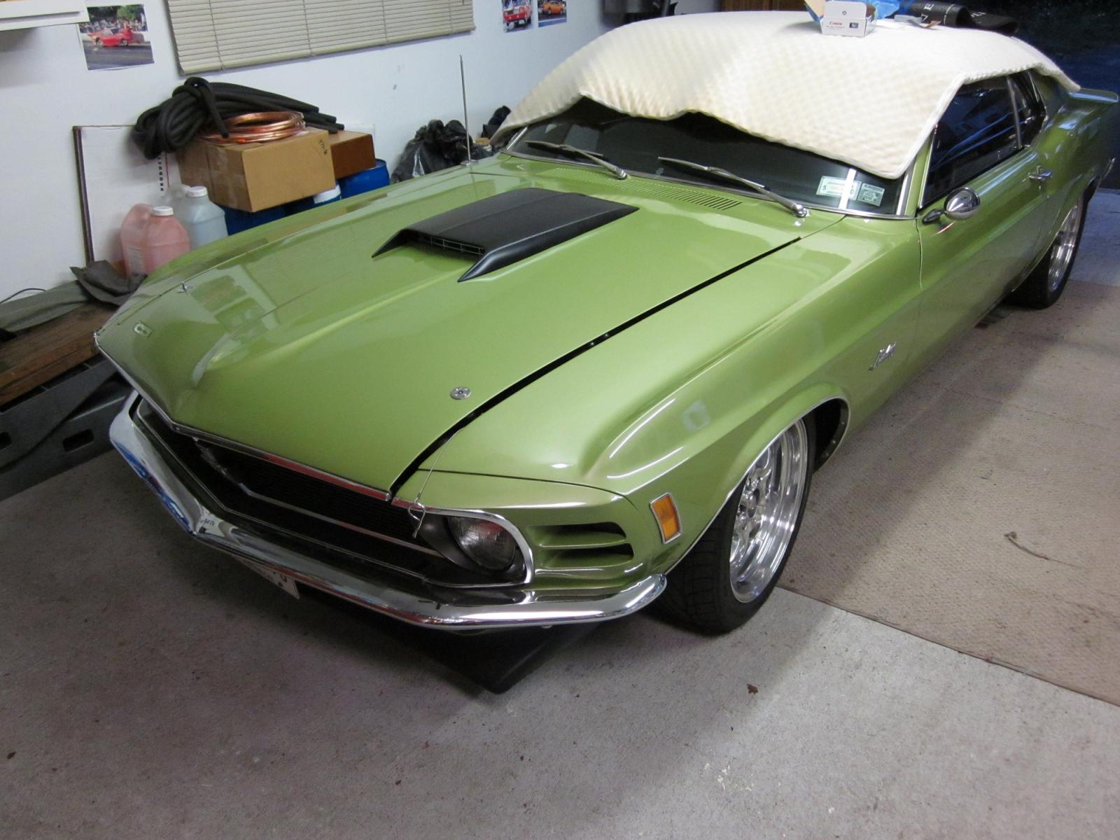

      Here is my setup its a 427 bill mitchell with accel dfi and mass flow tb iam intercooled. I dont know much about the blow thru setup

      Hot damn. That thing is the bomb!

      THanks bro its a work in progress
