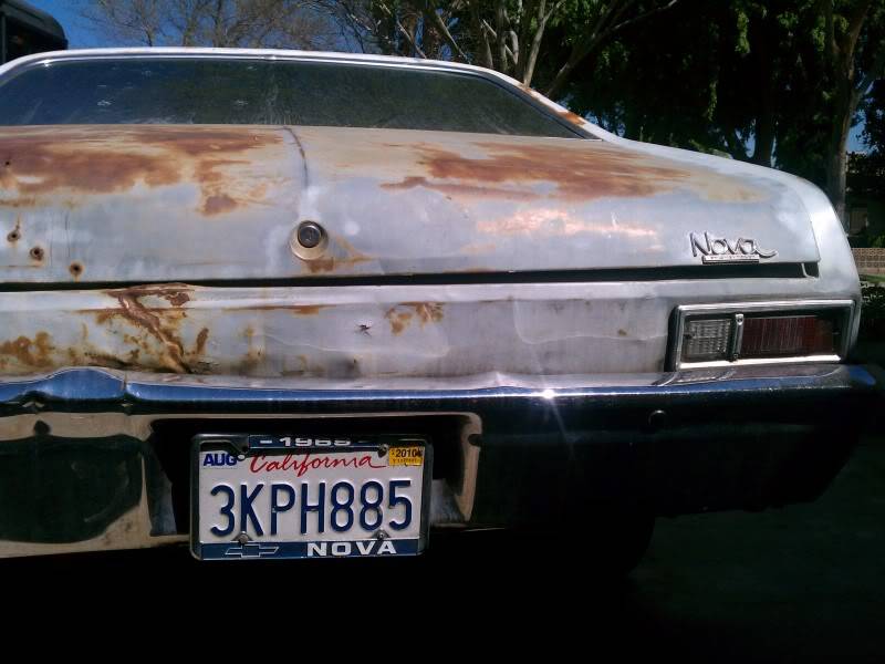

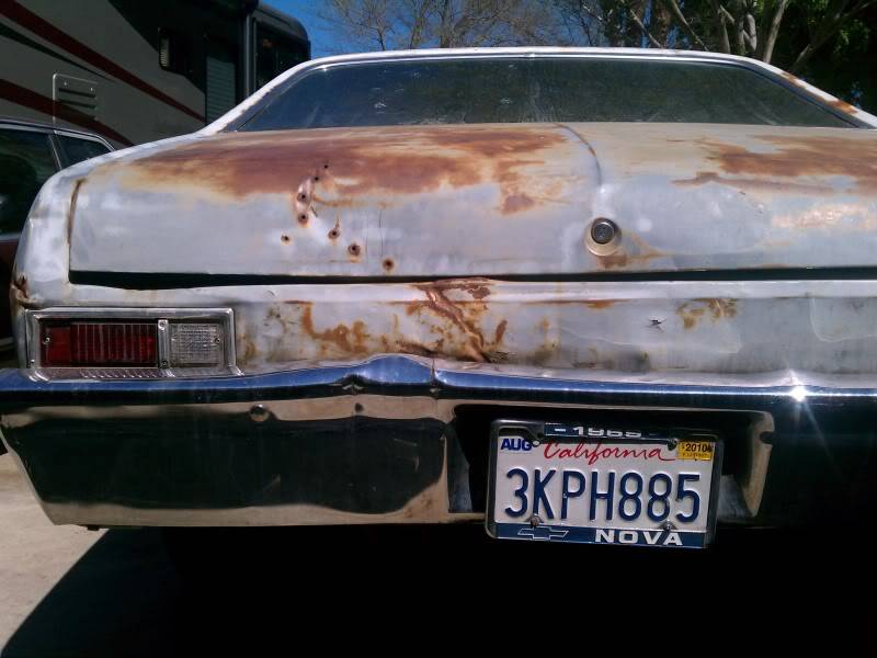

      I got rear ended a couple years ago and had a friend of a friend try to fix it. They basically had a big bottle jack thing (forget what it was actually called) and they put it against the wheelwell in the trunk and pushed the tail panel out. It also ended up poking a hole right at the corner that you can barely see in the first pic above the tail light. Then they drilled some holes in the trunk and used a slide hammer to pull it out. And then they said they were done and left.
      What I want to do is get the tail panel from a Camaro to replace this so that I can put the gas cap up between the tails. I'll have to get the trunk piece from a Camaro as well. I haven't looked to see if companies repop just that part of the trunk or if I'd have to basically buy the whole trunk floor. Depending on how hard all that is, I might just try to replace it with a Nova tail panel and do the Camaro gas cap mod later.
      Anyway, how hard do you guys think it would be for a first timer to repair that? I was planning on getting a carbon fiber trunk lid from Anvil Auto, too, if that makes a difference. Welder would be something from Eastwood. I did some reading and it seems like everyone said the recommended welder is one that can use .023 wire so I don't burn through the metal, so I was looking at this one:

      Thats kind of a trick question. It's do-able with some minor metal working skill. But the question is do you have any experience working with sheet metal and/or welding sheet metal panels? For a beginner it may take a few shots to get it they way you want it.
      You have to learn somewhere, so my advise is get a cheap panel from the junk yard and drill similar holes and then dent it up.... go to town learning on the practice piece. Hands on is the best way to learn. Also lots of good DVDs out there that will help the learning curve.

      I've never used eastwoods welders, I've always own miller and used a few lincolns. eastwood basically compares there welders to lincolns, which I have also used and did not care for. Is there anyway you can test one out? Do you have a friend that has a welder available? the reason I ask is most cheaper model welders will weld ok once they are welding, but can be a real pina to get started. They tend to not start a nice clean arc right away. So what you end up with is a bunch of ..pop...pop...pop... then its welding. Its not a good situation for sheet metal where your basically making a bunch of spot welds. But again, I've never used the eastwood welders. But for the price and warranty, it sure is tempting. I would probably try one if I was just starting out welding.
      As for the wire size. It is nice to use smaller wire, such as .023 so you can use lower settings, but 030 will work just fine as well. I would stay away from flux core wire for sheet metal work as well.
      Personally, I think you will have more issues straighting out the metal than you will spot welding the new panel. If you can dial in your settings to get consitant, fast starting arcs, you will be fine.
