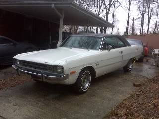

      I will start with how it looks the day i brought it home picture!

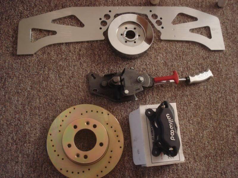

      front motor plate, SFI fluidampr, Mazda RX-7 turboII front brake rotors, Wilwood 4 piston front and rear calipers and a Hurst shifter

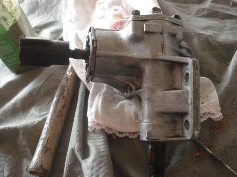

      aluminum manual steering box (will change it for a Mustang II rack later when i build my custom K member)

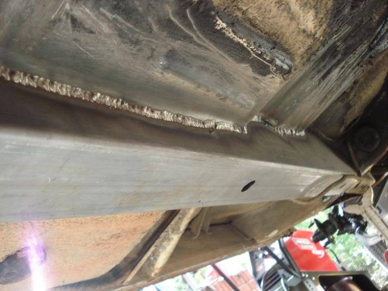

      Car tool contoured frame connectors (the best buy so far)

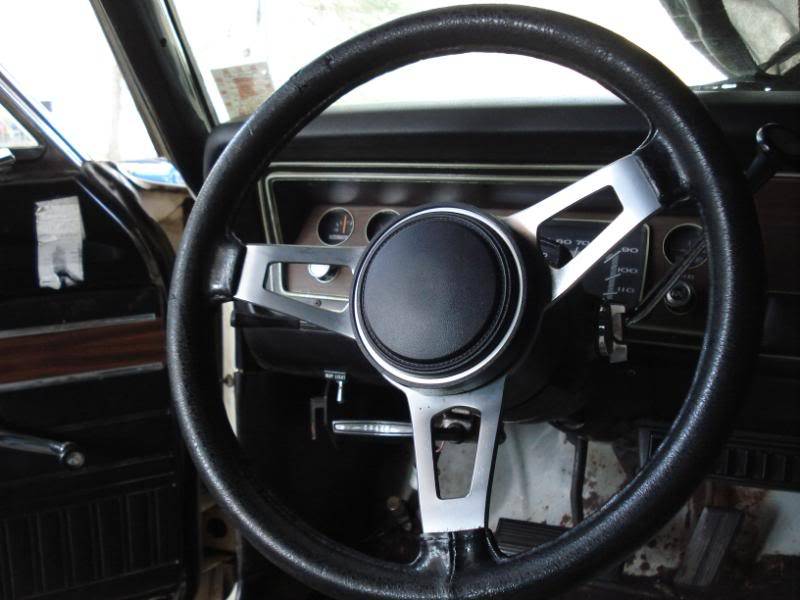

      OEM Tuff steering wheel

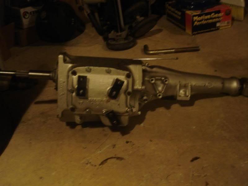

      4 Speed 833 trany

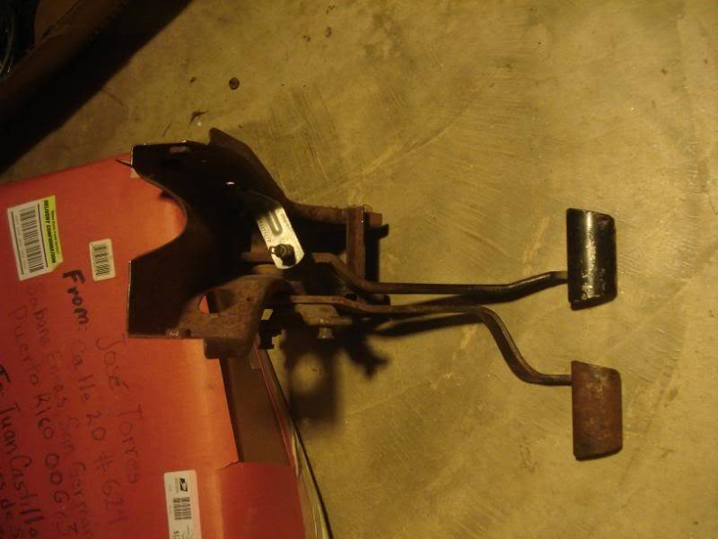

      4 Speed pedal set up

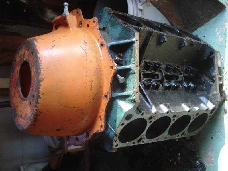

      67 440 Super Commando engine (i took it apart and only keep what i will use) plus the SFI bell housing

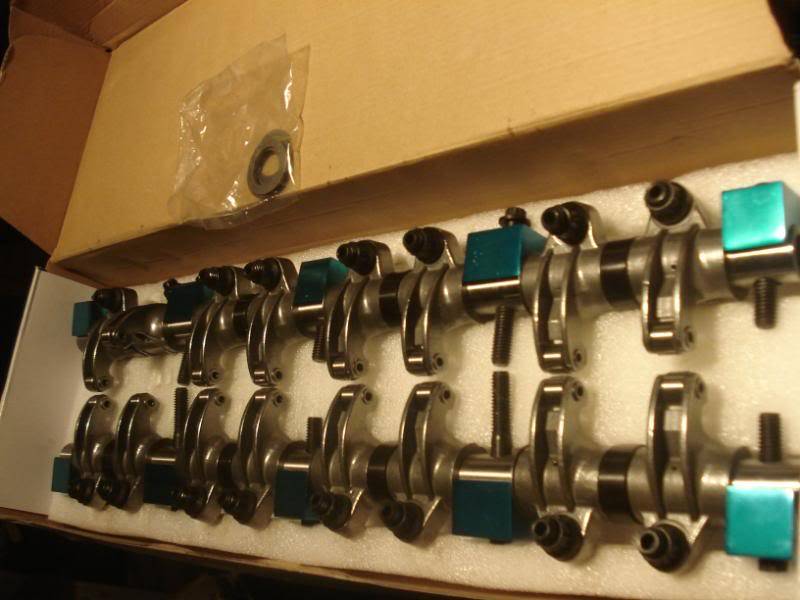

      Some Comp Cam roller rockers

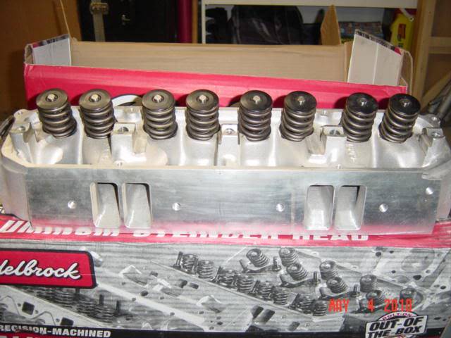

      New Eddy's heads for the 440

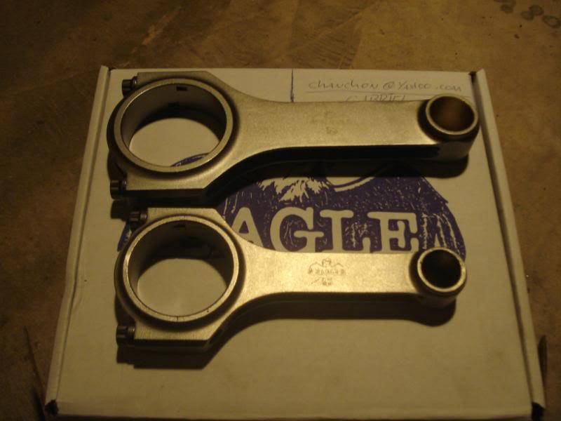

      Eagle connecting rods (look how they look compared to the Toyota 2jzGTE ones)

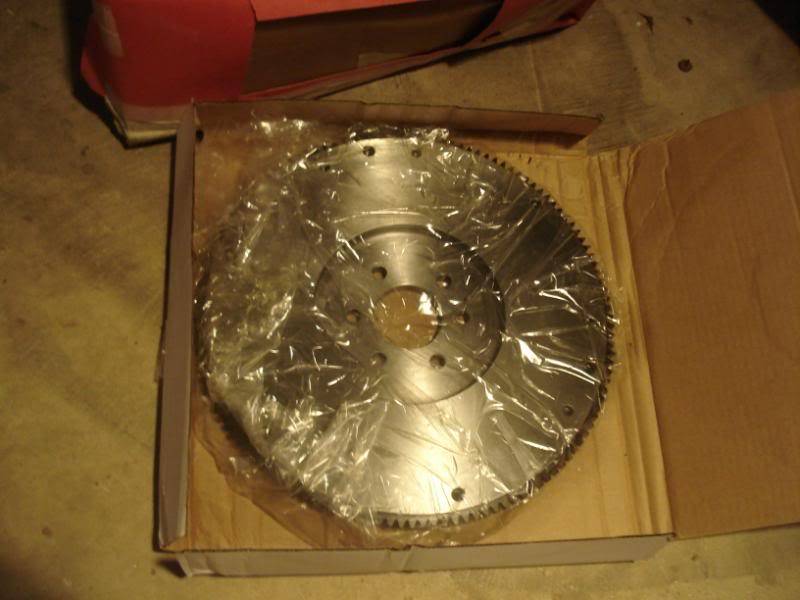

      SFI billet flywheel from 440 Source

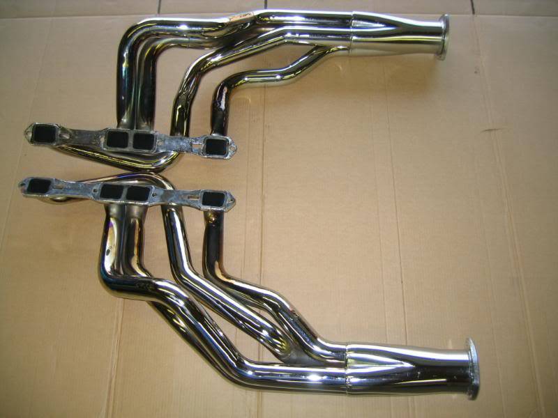

      TTI's under chassis big block headers

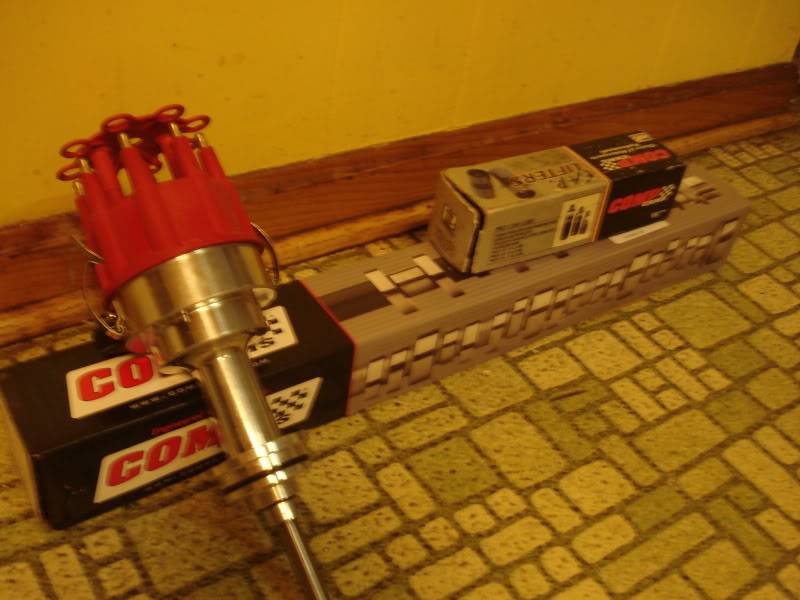

      Billet distributor Comp Cams cam and lifters
      Eddy's Victor intake

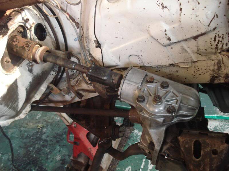

      And i swap the big bulky power steering unit and install the aluminum one (FOR NOW)

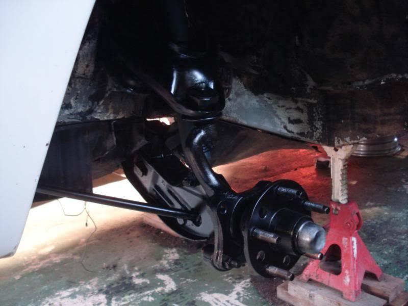

      I took out the factory front drum brakes and left the spindle and re drill the hubs from 5x4 to 5x4.5 and give a nice rebuilt to the front suspension (but got other plans for it so later more on that)

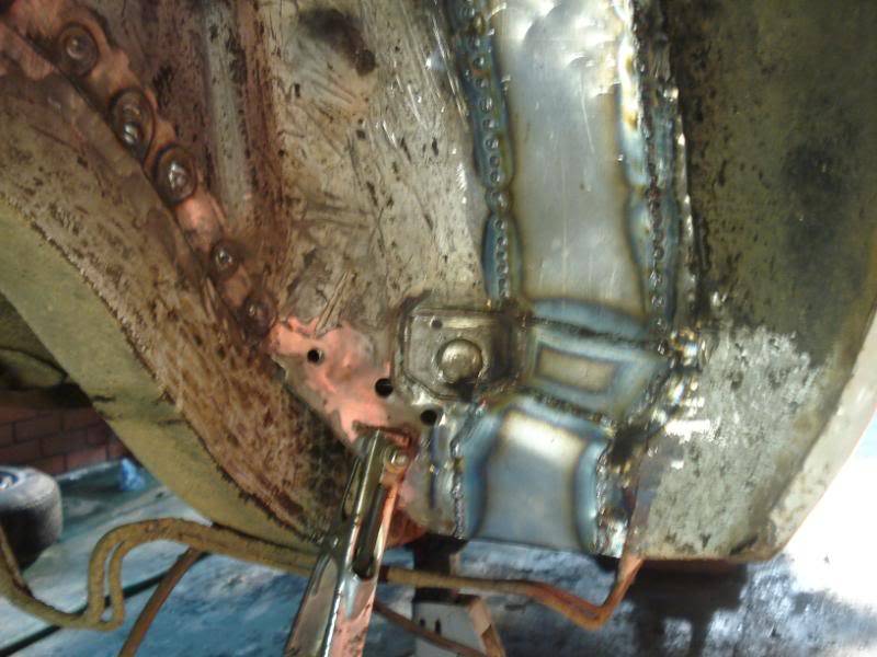

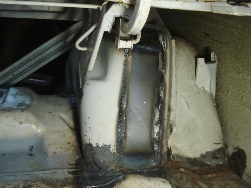

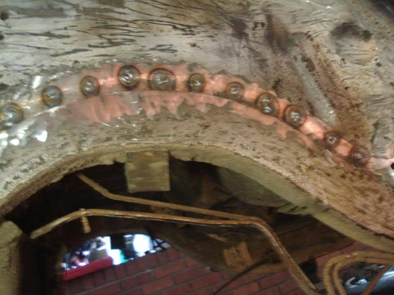

      I did the mini tub work on it to fit big tires

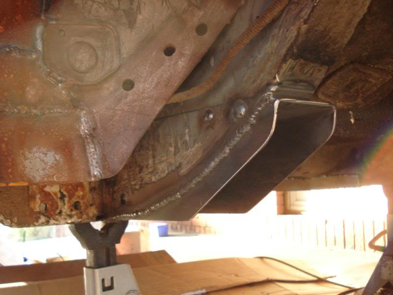

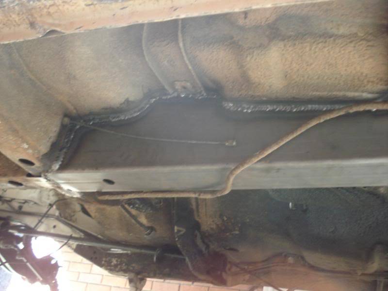

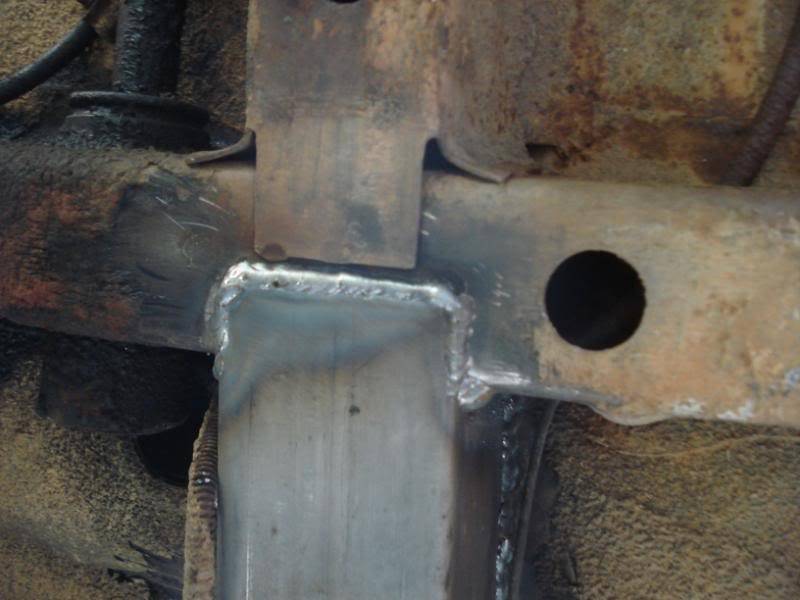

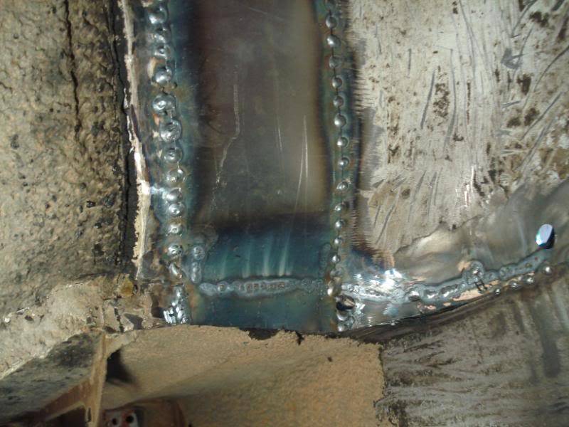

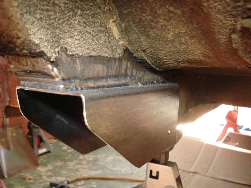

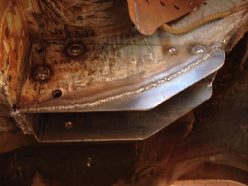

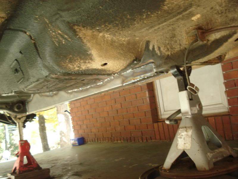

      I add the sub frame connectors

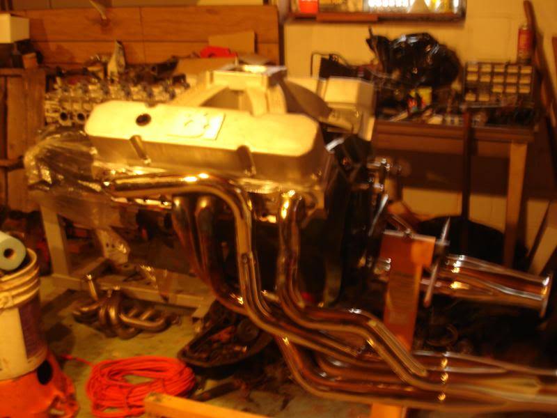

      did a little mock up on the engine, by the way B1 valve covers (crappy picture)

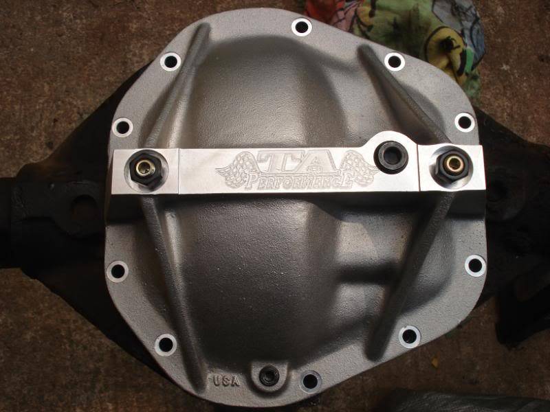

      some Dana 60 work narrowing it to 51.5 inches axle flange to axle flange 3.73 gears Detroit locker T/A cover

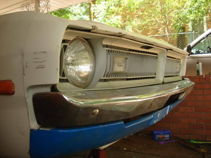

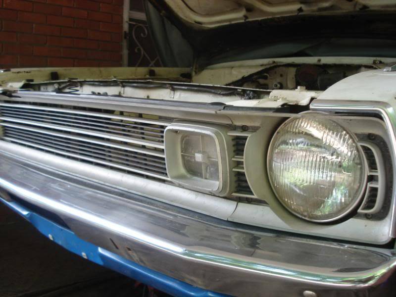

      Change the grill from a 72 to a 71 i like it better got a meaner look IMO.
      before
      After

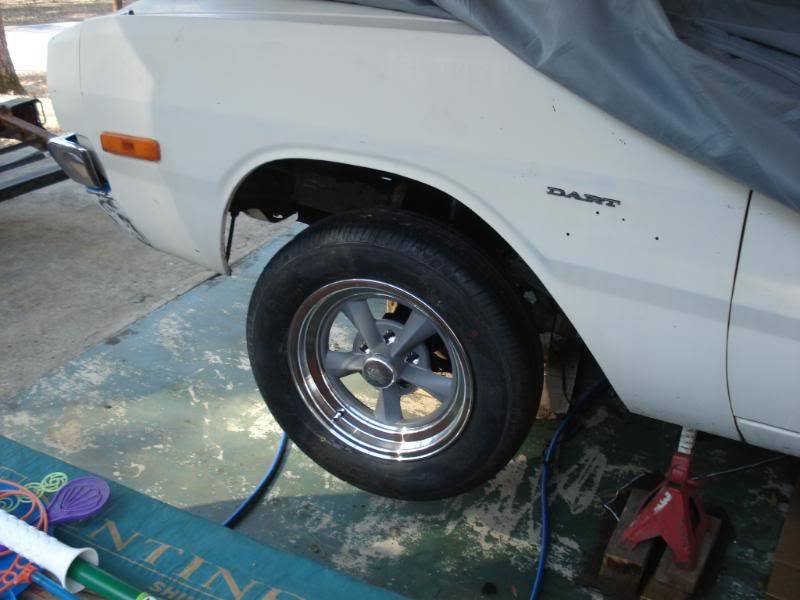

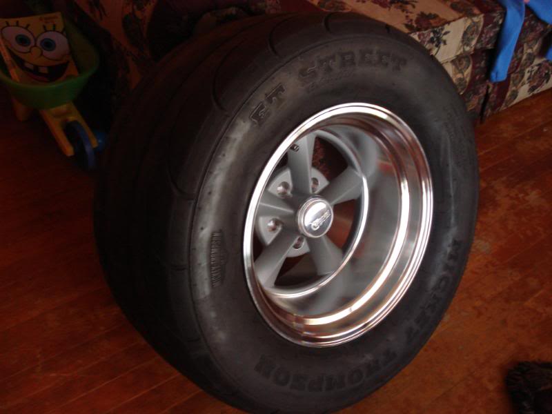

      Did got already one of the wheel set with tires Rocket Racing gray with 185 15 front tires 15x4 and Mickey Thompson DR 325 50 15 on 15x10 4 inch back space wheel
