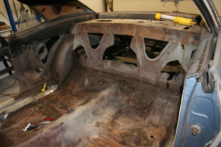

      Here's a couple pics after getting it home and starting to disassemble it.
      Attachment 45589Attachment 45590
      During disassembly I found that the original subframe had been curbed hard underneith and squashed the subframe on the drivers side. So I jumped on here and put a want ad for a subframe. I found one locally and got it POR15 coated.

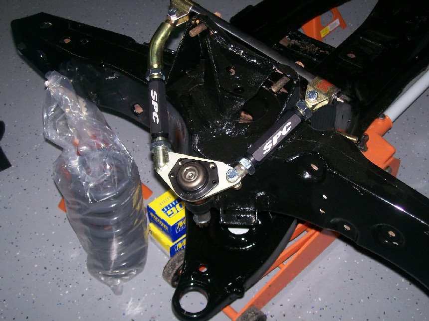

      After doing some research and talking to SC&C, I decided on their upper a-arm kit (tall bjoints), my stock lower arms, and Hotchkis springs.
      Name:  4s subframe assembly 2.jpg

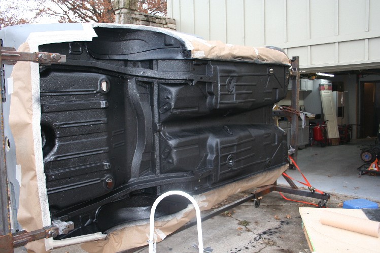

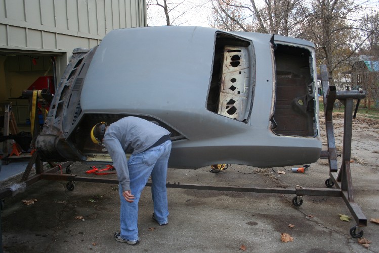

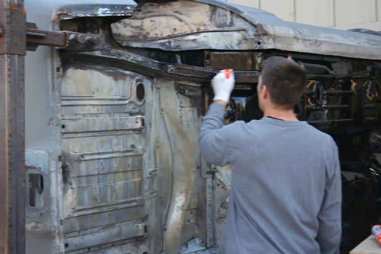

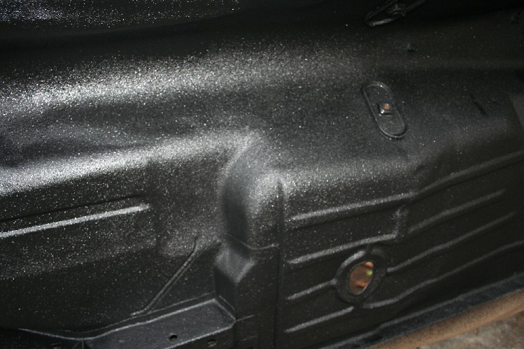

      I found a rotisserie locally and put the body up on it. Once I scraped, degreased, wire wheeled, sanded all the crap off the underside of the car, I decided on POR15 with a top coating of Raptor liner.
      Name:  10s POR Bottom Floor.jpg
Size:  84.2 KBName:  13s Undercoating sprayed.jpg
Size:  114.3 KBName:  5s rotisserie mount.jpg
Size:  111.9 KBName:  15s Undercoating.jpg
Size:  104.3 KBAttachment 45598

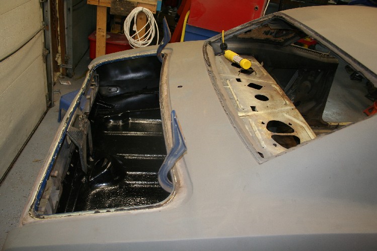

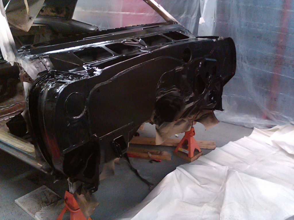

      After I got it back into the garage and off the rotisserie, I started wire brushing the trunk. It was pitted quite a bit, but no major cancer. I POR15 the trunk and plan on spraying raptor in the trunk when I coat the front inner fenders at a later date.
      Name:  16s Trunk POR - Off rotisserie.jpg

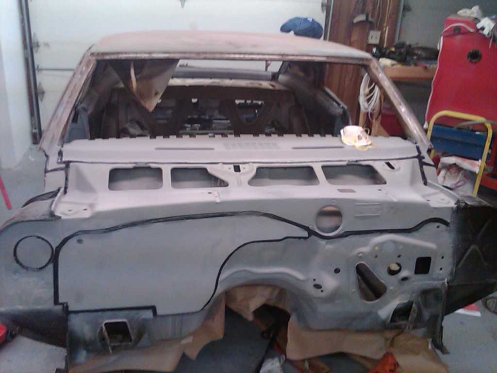

      I tried a couple different types of seam sealer and didnt like them. I surfed lots of forums and found a urethane caulk from Home Depot that worked really well.
      Name:  20 Firewall Seamsealed.jpg

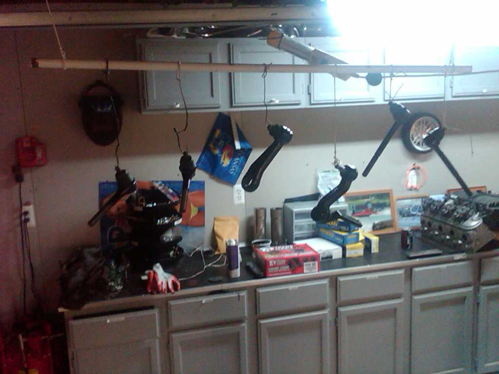

      I POR15'd all the front Moog steering parts and bolted them on the car.
      Name:  32 Steering Parts Coated.jpg

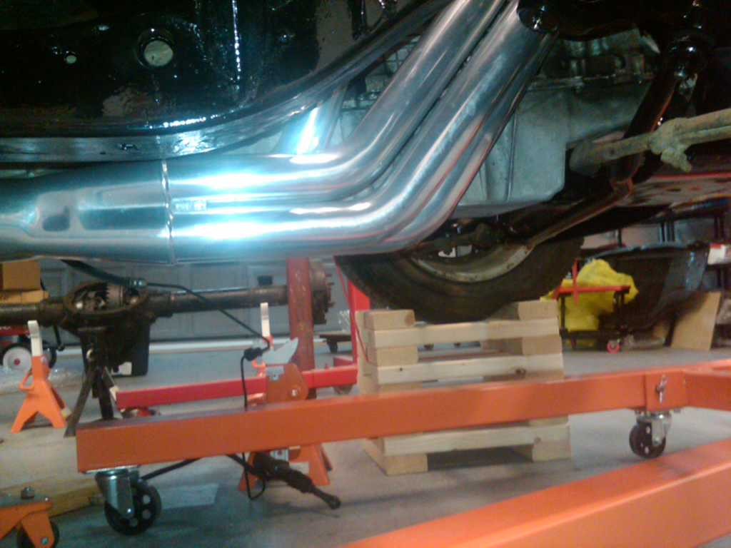

      Over the weekend I scored a GTO T56 with 12k miles. A local guy is putting a ls2 in his 34 ford and couldn't use a buch of his stuff. Finally I'm on the winning side of a deal...... I got the GTO radiator and fan setup, all the LS2 GTO accessories, al the clutch hydraulics, pressure plate, clutch, a few performance parts, etc.
      My hopes were short lived on the oil pan and mounts unfortunately. I removed the GTO shifter, bolted the trans on and a spare LS1 head I had and set the engine back in. I also bought an IROC sport steering box so I could mount my pitman arm and verify the steering. The mounts put the pass head about 1/4" from the firewall (way too close for me). And my steering was now only 1/2" from the unmodified pan. I am eyeing the MAST pan, but we'll see. I did buy a set of Dynatech coated headers from a forum member and they look good. Ignore the old tie rod setup. The Edelborck sleeves I got for steel had boogered threads, so I had to throw the old ones on for mock up.
      Name:  40 Engine tranny test fit.jpg
Size:  118.7 KBName:  40a Engine tranny test fit.jpg
Size:  42.1 KBName:  40b Engine tranny test fit.jpg
Size:  105.8 KBName:  47 Engine tranny test fit.jpg

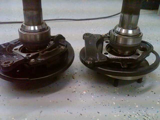

      On Sunday I started to work on the front hubs for the F-body LS style front brakes. I stuck them on the lathe and started making chips....

      one thing you might want to check shannon.The drum hubs you machined,make sure to mock them up with bearings on the spindle and run a dial indicator on the face of the hub were the rotor rides on. mine ran out about .015, so make sure you do this step or youll get some pad knock back...maybe.alot of guys do this mod but dont do the proper steps to machining them true.

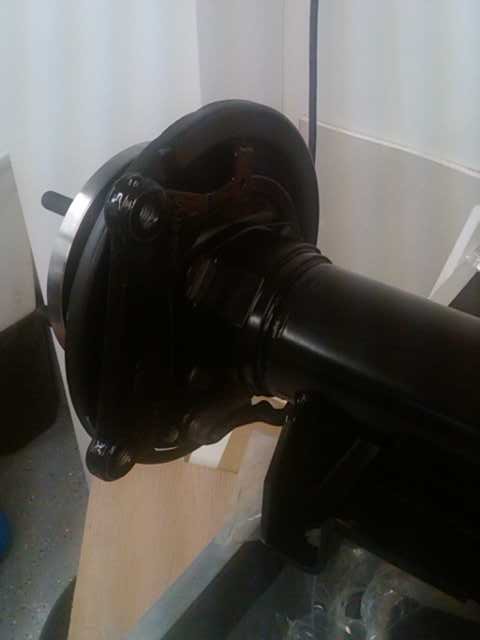

      After it was all in and sealed up, I test fitted the rear 02 camaro brakes on my 9" rearend to make sure the rotor would fit over the axles. Rotors still need to be cleaned and pads installed but, it looks great.

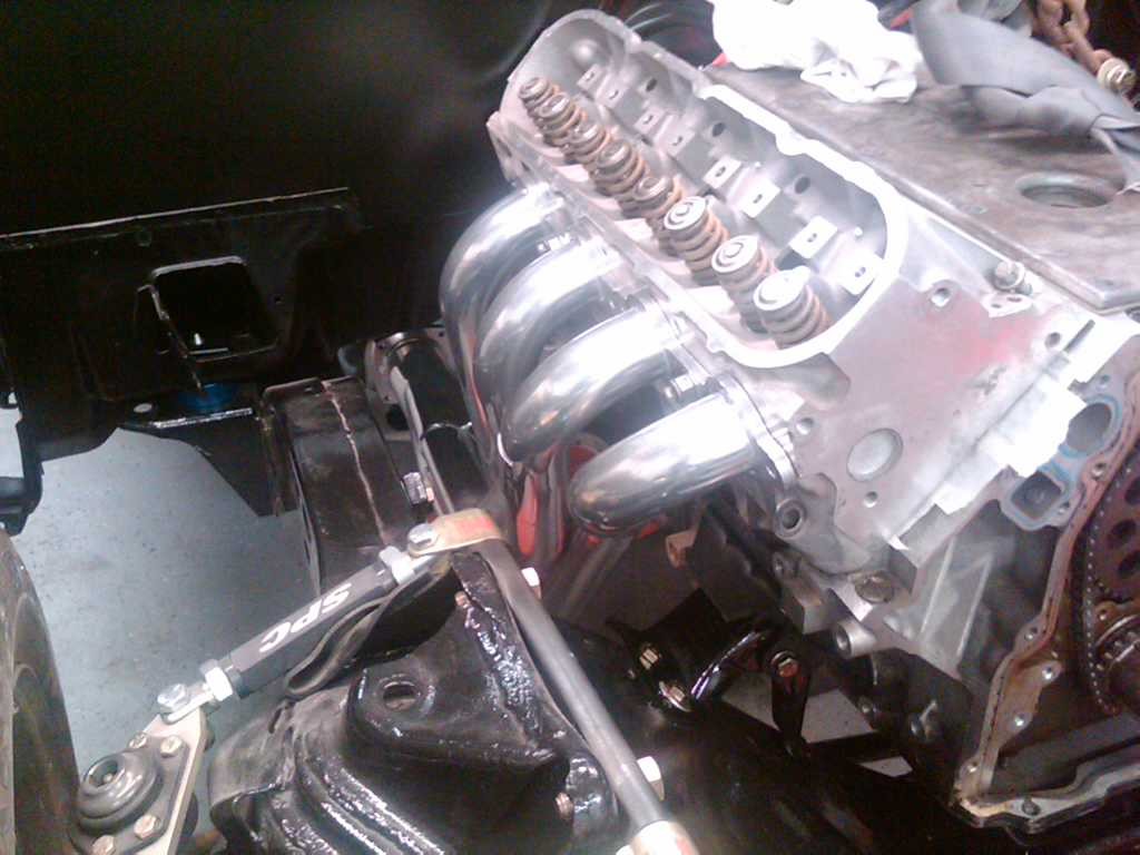

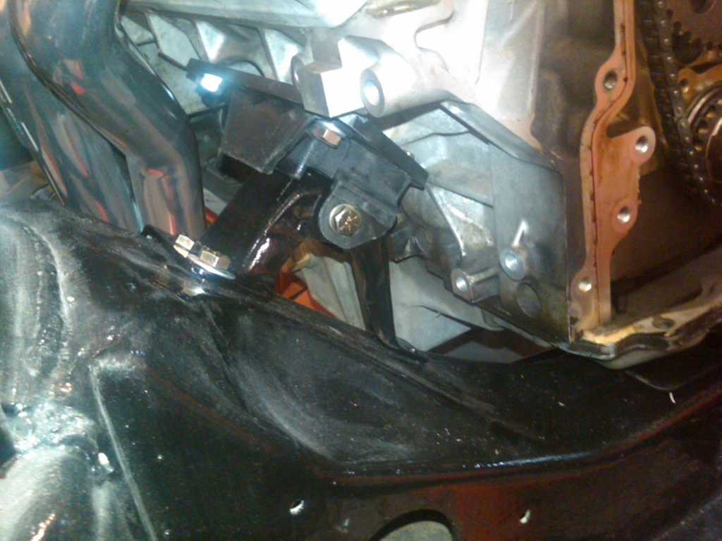

      If you're still planning to use the Dynatech headers, make sure you flip the motor mounts upside down so that the tabs are on the bottom, as seen in this picture of ridetech's Velocity Camaro. That way you'll gain almost an inch of ground clearance. I had the motor mounts mounted like you have and the headers were dragging the ground.
      https://www.pro-touring.com/threads/...493#post372493
      Good luck with your project.

      Quote Originally Posted by 67CamNKC View Post
      My wheels and tires will be here in a few weeks so I will finally get to see how low the headers hang. I read your swap thread (very cool!). I will go ahead and swap the mounts. By raising the engine, did you have any trouble with trans tunnel clearance or drive line angle too steep?
      No. I used the same trans mount (Bowler) and motor mounts (DSE) that Dynatech used (also outlined in the instructions). It's tight in the tunnel but not touching. I would add some kind of head reflective tape at the trans tunnel when you have the engine/trans out.
