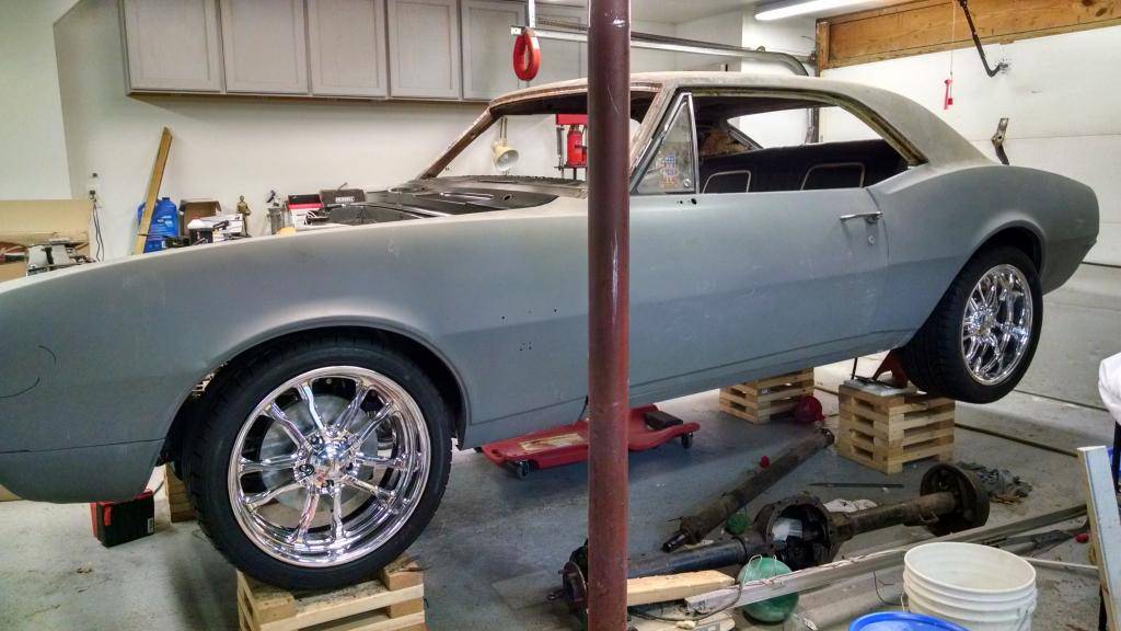

      After finally giving up on Centerline after 12 weeks of continuous delays and extended back orders, I decided to go with Budnik Chicane wheels. While they were still behind several weeks, I did receive the wheels. Man are they nice! I decided to go on up to 18s. I also ordered BFG Comp-IIs to go with it. Final wheels sizes are 18x8 on the front and 18x9 on the back. Tires are 235/40 on the front and 275/40 on the rear.

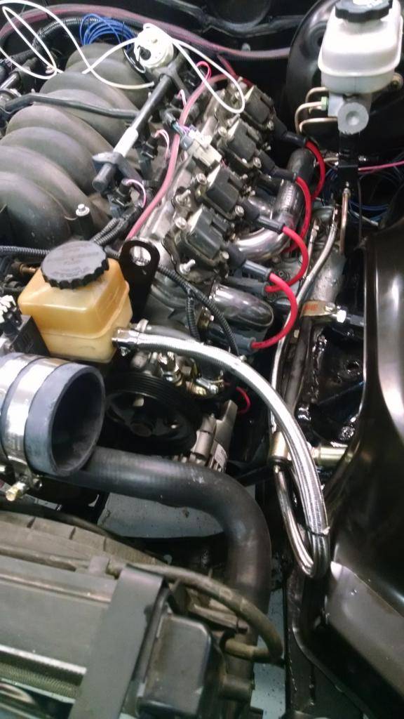

      I was also able to finish the -6AN power steering lines that go from the LS pump to the Iroc steering box.

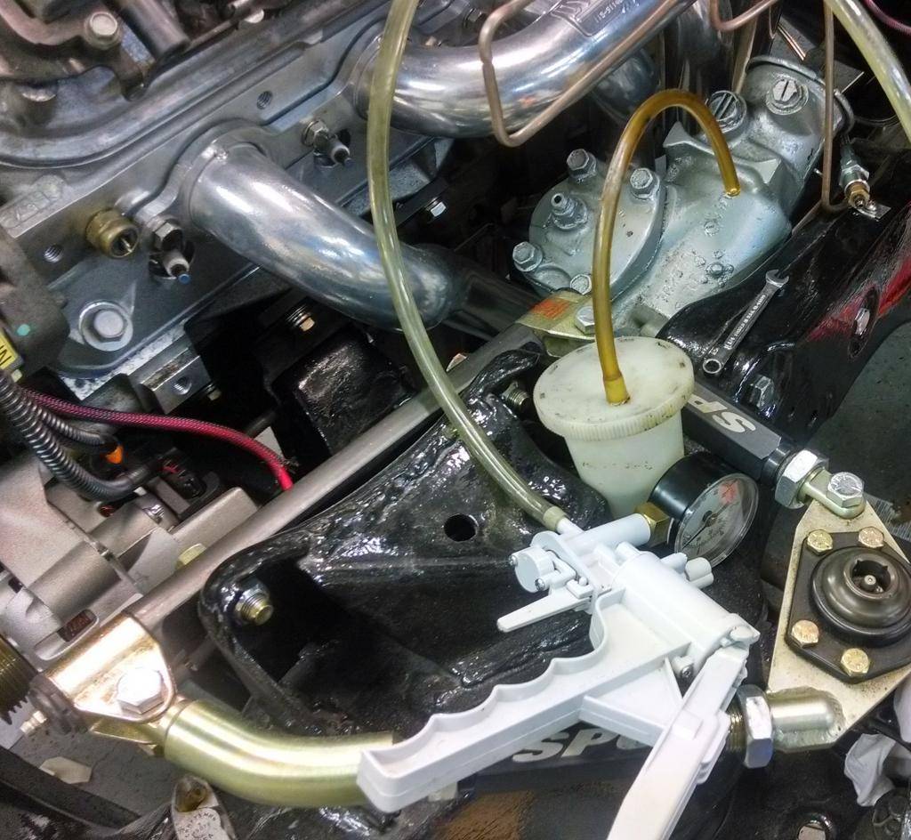

      I am still struggling with getting the air out of the clutch system. The small bleeder screw either is letting my vacuum pump suck air or I have a leak somewhere. I keep putting fluid in and it keeps coming out with air bubbles. I also pressed the clutch pedal and no disengagement of the drive shaft so there's still an issue.

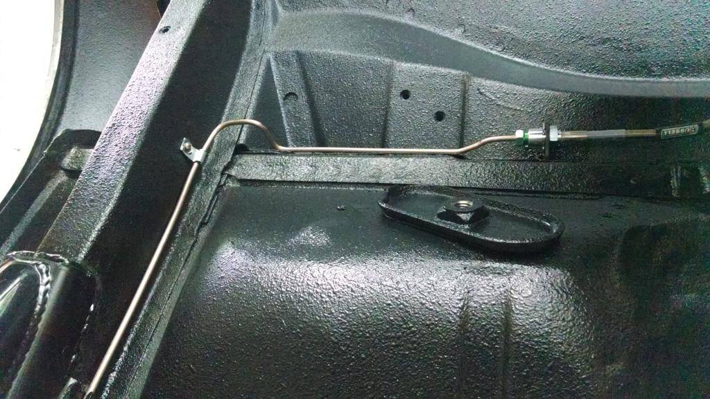

      I finished up running the brake lines for the car, fixed a couple small leaks, and then bled the brakes. I have working brakes! Pretty awesome. Still need to work on the emergency brake cables to adapt the '02 brake cables to the ebrake pedal.

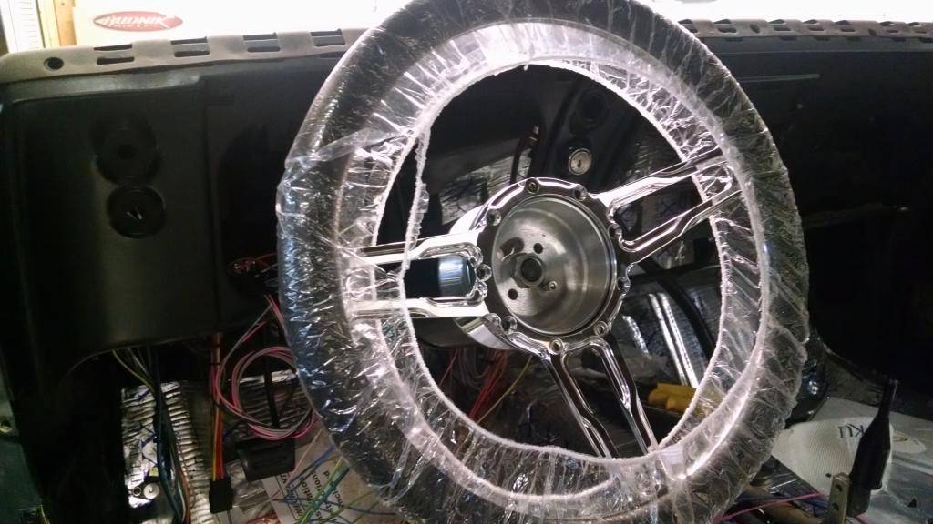

      Santa brought my new steering wheel to match my wheels (Budnik Chicanes). I was up in the air about what steering wheel to run. When I found out Budnik had a matching steering wheel to my wheels, had to have it....lol.

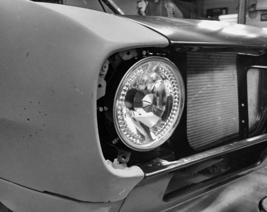

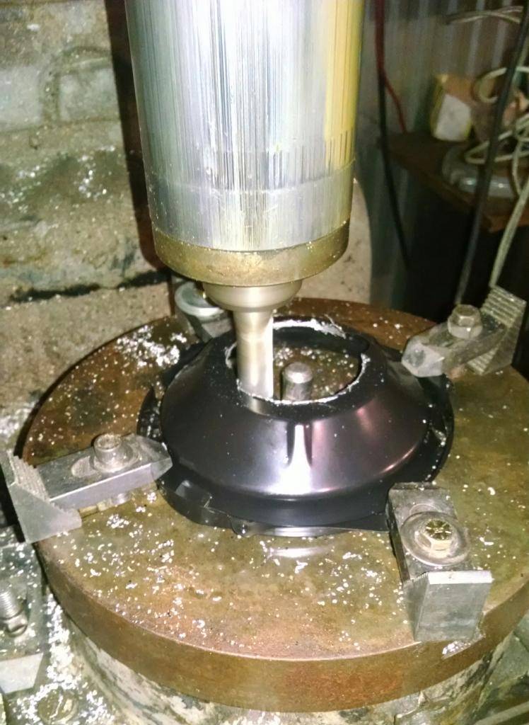

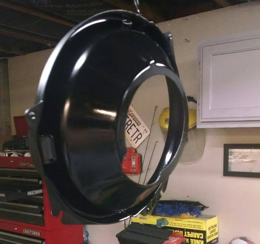

      While still finishing up the AAW harness installation under the hood, I got to thinking about headlights. I didn't really want to run the 7" sealed beam. I wanted something that used todays technology with brighter lights. I "sniped" an ebay auction for some H4 headlight housings with LED's around the outside edge. For just a few bucks, I thought I would see how they look. I received them in and realized the bulk area on the rear of the bucket needed to be clearance to allow the dust cover, and bulb to fit. I used a rotary table on my vertical mill to open up the holes nice and round with a slot for the LED electrical wires and loom to pass through. Although the sheetmetal was thin and peeled up easy, the end result was nice.
      It was worth the gamble, but I'm not sold on the look just yet. I want to install a relay harness and get them wired up to see how they do at night. Here's a test fit (held in by a couple hand tight bolts).

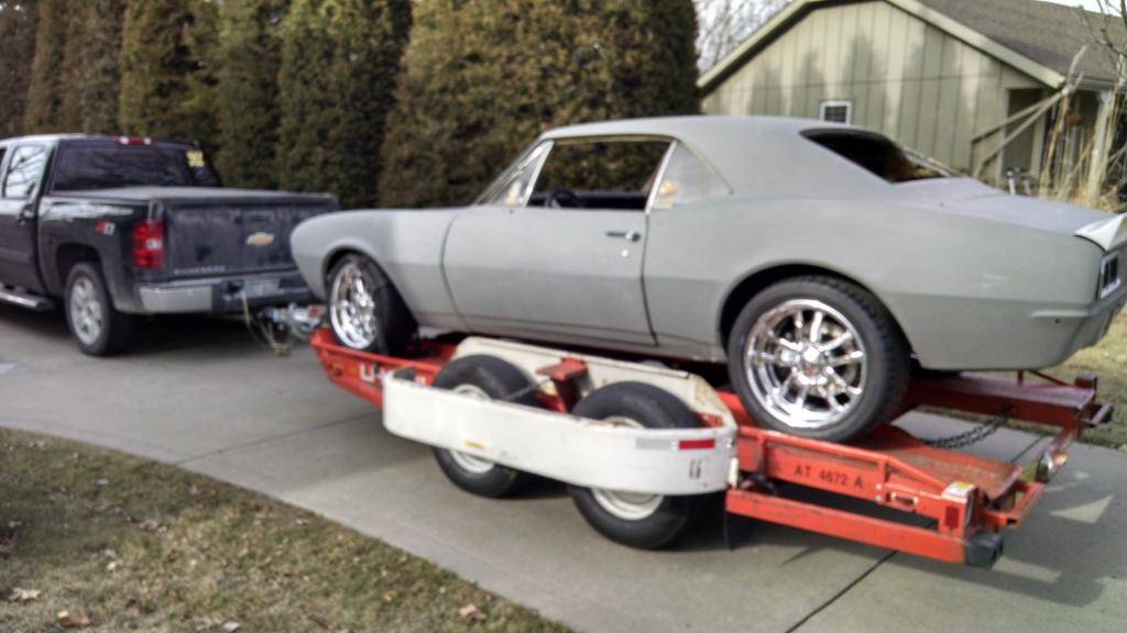

      We had another warm day so I decided to take the car to the inspection station with the title. The car was bought 7+ years ago from Illinois and still has an open title. After a lecture from them on waiting too long to sign the title, they ok'd all the VIN's on the car and gave me their blessing.
