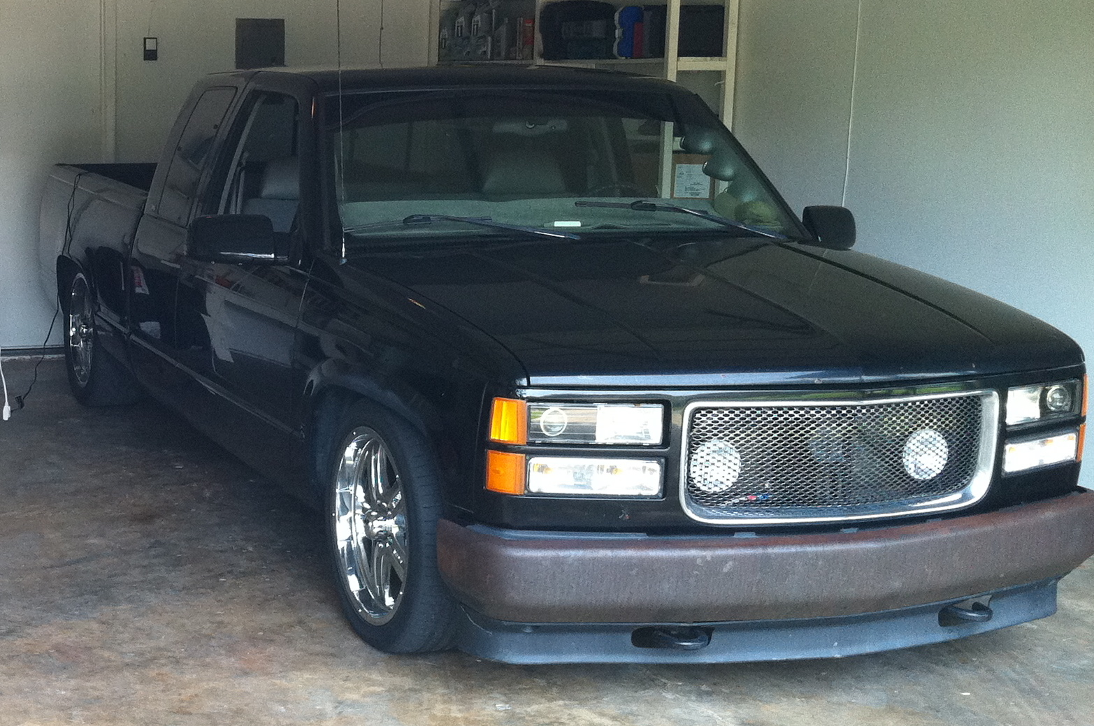

      Well I'm new to the site and new to the pro-touring scene but I've been wrenching for quite a few years and have a few projects under my belt. To introduce myself and how I got here I should start from the beginning so here we go... This was my baby for the past few years and has treated me VERY well. She was a 98 that I picked up for less than $3k and had worked her over pretty good inside and out. She had a LS6 and ran 13.2's steady. I just loved rolling up next to a stock mustang and walking away! Ah the old days....

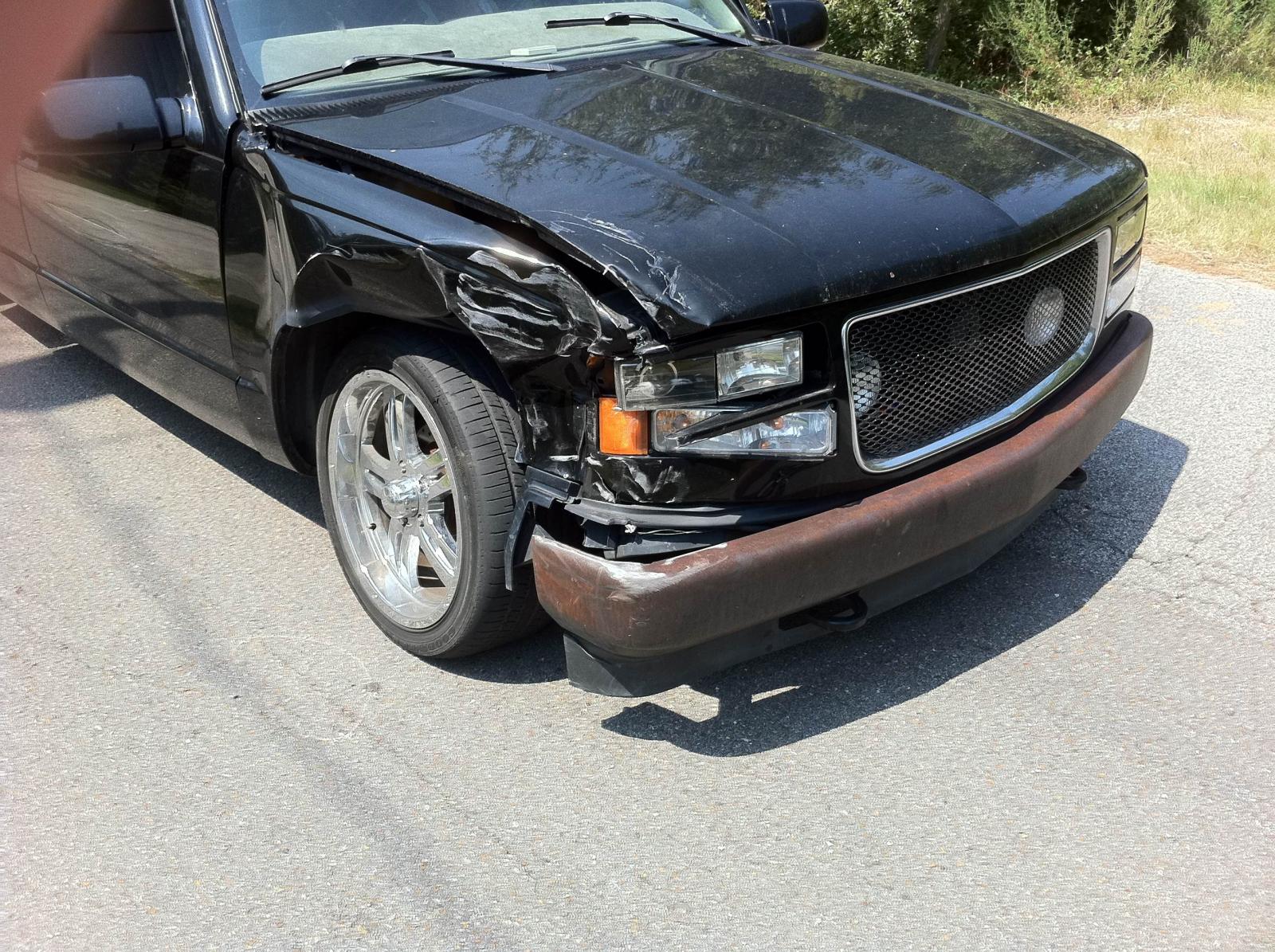

      98's don't have much insurance value and even less when they're not stock so it got totaled and I moved on(after stripping it of course). I guess at some point the cost of building the car is less important to you as the fun it was when it's all complete and think I've hit the realization over the past few years so I decided to jump in head first to a project that I could love even after it's wrecked and something I could actually sell for some good money if that day ever came. So out of the ashes of the ole beloved truck came the new baby to the family! Nov2010

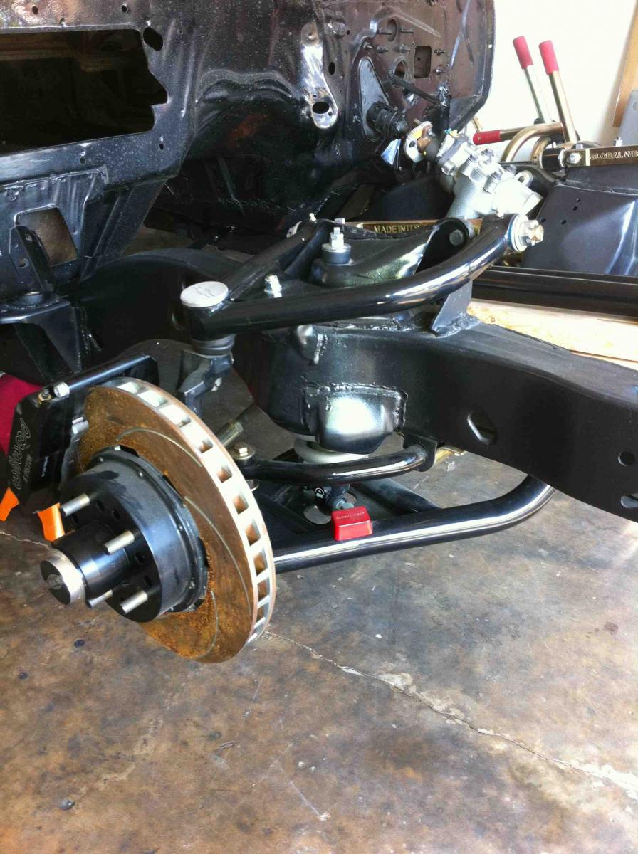

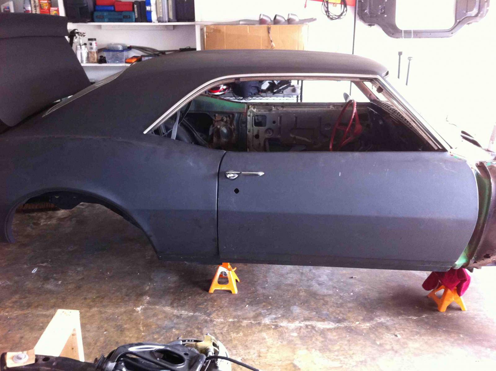

      As promised here is where it stands today. I wasn't all up on taking pics to start so I'm in catch up mode now. 12 hours after getting the car I jumped in and stripped off the front clip. I was mainly looking to see what I had to work with. It had a little rust but nothing really bad and something I'll work with in time. I decide to start from the ground up and yanked the old subframe. I went GW for the entire front end although I didn't take pics in the process here is how it stands now.

      This has been on the car since early Jan11 and you can already see the love of the gulf coast on the rotors. As I said, I replaced the whole front sub, steering, swaybar, coilovers, everything! So if anyone is looking for a complete stock clip w/ discs let me know!

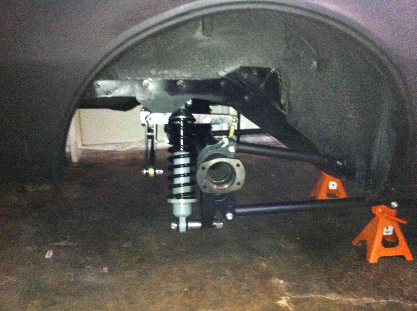

      Next came the rear end and after years of dealing with a leaf rear end and cal-traks(which worked great btw) I decided to go a different route and have something a little more tunable for my driving style. Now keep in mind this is not going to be only a track car. I plan on driving this a lot so I don't want to go all out crazy w/ the build and I'm trying to stay in a budget but I do need to perform to my standards so as you look through the pics don't be surprised if you see one component swap that is over the top and the next is just basic. I'm sure I'll be upgrading in time or as I need it down the road. Case in point, I decided to go the 4-link route but not do the mini-tubs. I'll stick w/ the 275's on the back. I'm kind of partial to the balanced look on all four corners and I don't plan on going over the top under the hood so 275's should be fine.

      My next big buy is rear Wilwoods, third member and wheels/tires. Gotta love tax season! That should finish off the rolling chassis for now and allow me to start working body issues. I can already tell wheels are going to be fun. From what I've read through other posts 275/18's will fit but they need to be really exact on the measurements so hopefully I'll get it right the 1st time! If anyone is running a non mini-tubed Ford 9 rear with 18's all around I'd love to hear specs on the wheels you're running. Also, any reasonably priced source of 5 or 6 spoke rims are always welcome...

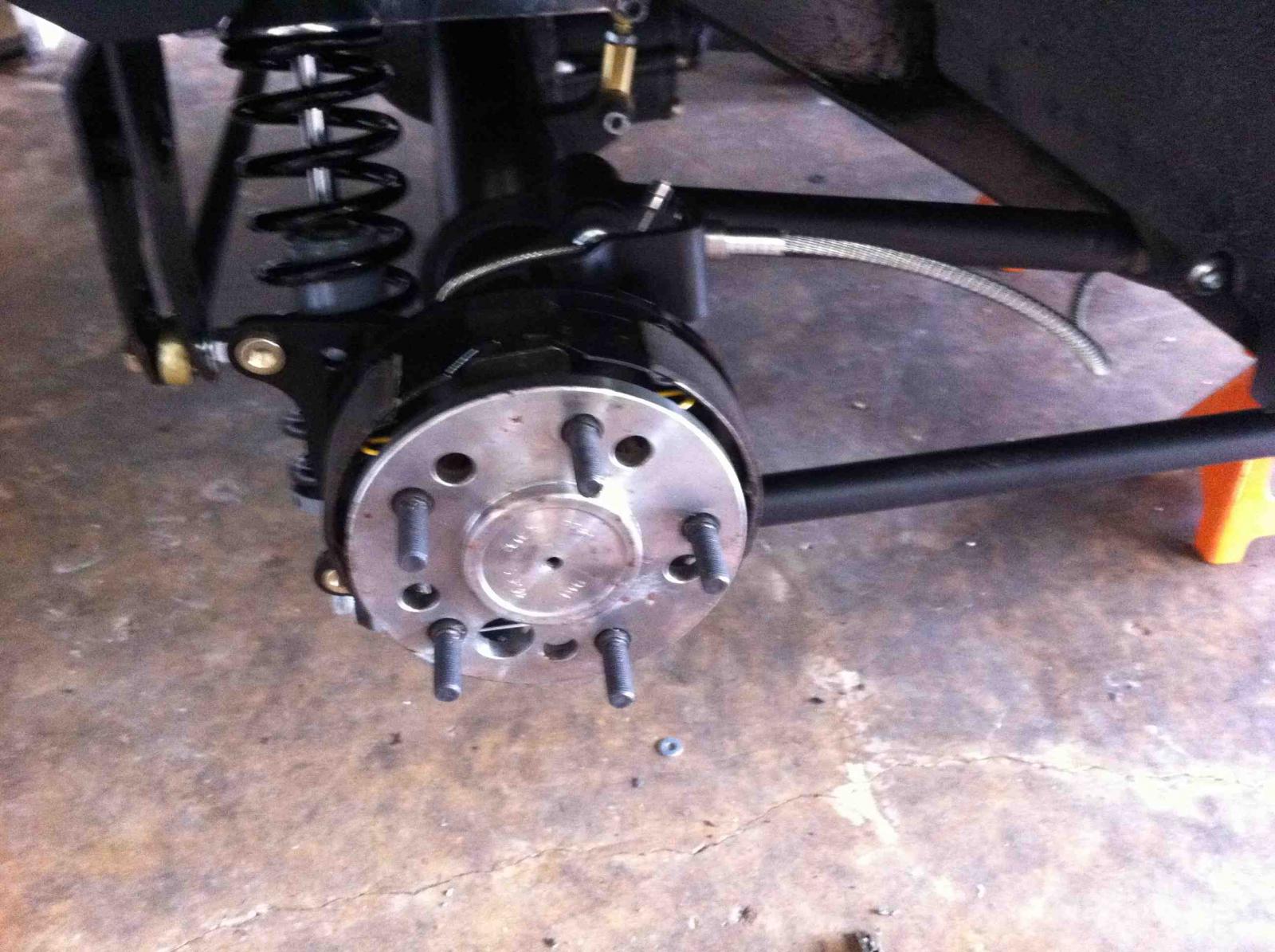

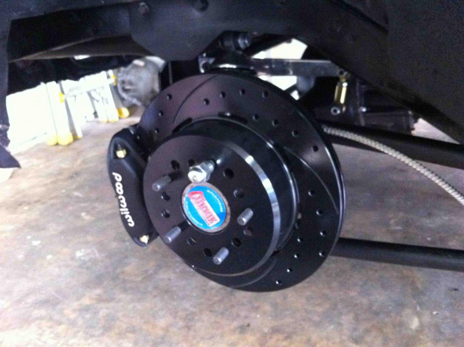

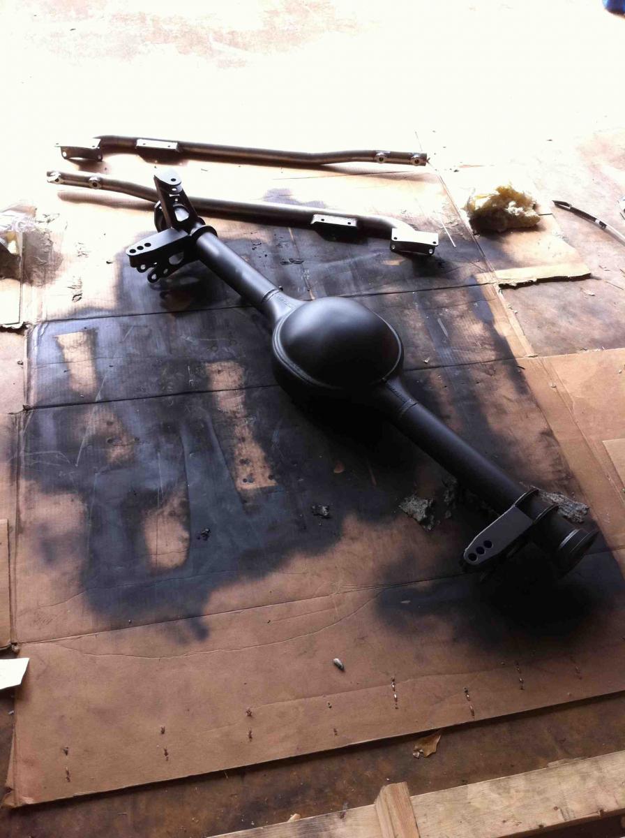

      Well I tackled the rear-end yesterday. I ended up going w/ a 4.10, 1330, detroit locker set in the rear and the Wilwoods for stopping power. I'm still working a bit on the parking cable setup but I have a pretty good plan for moving forward!

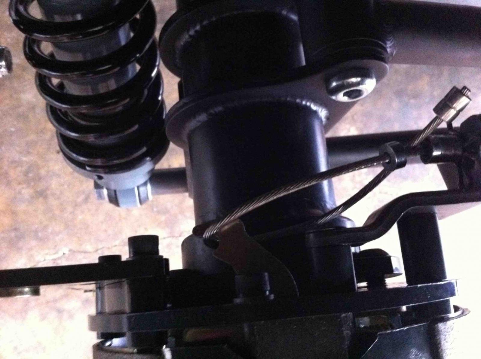

      With everything mocked up I can see that I'll need to do something to keep the p/b cables away from the wheels but until I get the wheels I don't know exact placement so I'll have to hold off on that. As for the cable assemble, after reading about everyones dislike of the hold strength on the lokar setup I wanted to try and stick with the stock setup as much as possible. I ran all factory cables and I am going to try and adapt the rear cables to the Wilwoods. I think I can do this pretty easily with out pulling my hair out to much. By doing a little cut and grinding I was able to use the same factory cable clamps used forward on the car and locked the rear cables in place to the Wilwood brackets. All I have to do now is adjust cable length to the correct size and attach the cable itself to the p/b assembly. This is the only spot I have to stop and think about for a bit. I can think of a few ways but a little trial and error will probably come to play.

      I'm running a moser rear with ford ends. I used the the lokar T-bird parking brake kit with my C5 rear brakes. I kept the factory parking brake pedal assembly and front cable along with the oem curved metal channel that the rear cable goes thru. I used the lokar cables and looped them together with the included junction block. Just slipped it in the curved metal channel and adjusted. Holds very well. Maybe I can catch at cruisin the coast this year..

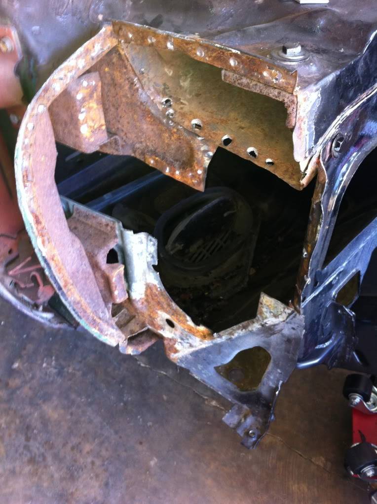

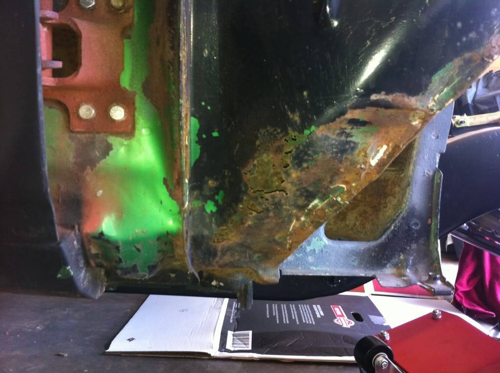

      While I'm waiting on saving for an expensive set of wheels I figured I could tackle my one bad rust spot on the body. Being an easily replaceable part I just drilled out the old and bought the replacement. I just need to weld it in and seal it off and I'll be good. Any old experts have any advice for a newbie sheet metal guy?
      All removed, ready to clean up and weld on the new cowl panel. I was thinking of hitting it with some POR-15 to make sure the surface rust doesn't get any worse. Thoughts?

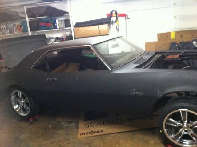

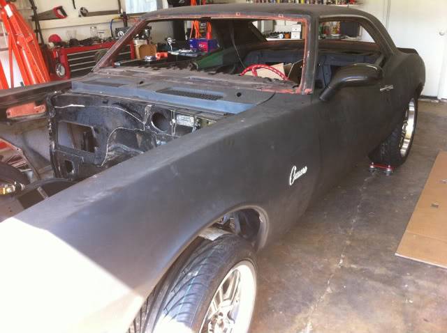

      Some last minute updates.... Threw some wheels on to get it to the body shop..

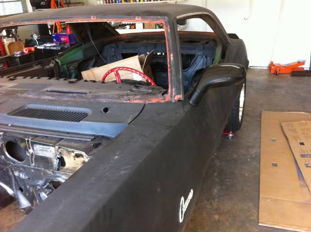

      C6 mirrors on the 68

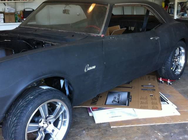

      Body shop means I needed some mirrors so after hours of searching threw the forums and a few posts I decided on the C6 mirrors. I've heard mixed reviews but once they're on I have to say they look GREAT! I thought they might be a little big or not match the body lines but after seeing them on that's not the case! I'm completely happy so they're getting painted!! :D
      Dropped the car off this morning at the shop so the next pictures should be primed and painted shots!!
