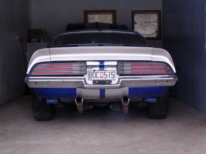

      Hey! Here is my project itīs a Pontiac Firebird T/A from 1970. The drivetrain is a Chevy 454, TH 400 and a 12 bolt rear axle. It had been "customized" with taillights from a newer Firebird, if it had the original rear panel I had kept it. Now when it was destroyed in the rear I decided to build my own version of the rear panel. I looked at the Firebird from 69 and got inspired to use that theme on the rear of my T/A.
      I will continue to post pics of this project.
      Over and out from Sweden.
      Here is the rear before I cut it off.

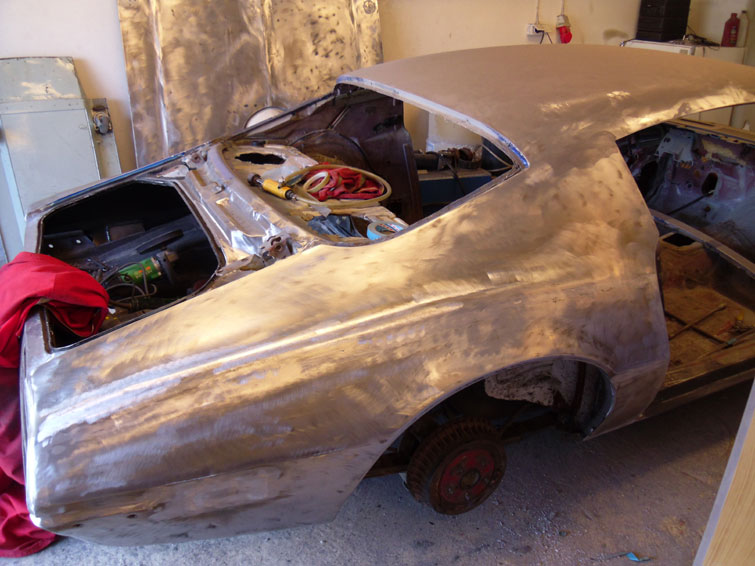

      Yesterday I did some work, I sealed all the weldings on the quarter panels with lead. I dont now what you call it in the U.S.A, you use lead as a filler. Maybe someone can tell me the right word for it, itīs not easy to write in English especially when it is technical words.

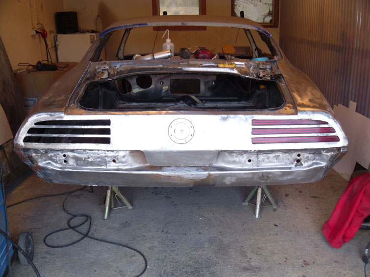

      Now I have started with the connection between the fuel cap and the fueltank. I had to make a little hatch so I can connect the hose later in the process. I will tigwelding the aluminum tube to the fuel cap at my job later this week.

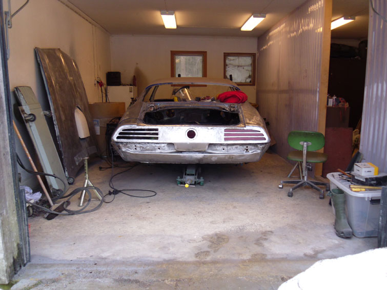

      Today I have started with inside of the trunk, I grinding it down to bare metal and itīs boring. I did a "mock up" of the rear to get inspired, this is how itīs gonna look.

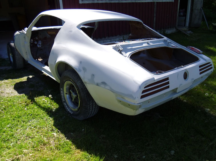

      Hello! Her come a update from Sweden. My project is going on and now itīs a lot of grinding, I have paint the car with epoxiprimer before the filler. The epoxiprimer is a very good protection for the metal against rust and I will spray another layer with it before the surf.
      Over and out!
