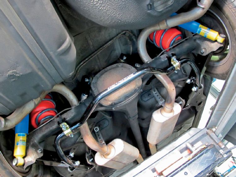

      i'm looking at this picture and it got me thinking, do all the rear anti sway bars have U bolts on the rear axle, the reason i ask is i have a 74 A body with a Chassis Works Fab 9 with back brace and i'm going to be looking for some sway bars here in the near future.
