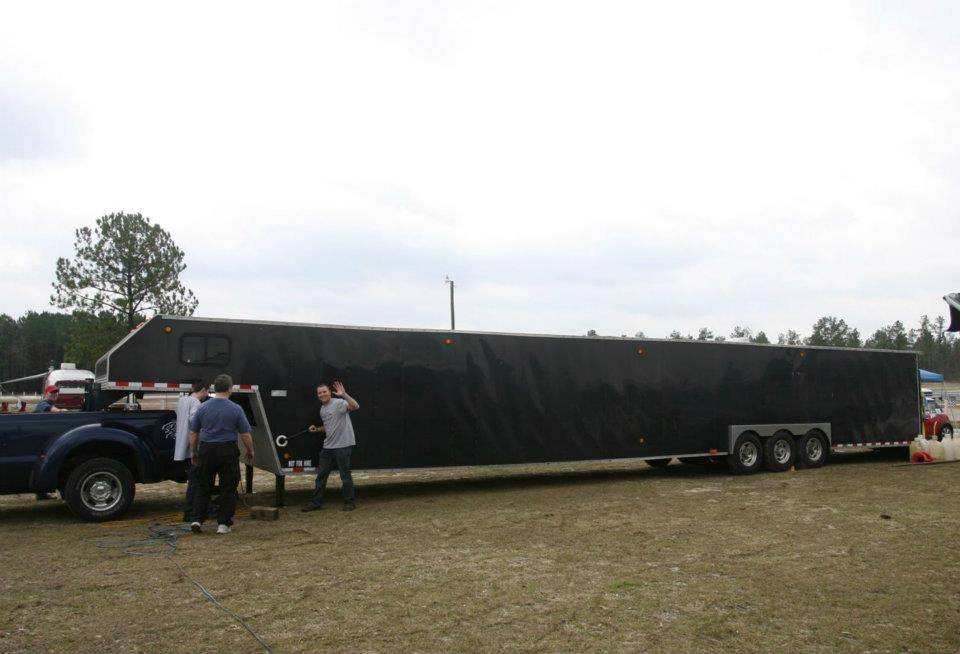

      Come on guys, think big!
      (Courtesy LeMons)

      Damn, that is one big arse trailer. I would hate to tow that around. That has got to be more than a F350 is rated for.

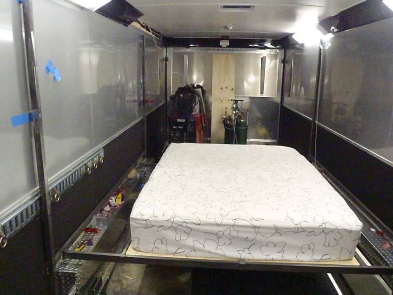

      The thing I like the most is being able to stay in it at the track. I built this bed lift last summer so we could sleep in the trailer. It has A/C and a Honda 3500 inverter.

      The bed lift is a great idea! Does it raise up and down, or did you weld it in a static spot?

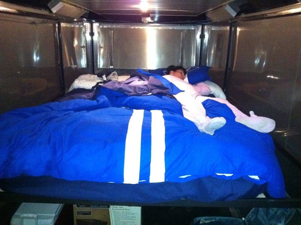

      I bought an ATV winch for $50 from HB and have it on some pulleys just like a car lift.
      Here it is up.
      When it is up I pin each leg so there is no weight on the cables when traveling. I also have pin spots about half way down so that I can lower just above the motor in my tbucket allowing me to have the car in the trailer and still sleep in it. When the trailer is empty it goes right down to the wheel wells.

      Yes I wanted an 8' wall but 7.5' is about standard without a special order. I wanted head room when I bought it and I can walk under my bed when it is up. There is still about 3" more clearance but that is as high as I can get the bed with the cable design I have. I need to tweak it some this summer and I will have to fix that.

      that's an awesome idea, and very well executed! I kept thinking about needing extra space at the front, never considered going up. And that frame work would be well outside the area of the car, so seems like a no brainer. I guess the only problem would be if you had the car in the trailer, the bed just above the car, and during the middle of the night forget how high up you are should you decide to get out of the bed :-)

      It's just like sleeping on the top bunk...lol
