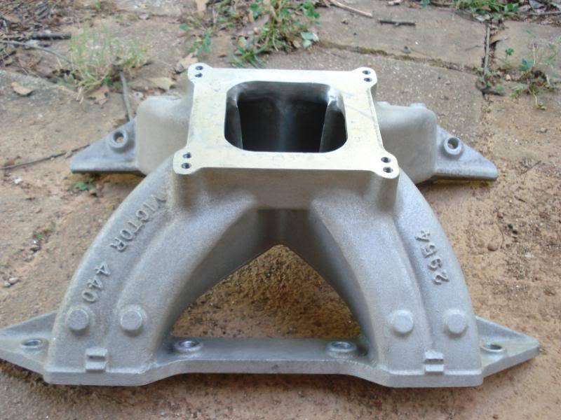

      Eddy's Victor intake

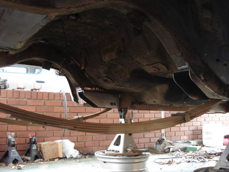

      And some leaf spring relocation kit from Mancini that in a future will serve as a lower link bracket on a custom unequal 4 link coil over system i will fabricate for it. by the way not finished yet, my welder run out of shielding gas :(

      I finish with both sides of the spring relocation kit installation pretty straight forward, so far i like what i see, i may convert the rear suspension to a 4-link set up and use the front spring perch as a front lower link perch it should be awesome!
